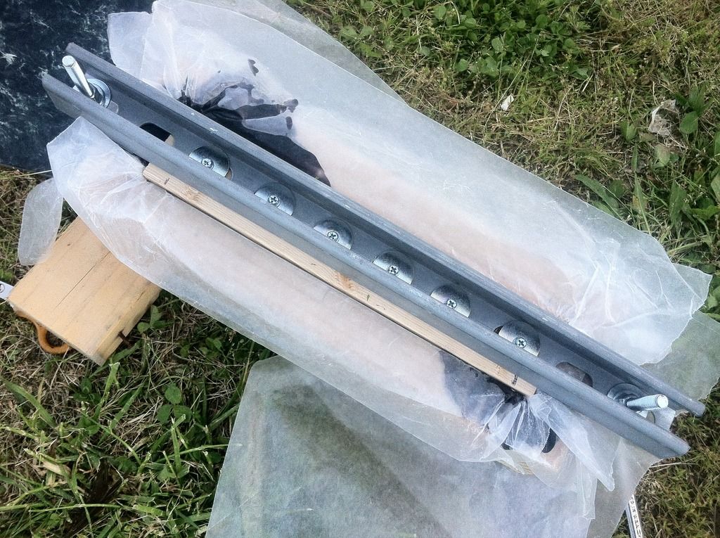

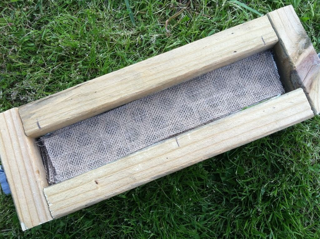

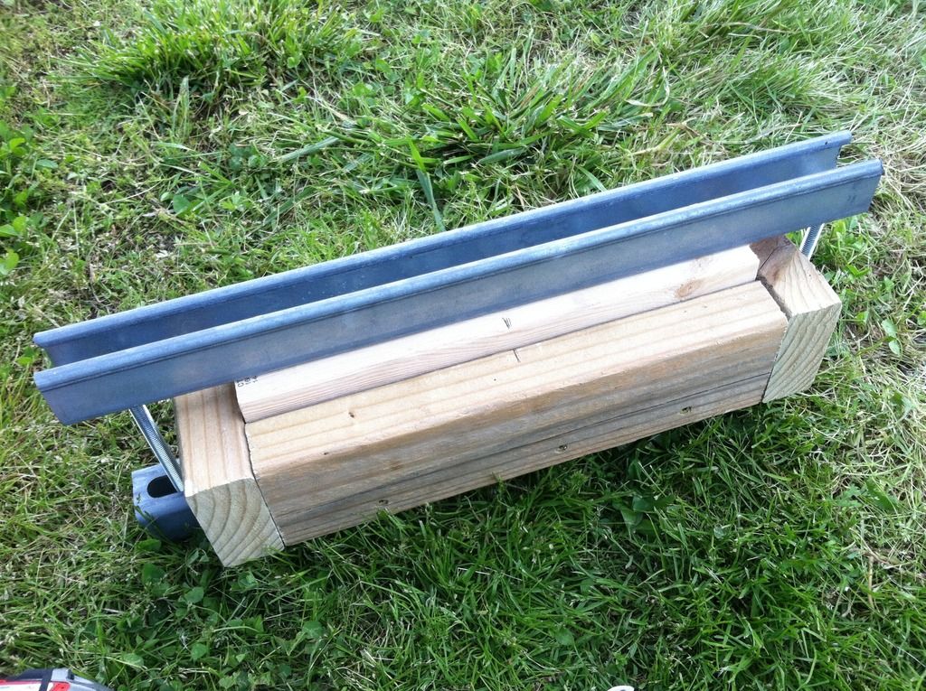

Built my first micarta press. It's 2.5x13. It's set up for burlap ribbon which is 2.5" wide and 15' long cut into 15 12" parts. I added 7 parts from a 2nd roll for a total of 22 pieces. This should end up being about 1/2" thick and each run will make one set of large BK scales or whatever else, haven't mathed all that up yet.
I may have an issue with it being too exact fit once the wax paper gets involved. We'll see, I'm doing a run regardless of that suspicion.

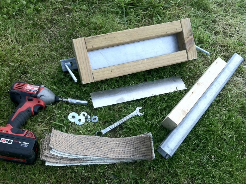

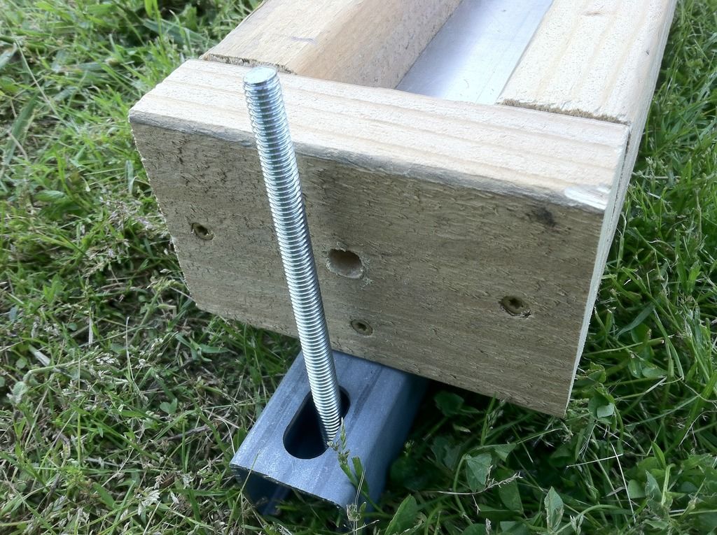

Found this aluminum hangin around that I forgot I had. Perfect for a top and bottom to keep it smooth and flat. I wasn't sure about pressure relief and where it would go. I didn't want anything coming up and clogging the top so I added a weep hole on each end. I used unistrut channel and 3/8 bolts for the press. My impact driver and a deep socket should do the trick
A dry test worked out as planned. Hope to get the first batch going tomorrow. It's windy and crappy outside tonight and I'm beat. I hope this comes out nice.

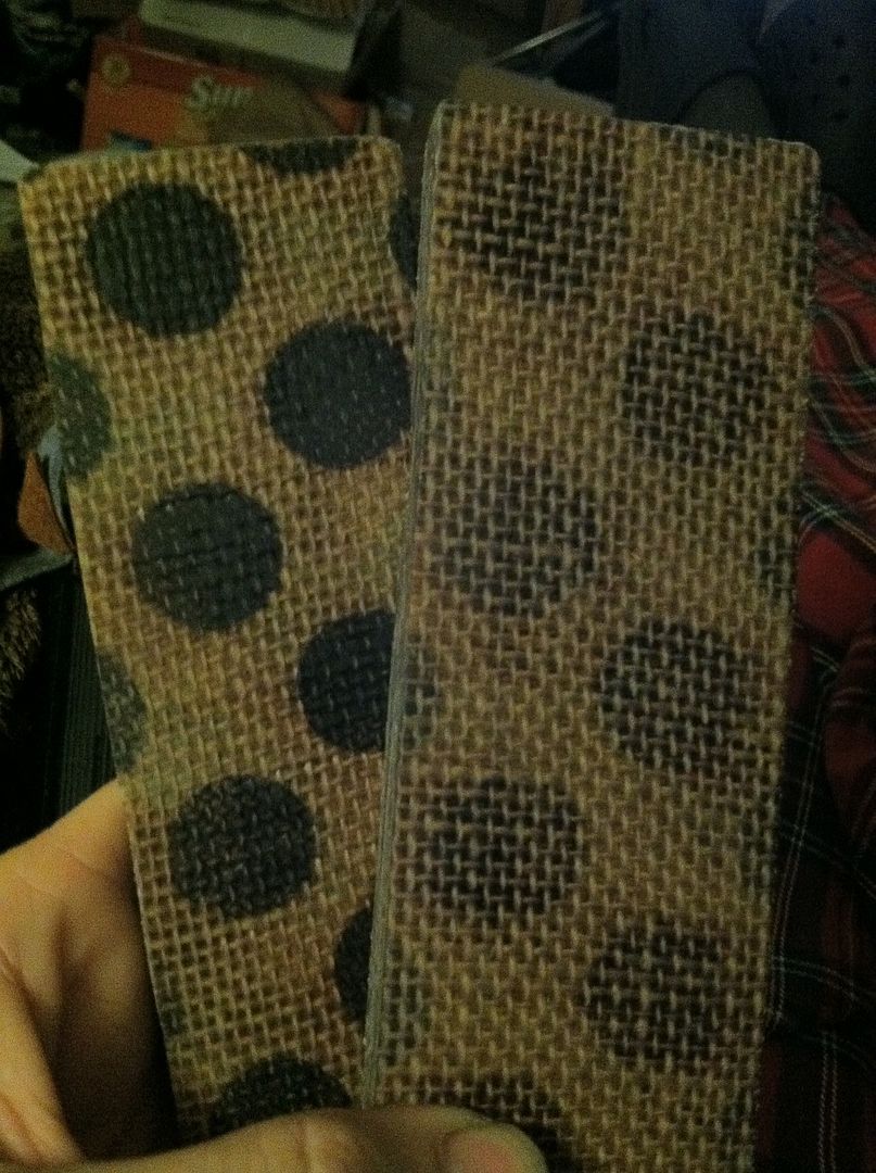

Got a batch brewin. Looks like the ink from the dots bled into the epoxy. Ok with me. I layered every third with white burlap. A little messy. Most of what you see is between the paper. A little got on the wood but I scraped it off just now and it's like jelly so it came off easy. One weep hole did its job. I ended up cutting 1/4" off every layer. Glad I did, everything fit real nice. If it turns out I'll post more about the process. Pretty standard tho.

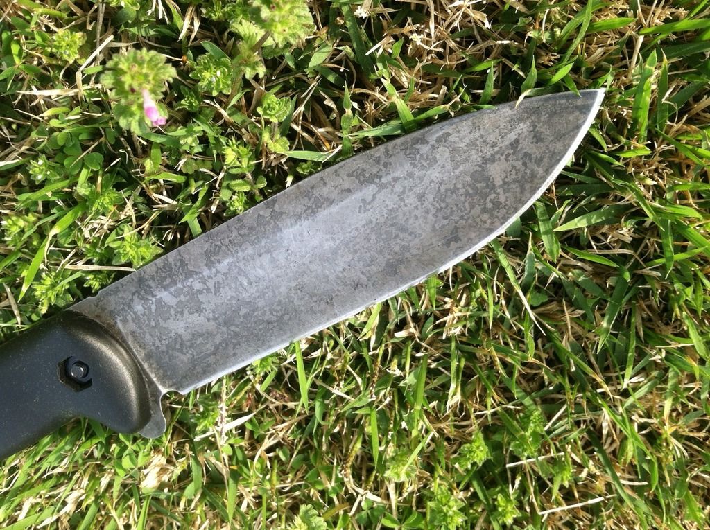

Yeah, it really is, but I wanna make a firesteel for it. Can't make up my mind if I like the patina either, haha. It's the mottled look, kinda like on your 12, but I can't make up my mind if I want to remove it, and try again.
Heard that man. I get the same way that's why I did a second mustard on top before deciding to take it off and then I was satisfied.

I did a few layers. I like it for the most part, but there's one place that looks too smooth, or blurred, than mottled. That's the part I'm not crazy about.

I had the same thing! That one spot. Just something about the steel there. Even after the vinegar I gave it a good baking soda scrub, dried, alcohol, vinegar, repeat then even the mustard barely covered it up. I try not to look there. Prob only I can see it until I point it out. Thought I was crazy. Well...thought it was just me...
Can you spot the place where 2+ hrs of vinegar and 2 mustard treats wouldn't take? Haha easy enough now that you know.

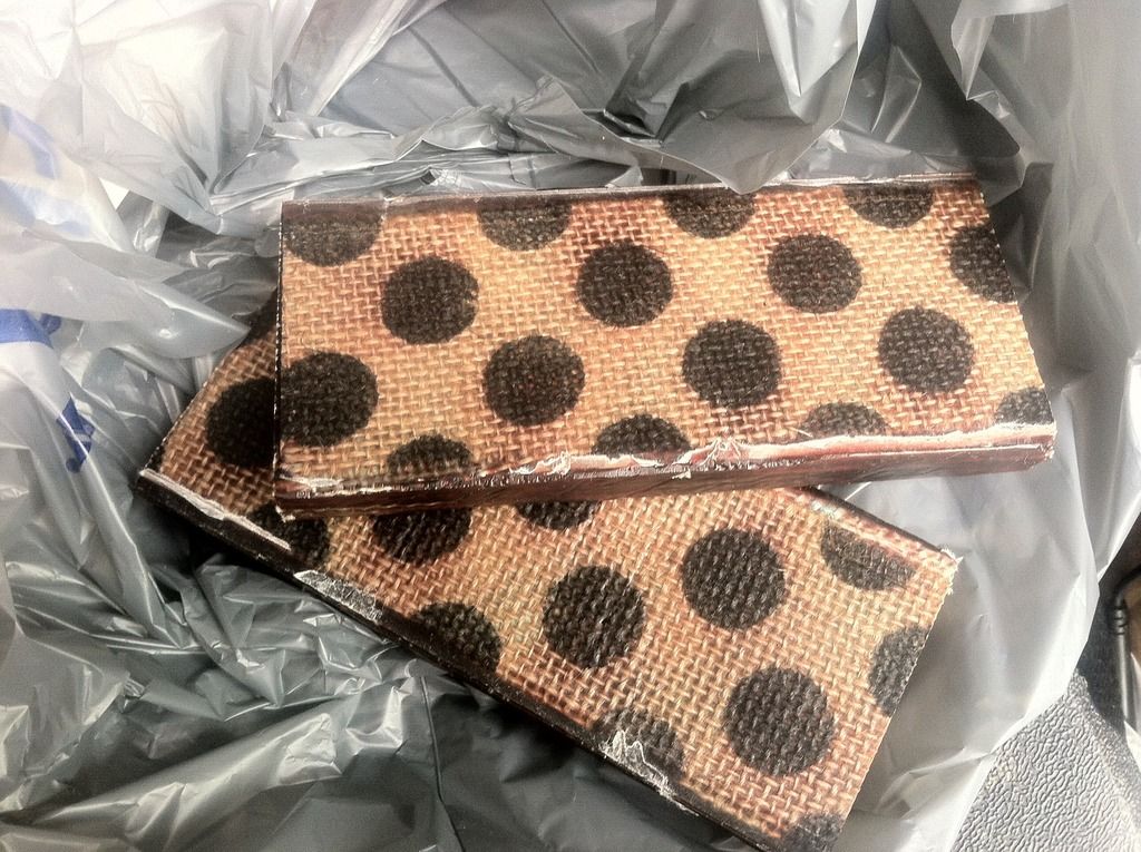

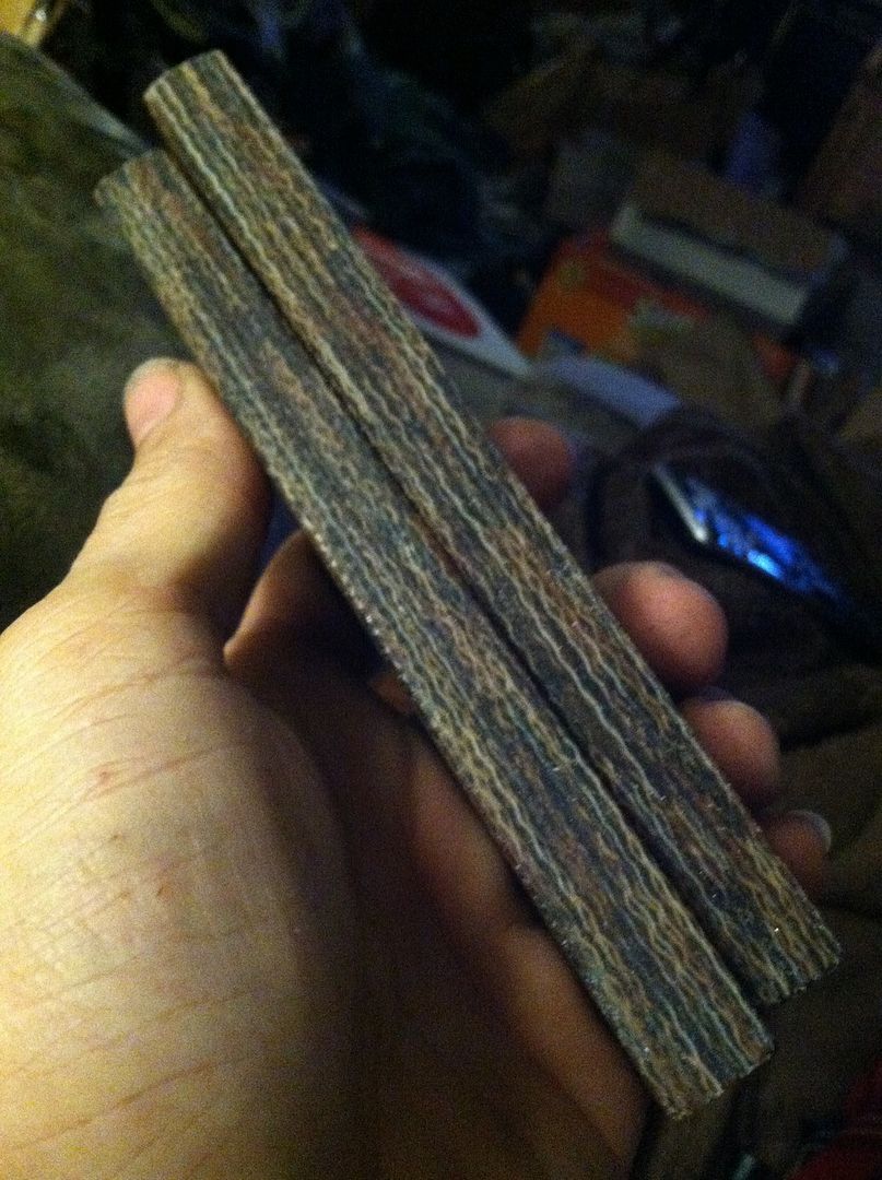

It turned out pretty darned good I think. I was able to get 2 5-3/4"x2"x1/2". Perfect for large beckers! Tweeners will work too of course with room to spare. Now I'm anxious to grind in and see how the layers look.

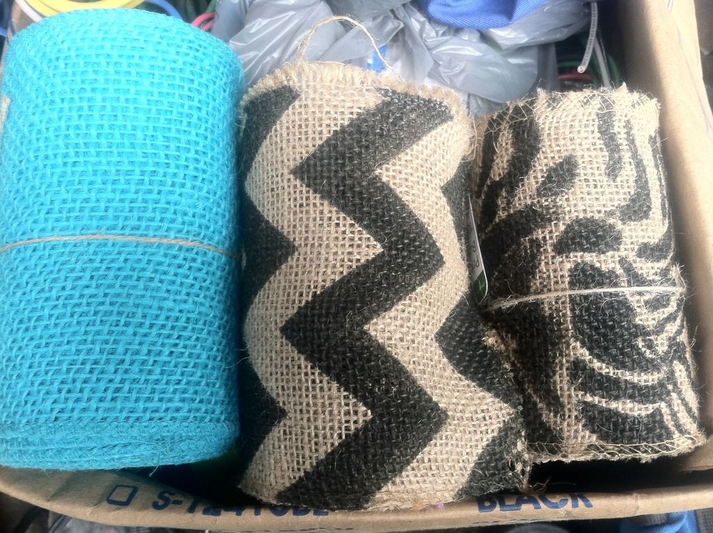

Scored some more interesting burlap at Walmart. Total five bucks!
5"x15', that's enough to make 4 more sets! I have another ready from the other set so I'll have 5 more to do after the gathering. Then I'll start cutting and grinding.
