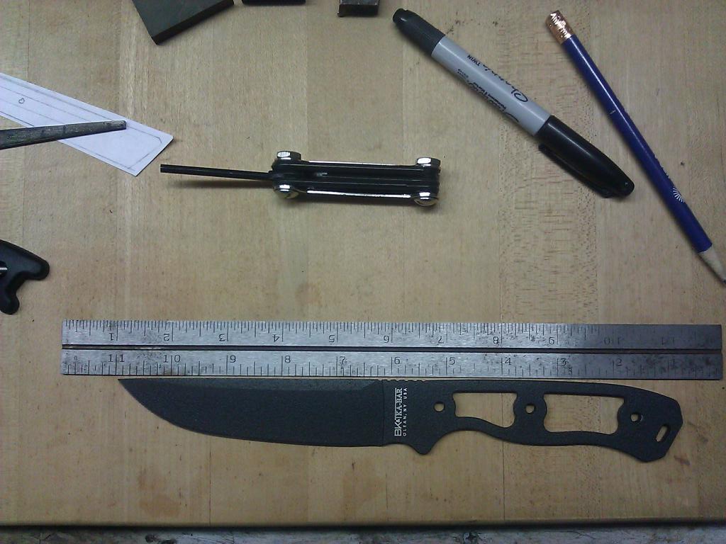

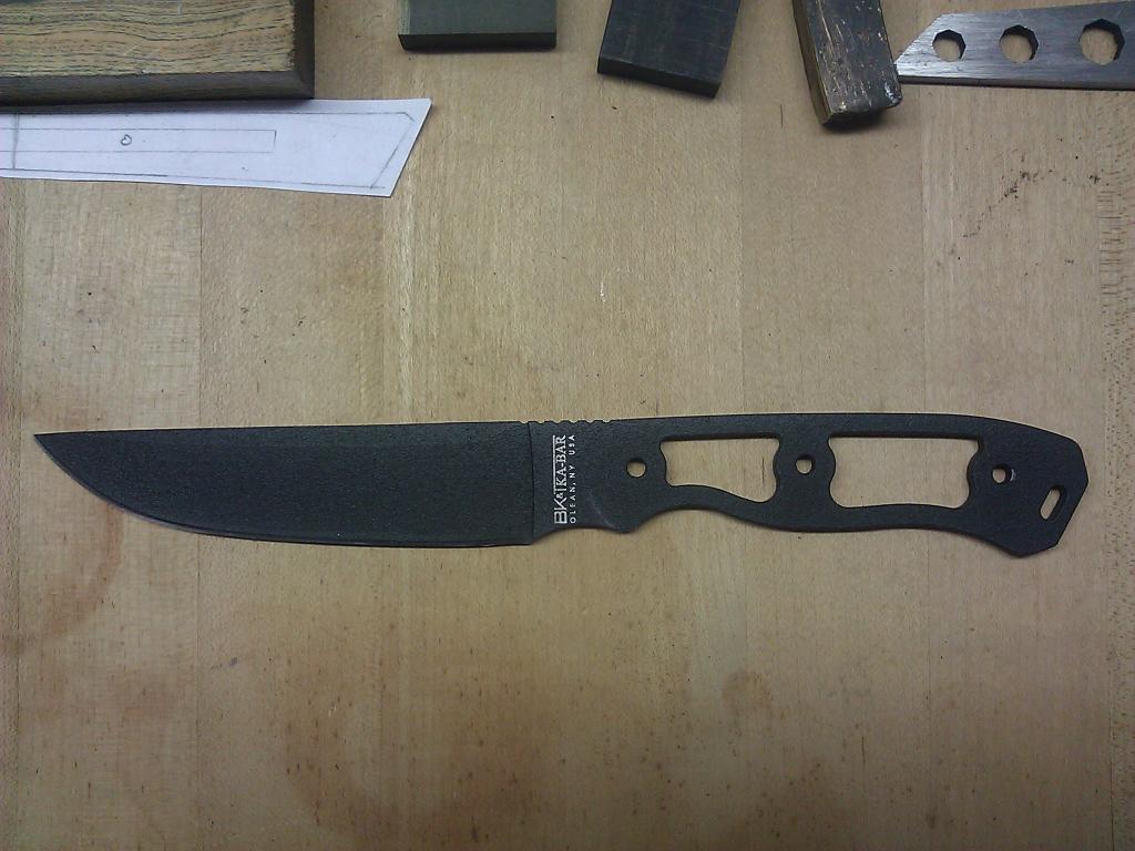

A while back in the "What did you do with your Becker today" thread, I posted that, while bored waiting on a well repairman, I threw one of my 9s at a stump. I readily admitted in the post that throwing such a high Rc treat knife was bad, many others agreed as did Ethan, who also admitted to throwing 4s back in the day.
BUT... the 9 actually flew pretty good for 1/2 spin and 1 spin, o what does an enterprising individual do?
Well, he goes out and learns how to use CorelDraw to design some throwing knives that vaguely resemble a 9, then he learns how to convert said CD files to FlowCut software to set up using a FlowJet waterjet unit to knock out some prototypes.
Here's the WJ set up ready to go after a non-cutting test pass to make sure I had everything set up correctly - didn't want to screw up a $300K machine.
Here's the 9 blades cut out but still on the cutting bed.
And here's the first 3 prototypes roughly based on a BK9.
Some basic grinding has been done on the edges, but all I have are hand files and grinding wheels, no belt grinder.
The 2 sets on the right are very similar to a 9, the left most set resembles a 9 only in length.

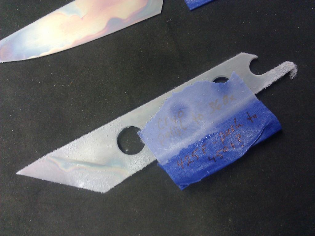

What does CPM-154 look like coming out of cryo?
a lot like this :D :

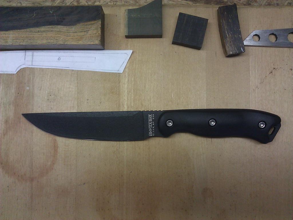

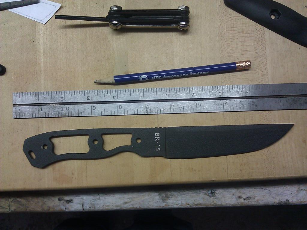

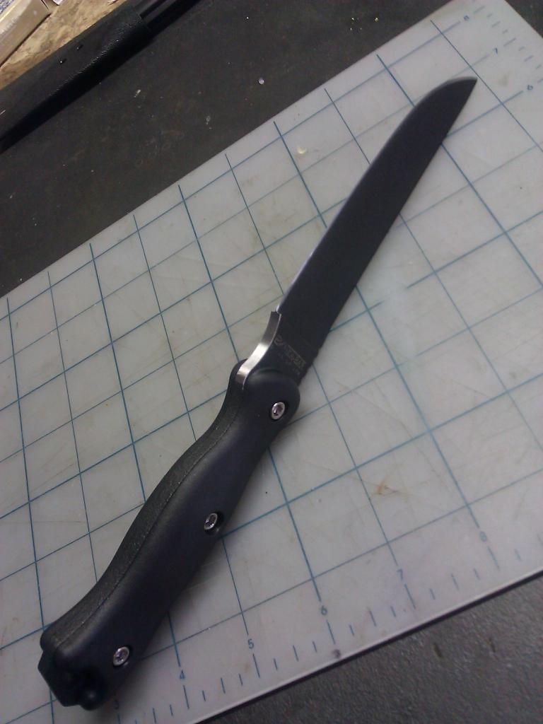

Also, I modified my 15 to address two issues I had with it:
1) I want it to be more board-friendly, so I ground off the guard and lengthened the choil
2) I just can't abide a trailing point, it turns out, so I straightened the spine, which made the tip more accessible
3) Forgot to krylon the peanutbutter scales to orange... next time.
4) Forgot to pick up some decent paint stripper to clean the blade.
visually, I think the ricasso looks too long without the guard, but the function is improved overall.
