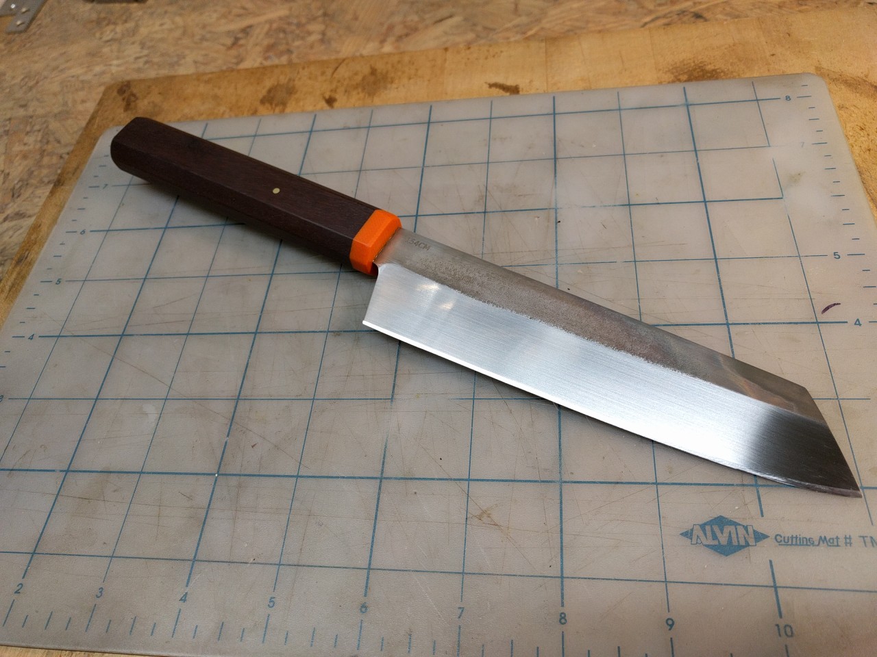

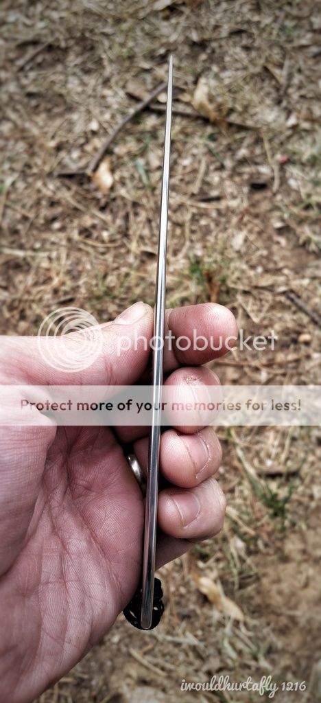

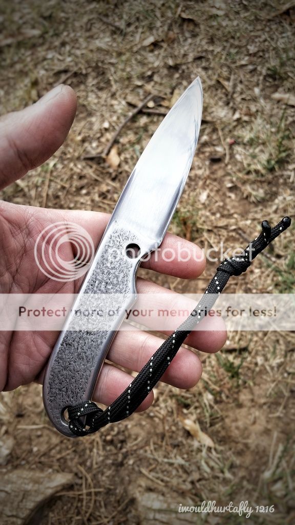

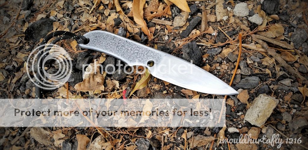

Finished up a quick thanksgiving weekend project. Wanted to do something quick and simple for my last scrap of 1095. So it's 1/8" edge quenched 1095. 6 and 3/4" overall with a 3" blade. The blade is a full convex grind, with the spine being ground back convex as well. The knife has a full distal taper and a blended plunge line. All edges have been rounded, and I added a bit of faux forge texture to the handle.
Since the blade is differentially hardened it does have a quench line but I opted for a satin polish instead of etching. Overall just wanted to experiment and play a bit.
Super fun! Love the crowned spine.
I like it....looks very slicey.
Thank you, figured without handle scales it better cut easily lol.
Thank you daiz, sharpened/90 degree spines have their place, but I really like the comfort aspect of a rounded spine. Plus this one I ground back in hopes of improving cutting performance, like a convex blended swedge I guess lol. Didn't want any hard lines.

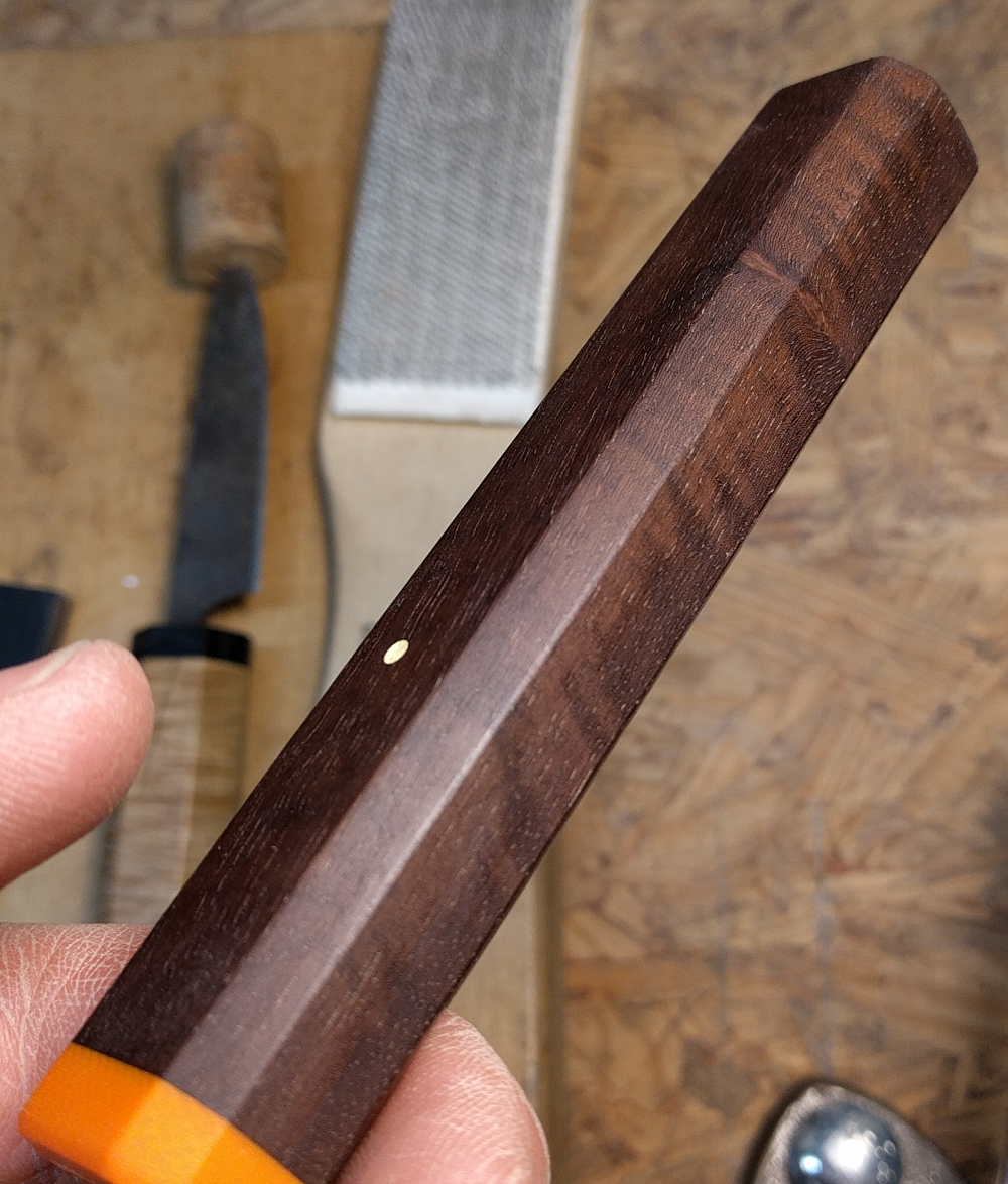

Here's a close-up of GSOM's wood (yes, it has been hand-rubbed):
I think your intuition was spot on. Damn.
So, one question - perhaps you've already answered this, but I am too lazy to look atm - what do you use for a finish? Good waterproofness? I gotta get away from the wipe-on poly; it's fine functionally and looks ok, but doesn't seem to do justice to the darker woods. Plus, I'd like to find something that makes the - chatoyance - pop, without the plasticky look.
I really need to stop working so much and get back to making stuff. I think I still have another couple board-feet of that Katalox - as well as a small mountain of other wood.
This katalox is good stuff. It's denser than oak, twice as hard, and MUCH more so than walnut, which is my other dark wood alternative.
I've been finishing natural woods with several coats of BLO and then a toluene-free furniture wax ("Classic Wax"). I'm experimenting with sno-seal on one piece, which is better than turtle wax (don't try that).
I like the shiny surface that Tru-oil gives you sometimes, but some woods just don't take it well. Ebony, for example. ugh. The nice thing about that shiny surface is that it's grippier somehow.
