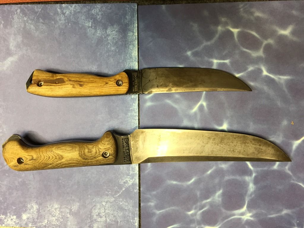

I made the above scales myself out of a neighbor's fallen elm tree. Handle on that trade knife looks slightly easier to shape - except it appears to be hidden-tang.
It's also epoxied and pinned. That can be done, too:
These were stabilized buckeye - hence the different finish.
All depends on your skill level, tools, and willingness to spend the time.
If you're looking to buy some pre-made scales and attach them using alternate screws, it's easy enough to do. May need to enlarge the counterbore if your chosen fasteners have a larger head.
And make sure the body doesn't exceed the size of the holes in the tang. I think it's 3/16" but you'll want to measure specifically on your knife. It's a fairly easy thing to drill larger holes in wood. Not so much in hardened steel. (Not that it can't be done, but your cordless drill and lying-around HSS bits aren't going to cut it.)

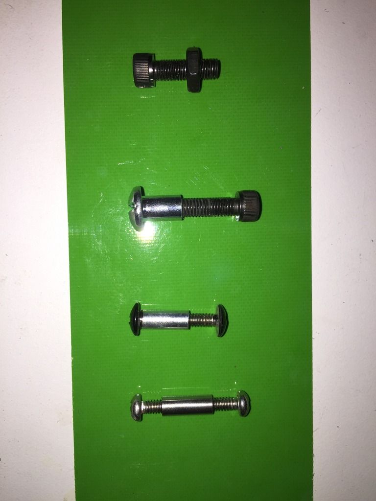

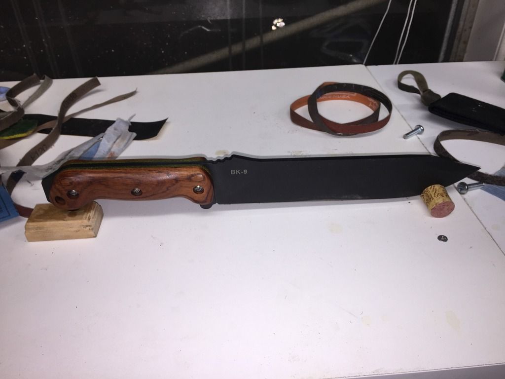

On the top are the black Ka-Bar supplied #10 socket-head bolt and hex nut.
Next is the #10 bolt in a chicago screw.
After that is the #6 barrel bolt and screw provided by TommyTheWho.
On the bottom are the 3/16" pivot barrel and 6-32 stainless button-head philips screws I went with in the end.
I bought screws in 3/8 and 1/2" in black and SS, with button and round heads. There are even more colors, heads and drive types available.

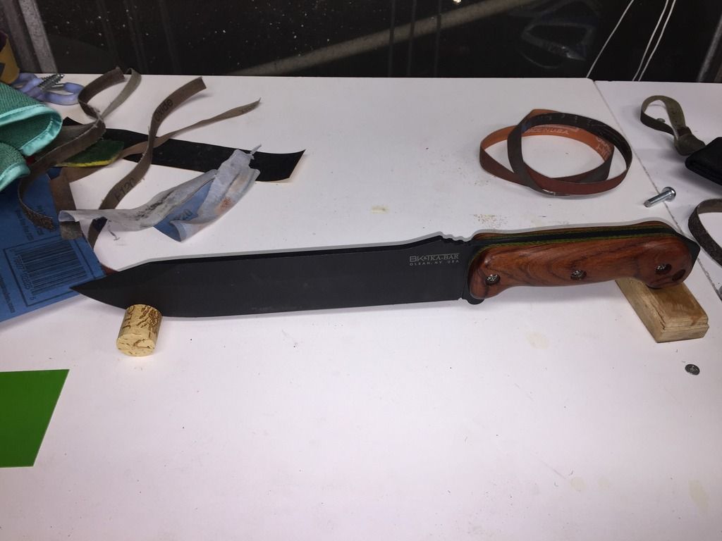

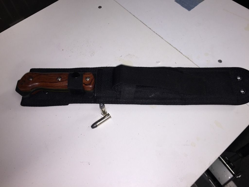

Here's the 9, all finished up and dressed for work:
With the rain, it probably won't get a workout this weekend.
Nice job on that Niner, TJ. Bold move trimming those scales - but I like how they turned out. I prolly couldn't fit my hand around it.....

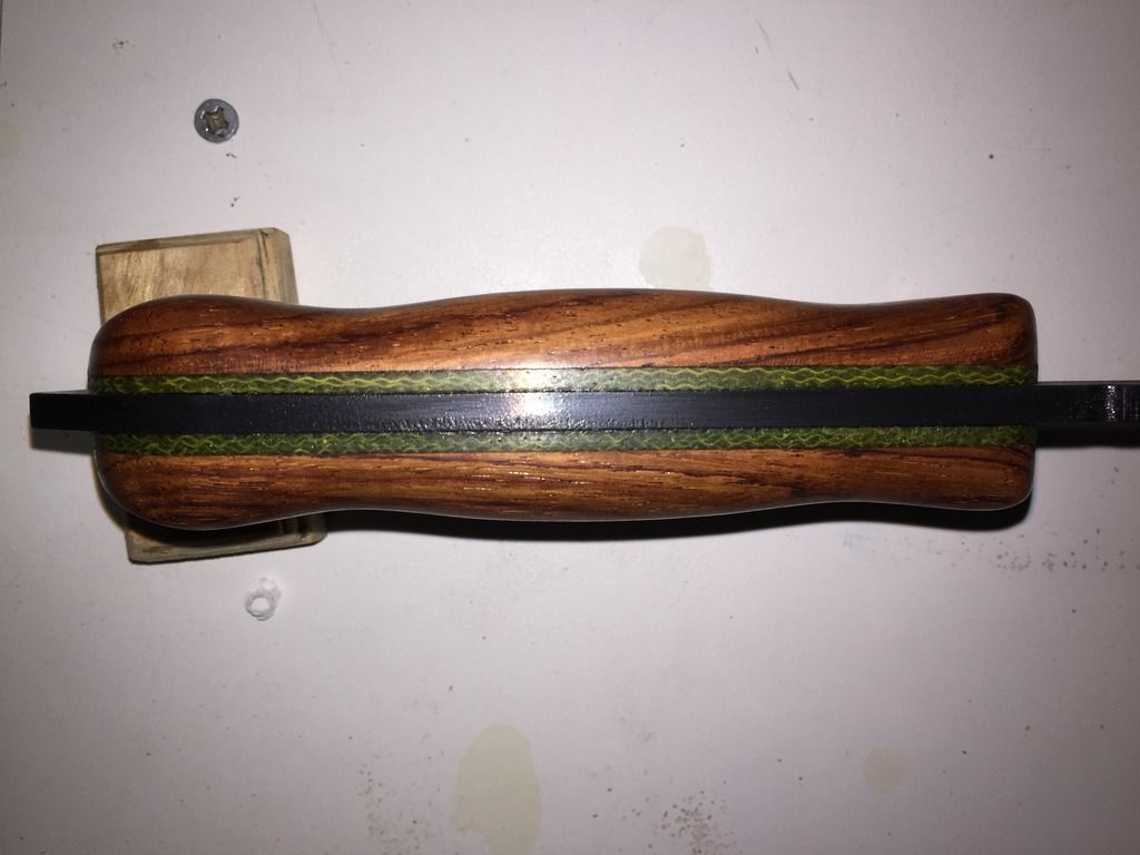

WOOD! I am a big fan of it. Especially if you're just starting out with mods - even the really hard species aren't that difficult to shape, most of it isn't toxic....and it doesn't require a huge investment in tools or materials. Plus, IMO it looks great. The BK-11 mod is zebrawood and the 15 is wearing katalox with maple "liners". Made the 11 sheath myself; I was gifted the 15 sheath by our very own NixCustoms. His is WAY better. If you have a local hardwoods place, there are usually bargains galore to be found in the cutoffs bin - and most of it is perfect for knife scales. I've found some super cool figured/exotics for dirt cheap - too small for woodworkers or turners, but still good for a few sets (or more) of scales. I've even had leftovers to gift to friends......
