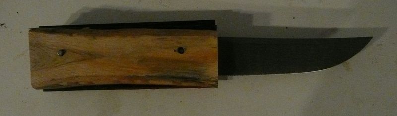

Had to take a look at these on the big screen (I'm too old to view pics on my phone...) and they look good au naturel. I like the pronounced grain pattern. Looks a lot like ash. Even a clear finish will accentuate the darker parts. SFSG!

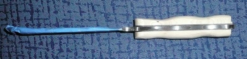

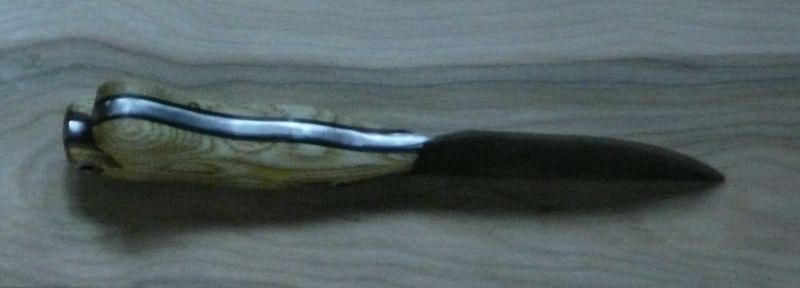

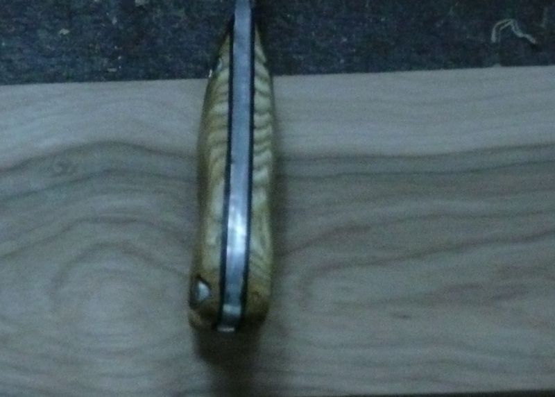

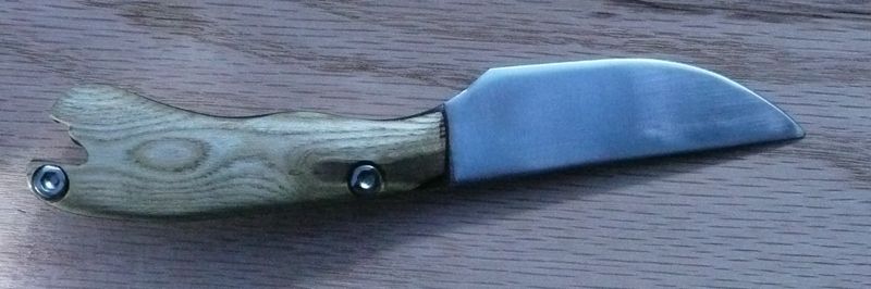

Scales belt-sanded in alternating progression to 6000 grit, then hand-sanded similarly to 2000. Burnished with denim. Cleaned with mineral spirits and denatured alcohol.
I'm no good at keeping secrets. Finish is 3 parts turpentine, 1part mushy beeswax/mineral oil mix, 1 spar urethane, 2 BLO and 1 tung oil.
Buffed the first 2 applications with 1000 and wiped with terry; final application was wiped lightly then buffed with denim.
It's still a tad wet here, but you'll get the idea.
Sorry about the grainy photos. I set up my light box, and it seemed plenty bright, but I guess the camera was a little too far from the subject or something.

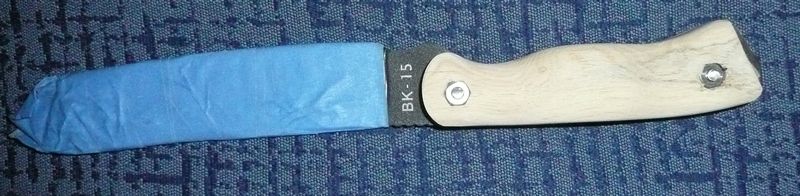

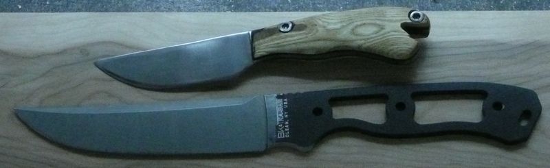

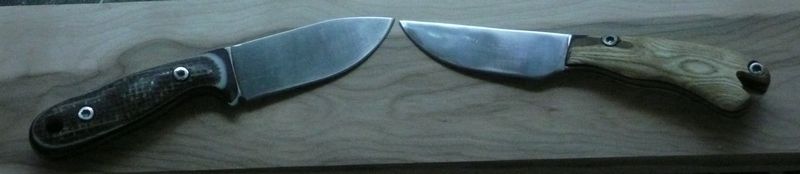

Profiled an 11 to complement a 15. I give you "The BK151":

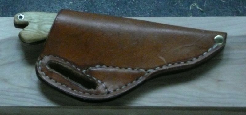

Fits like a glove in the sheath Psyop made for my 24:
Here it is with said 24, to show how much the blade changed:
The scales:
The other angles:

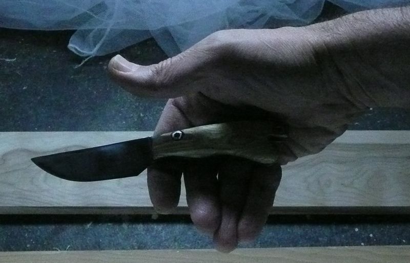

Fits my hand better than stock:
And like my wife said, handles as smooth as a baby's bottom. Shaves hair, too, but no picture of that tonight.
I hope you enjoy it.
I'll try to get some more shots when I finish up the 15 scales and do something to protect the steel.
Comments / Compliments / Constructive Criticism are welcome.
Thanks for looking.
- Tom
That looks awesome, Tom. Clear finish on the "neighborhood tree" just kills it. The natural grain really pops, and I like the new blade (and handle) profile a LOT! Kudos (whatever the hell they are)!

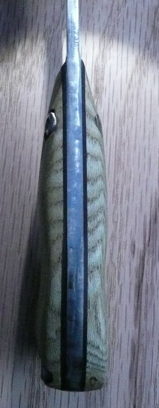

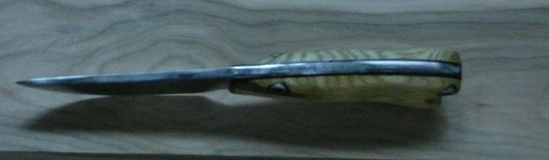

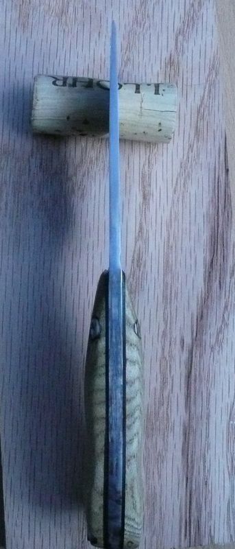

Regardless, after the oil/varnish dried today I burnished the handles with denim again. I also realized I'll never get a polished finish on the blade, so I touched it up at 400 for a decent satin finish. I'll be treating it shortly anyway.
The sun was out for about 5 minutes after work, between rain showers, so I got a couple half-decent shots that I think represent real life quite a bit better:
I took a shot with a bunch of arm hairs on the blade, but it didn't come out. Stropping at 1200mx under power and over black then green compound on leather, the thing is just wicked.
I couldn't be more pleased.

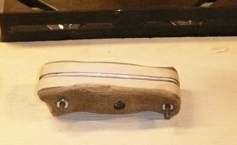

And you didn't epoxy then on did ya? So they are removable?
Thanks Dex!
Just epoxied the liners to the wood, and blue-loctited the screws. No epoxy securing them to the tang - still removable.
So when the wood shrinks and splits in a couple years I can still have tommythewho work up some really nice ones for me. ;)

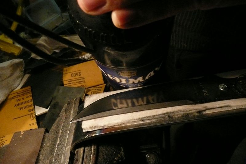

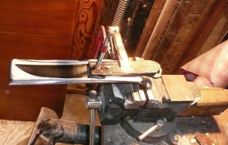

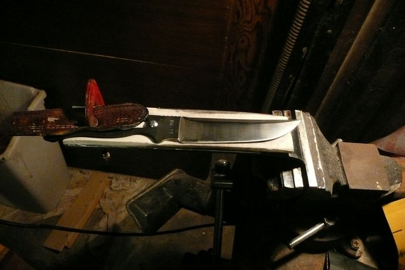

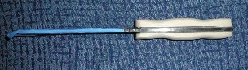

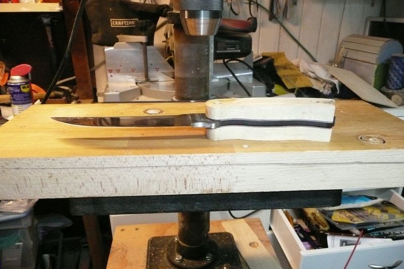

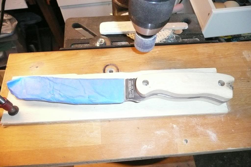

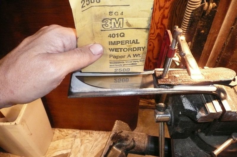

Followed Daizee - the -wise's advice and made a knife board:
Stuck the 15 on there and set to hand-sanding:
Pretty good, but not as shiny as I wanted even after 2 hrs and working up to 2500, so I stepped it back down to an 800-grit satin finish:

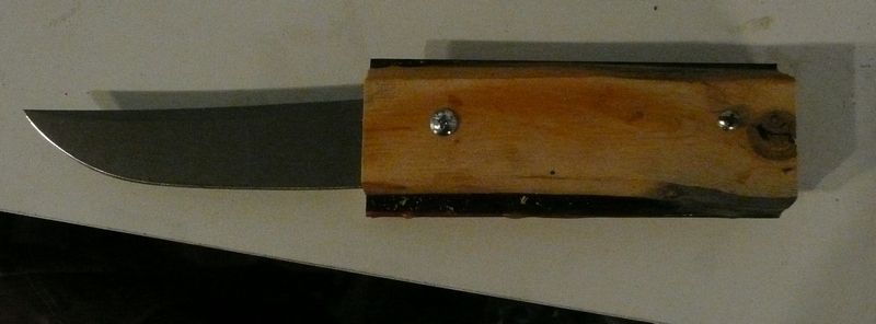

Got the scales roughed out:
We interrupt this mod thread broadcast to inform you that I have too many views in my PhotoBucket.
Pictures should return to their normal underexposed graininess around the 21st or 22nd of April.
Hopefully I'll be able to post a few more pictures this weekend.

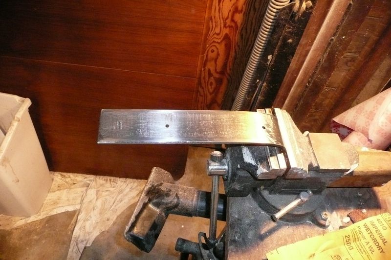

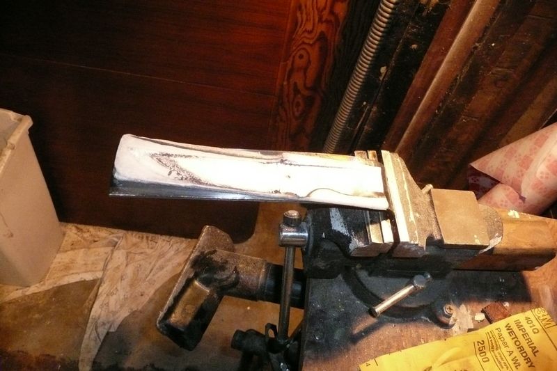

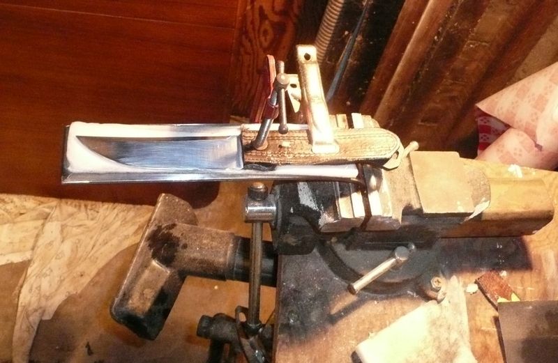

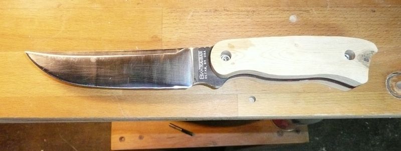

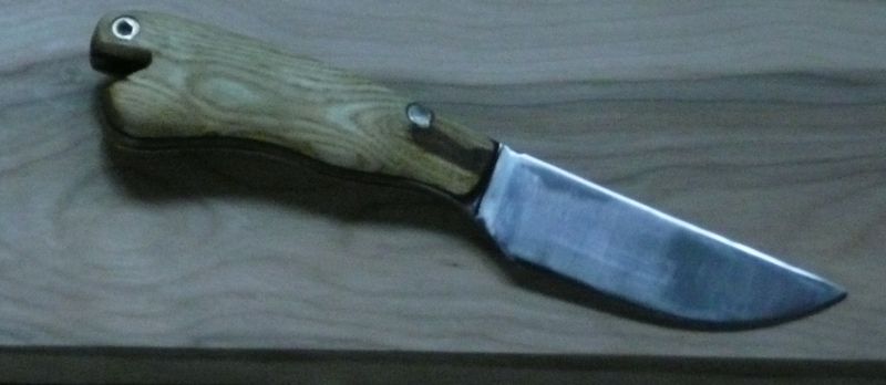

Got the 15 blade nice and shiny, mounted the way-thick wood scales, and began forming them to the tang.
Updates of the 15 in progress:
Fat Scales:
Ready for a good polish:
Ooh, Shiny:

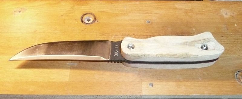

Scales mounted, and ready for shaping:

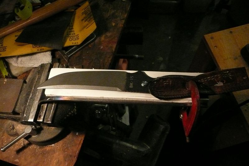

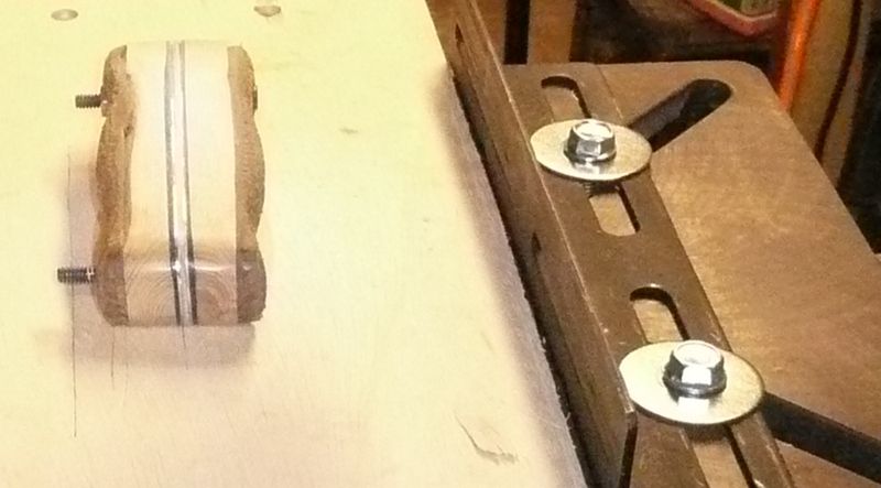

The Knife Board, with Backer and just Plain:
60 grit on the drum and 80 grit on the belt - finally got a little
Beckerness" to the 15 scales. Still a ways to go, but useable as-is:

I really like that blade shape on the BK11. Great mod. Handles for that 15 are coming along nicely and nice knifeboard. Can't wait to see the finished product.
Thanks Jordan.
I can't wait to see it either! Still a little ways to go.
I'm excited to see how the modded 11 looks next to the shiny 15.
