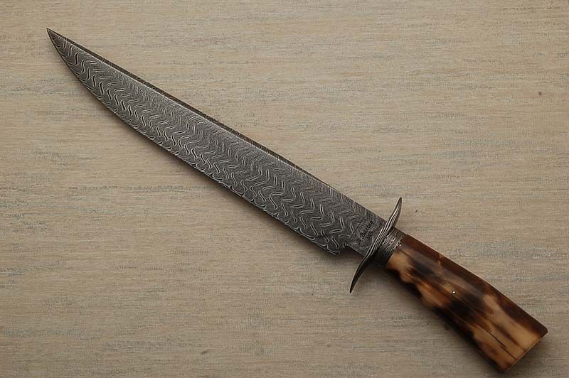

Here's a couple I'll have on the table.
6 bar W pattern twist modified a little- with walrus ivory
Feather pattern and stag
Hope you can stop by and get a closer look,
Thanks for lookin
Bill

Bill, those are some clean and classy bowies - well done!
