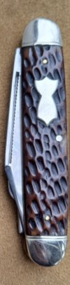

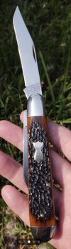

One of my lingering frustrations with GEC is that they are lazy with their dying of the bone. I don't like the ends remaining white while the rest of the bone is dyed. Not sure why they can't dye or color the entire scale from end to end.View attachment 2693671View attachment 2693672

That's what happens - meako called it!!the bone is ground to fit the bolsters and the dye is removed at this stage??

Oh Pshaw...it helps to be a complete BoneheadThat's what happens - meako called it!!
It happens less often if the bone slab is thinned/sanded at the back side before installing it!!
It's hard to get it exactly right - takes a lot of fitting and trying!! And the bone has to be shaped just right!!

Well, that's a result of using traditional techniques. You will see paler corners on antique knives as well.I don't like the ends remaining white while the rest of the bone is dyed.
That would require them to mount a bone slab to the liner, grind it to the satisfying state, unmount, dye, mount it back. And they'll have to track down which slab goes with wich liner while slabs are umounted for dying. That is a realistic work for a custom maker, but not for the big production plant with hundreds of copies.Not sure why they can't dye or color the entire scale from end to end.
How are Case, Rough Ryder, Marbles, Rosecraft and other far cheaper brands able to do it? If GEC can get some of the scales dyed end to end I would think they can get them all dyed end to end.Well, that's a result of using traditional techniques. You will see paler corners on antique knives as well.
