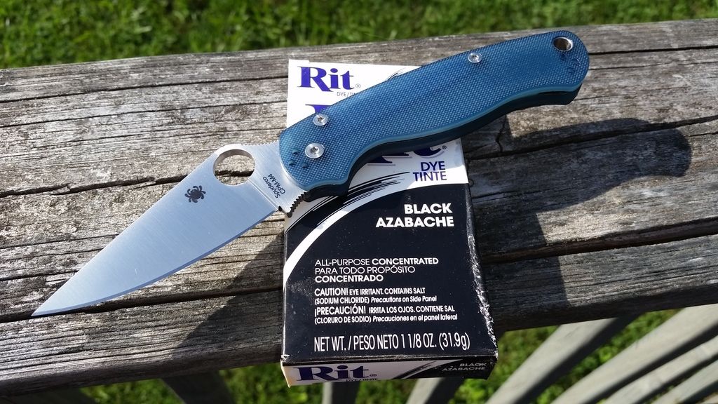

That was black dye and it ended up that shade of blue / gray ? Really? Looks great.
Anyone know if these can be bleached to a clear or white?

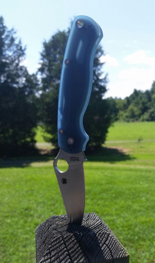

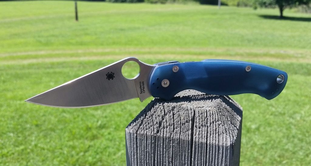

Thanks everyone. I was actually going for more of a gray color, but I am pleased with how it turned out. I did take the scales off after pulling out the hair dryer, then the heat gun to break the RED Loctite loose! I used a whole box of powder in about 2 cups of water and boiled it. I left the scales in there with it barely simmering for probably a total of 15 minutes, pulling them out and rinsing to see the progress every now and then.
Instead of a Blurple color, I ended up with a Bluray![]()
