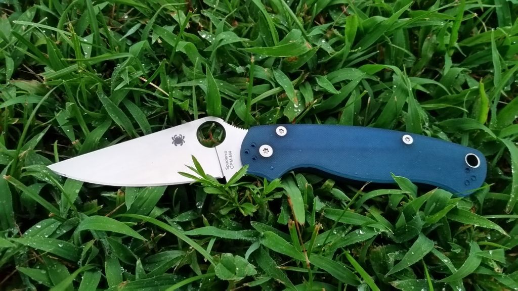

Yeah, you're not going to get super penetration of any dye on G10. Think a much lighter-colored version of the dye used, plus how it will mix with the current "natural/jade" color. You're really only coloring the exposed resin.
Based on my experience with dyeing other G10 in the past, it does seem to stay pretty colorfast though.
The digi cam G10 is just natural G10 with a layer of camo on top. I have seen it dyed quite a few different colors including red, blue and orange. If you were so inclined you could probably do a little searching and find out more.

Nice work Spydesense! Looks classy and subtle.
I think Spyderco should do a bunch of translucent colors now!
What I can't figure out is why the G10 is a different color right where the lock bar is. Yes you would think that the lock bar is farther away from the inside surface of the G10 but when playing with it you can push the lock bar all the way over against the inside of the G10 just like the rest of the liner but it doesn't change that appearance. Is the back of the scale inlet a little bit more where the lock bar is, i.e. the scale is thinner?
