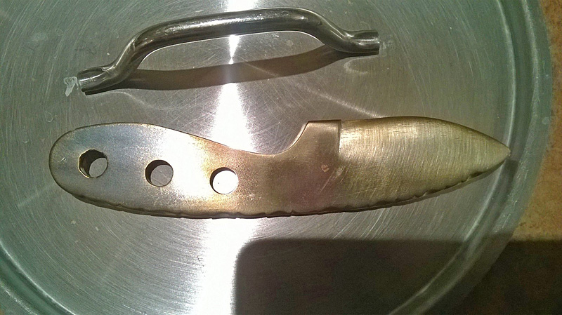

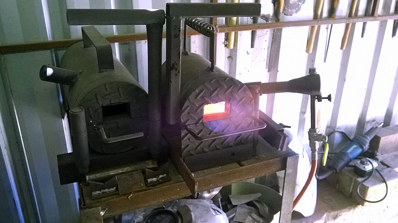

These knives you are making from the bar of steel are much better in shape.................but it is a shame that you haven't read a bit before you rush ahead.
If you had, you would have read about distal taper, which would have made that nice filework and blade look much better.
You would have know that the burner should be on a tangent with the top of the forge chamber, not aiming straight in at the floor.
You would have seen and read some about blade shape and not making overly large and fat handles. ( last group of knives)
Take a deep breath, slow down a bit, do a bit of reading, fill out your profile ( really important), and post some plans and drawings first before rushing ahead.
You are doing good,...really good.
Thanks. Gotta know about it first to read about it. That's called learning and I love it! I've just read into distal taper thank you for that.
I'll adjust the angle of my burner port.

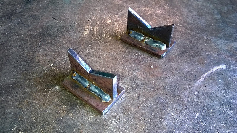

I was thinking it would be good to elevate the blade slightly off the tile in the forge so I made these two little stands today to minimise contact with the steel.
What do you think? Just an idea.

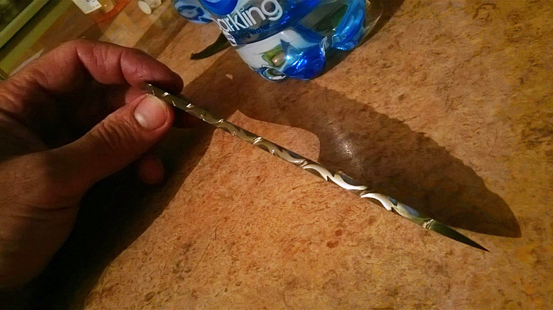

Looking at distal taper. Google images etc. Looking down on the spine of the blade, I see a lot of knives taper off all the way from the handle to the point. Many don't taper until just before the point.
I suppose it depends on the knife. Is there any advantage to a taper all the way?
I tapered mine off tonight when I did stock reduction to the cutting edge. I still need to file the point off a bit as it's too fine and delicate for hardening in the forge as it is.

Those cradles probably won't cause any harm, but if the forge is heated up fully and the flames swirl around the chamber ( not down on the blade), laying the blade on the forge floor is the normal procedure.
Most of us move the blade around, flip it over, move in and out, etc. to keep it heating evenly. The standoffs used in HT are for multiple blades in a electric HT oven. Like these:

I'm a total newbie to knife making and have gotten to the point I want to heat treat some 1084. I've decided to build a propane forge for this purpose. I'm at the point in my build that I need to install the burner inlet nozzle and want to verify that I have it right. The info on these forums has been very helpful, but I've been a little confused as most of the forges I've seen have the nozzle going straight into the heat chamber and some even recommend installing the nozzle pointing towards the back of the chamber. So, before I strike an arc, I wanted to make sure I've got this right.
Does this look like I'm on the right track?
Thanks for any feedback!!
So tomorrow I'm taking my forges to work to cut off the ports and move them to the back and fix the angles.
Good. Post some pics tomorrow night. I think you will find the forge runs much better.

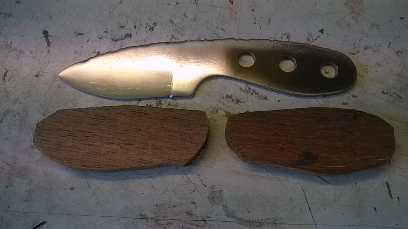

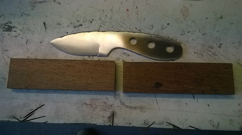

4, 5, & 6 Scales cut and rough-shaped.

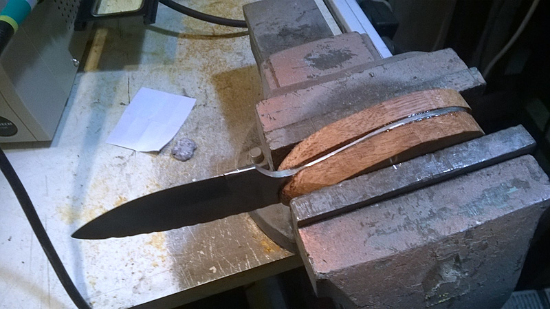

7. Scales glued with 2 part epoxy resin, (araldite) and clamped overnight.

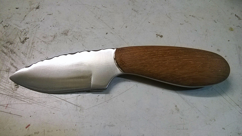

8. Shaped and sanded ready for finishing.
Ah yes, the exuberance of the new maker! You obviously have the interest and you are pretty handy at building stuff. Now that you have jumped in with both feet and made some finished knives slow down. You will learn much more if you concentrate on doing the very best you can at every stage of construction. Quality always beats quantity. Your knives will be much better for it. Take some time and do some reading. Search out examples of other people's work you respect and see what well made knives actually look like. You are doing great. But you will be wasting an opportunity to bring your work to a whole new level if you continue making the same kind of knives. Part of the learning process is reflecting upon your work and being critical. This is done one knife at a time. If you make 20 knives, all the same, and haven't learned something new from each one you have just progressed at 1/20th of the rate you could have. As excited as you are now imagine being 20 times the knifemaker you are now if you just slow down a bit and concentrate.
Very nice.
Now, I want you to do an experiment to learn a valuable lesson.
Wrap that knife blade in a towel ( to protect your hand) and hold it by the blade. Give the handle a sharp rap on the spine side with a wooden/leather mallet ( or use a 2X4). I am willing to bet one or both scales fall off.
Pins are not just pretty....they are needed to prevent lateral shear of the glue joint. Additionally, if the tang to scales surface is very flat and you clamp the handle while the glue is curing, there may be almost no epoxy anywhere but through the holes in the tang. This is called a "glue starved joint". It can be prevented by grinding a slight depression in either the tang, the scales, or both. Just leave about 1/8" smooth perimeter around the outside edge.
