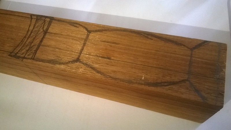

Lovely block of timber for the handle. Fine grain and HEAVY!
Basic shape to be lathed out before the detailed carving.

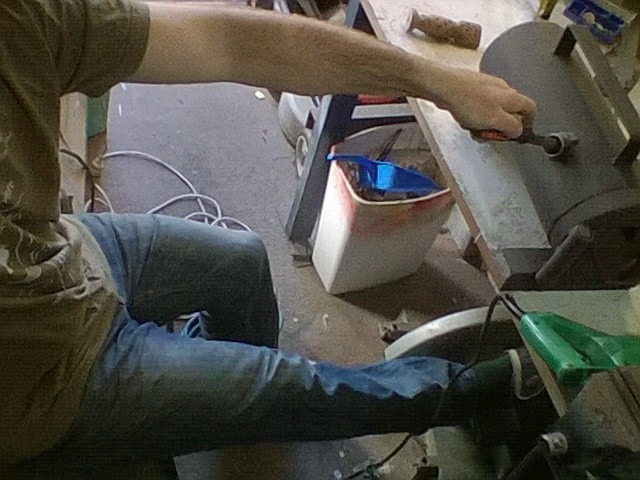

Well this is annoying and slowing me down a lot on projects. A very loud crack was heard and down for the count.
Modified workshop techniques for cripples 101: Filing on the workbench while sitting on the MIG welder, bung foot elevated on the drop-saw. Winnin'!

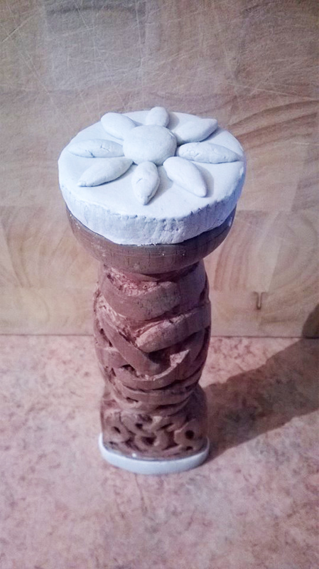

Pommel and hilt design. This is made of self-drying clay which when hard, will have a plaster mold poured before casting in molten brass. Final detailing will be engraved into this basic design.

Clay hilt hard and dry, sanded for exact fit.
The great thing about using air-drying clay is that once you pour in the wet plaster, it gradually softens as the plaster sets. It then pulls out easily and perfectly with zero damage to the mold.
Clay pommel pressed into soft clay to form a mold. This might work to pour molten metal into, but I'll do a plaster mold as well. Both need to be bone dry before contact with liquid metal or, BOOM!!!

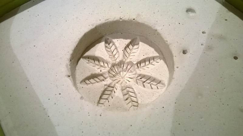

Now the plaster is set, I spent some time digging out the clay then carving in some detail for the brass pour to pick up. It is a bit agressive, but I'm planning on sanding it down to a dull pattern once cast.
Hopefully the plaster will be dry enough tomorrow for hot metal.

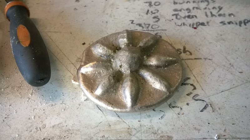

Today I bought some kitty litter made of bentonite clay and ground it to a fine powder with a coffee grinder then mixed it with my dried sand to make casting sand. A spray-bottle of water got me just the right moisture content to pressure form the sand to hold it's shape.
I made another pommel out of wet clay to make an imprint in the sand.
Molten brass poured.
Looks like it worked although I might add more clay into the mix for the next cast.
