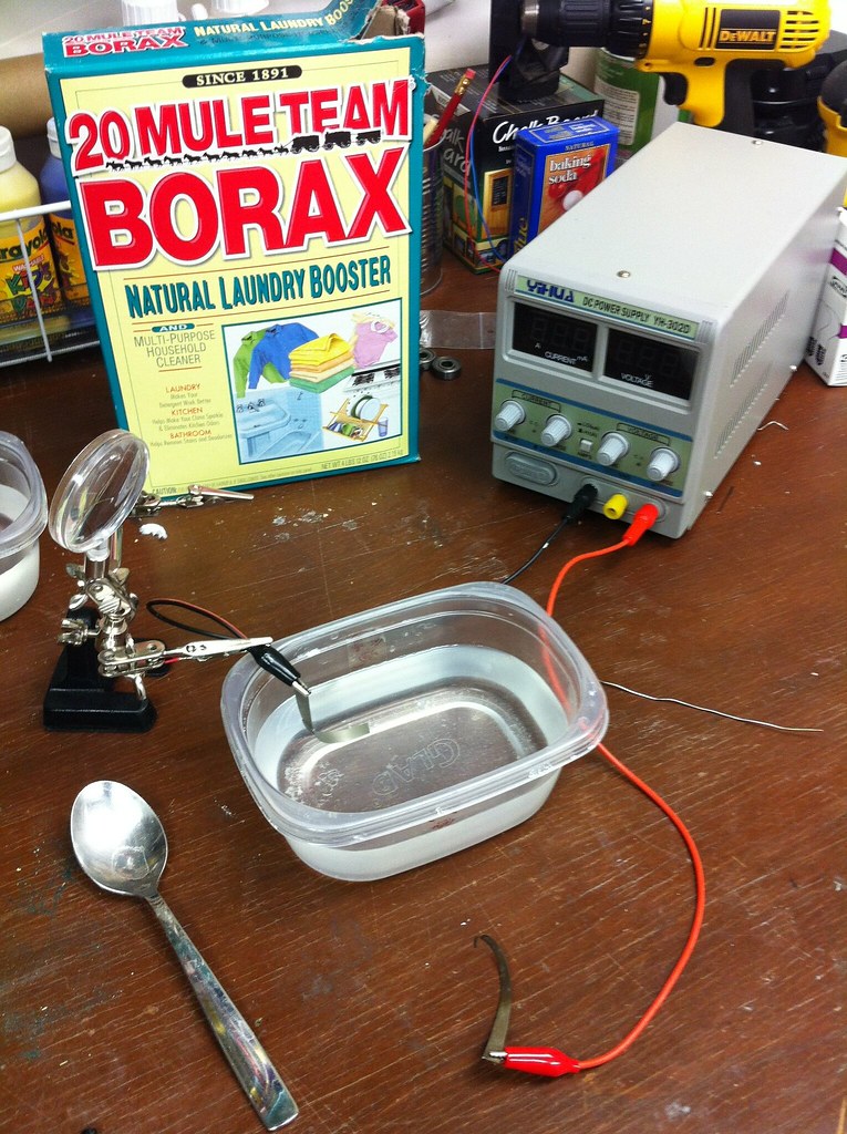

Well, whatever it is made of, for any of you who are going to anodize your Umnum with LBS you need to carefully cover the LBS with electrical tape so none of it is exposed to the water.
I have a zaan that I have considered anodizing like this one but only after masking the grooves with something like Mask-It Masking Lacquer. After the higher voltage treatment, remove the masking lacquer and retreat at 12.9 volts to give a deep bronze to the grooves. Thought the two tone treatment would look good.
Regarding the LBS, I suspect that you could coat with the same lacquer before anodizing. Of course, clear fingernail polish may work just as well.
I did try clear fingernail polish first but it didn't work completely. It did reduce the amount of rainbow discoloring but did not stop it completely. The electrical tape works much better.

Ok, how do I get myself some home anodising?
