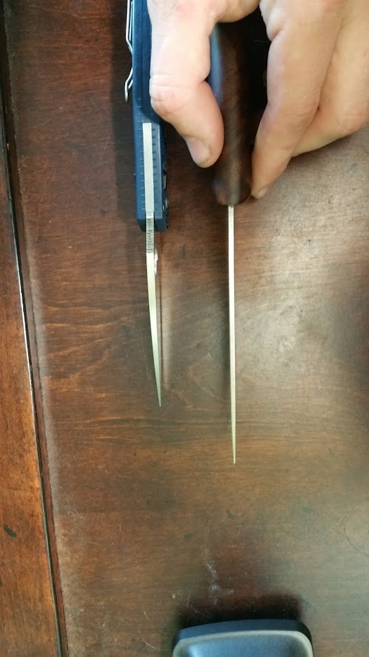

I mentioned wanting a thin slicer, primarily because I felt a thin hard knife that could handle hard use was much more useful than a half inch prybar that can split a tank. But thin this thing is, less than 2.5mm and around 2.5 oz. It looked like it would be a perfect skinning knife.

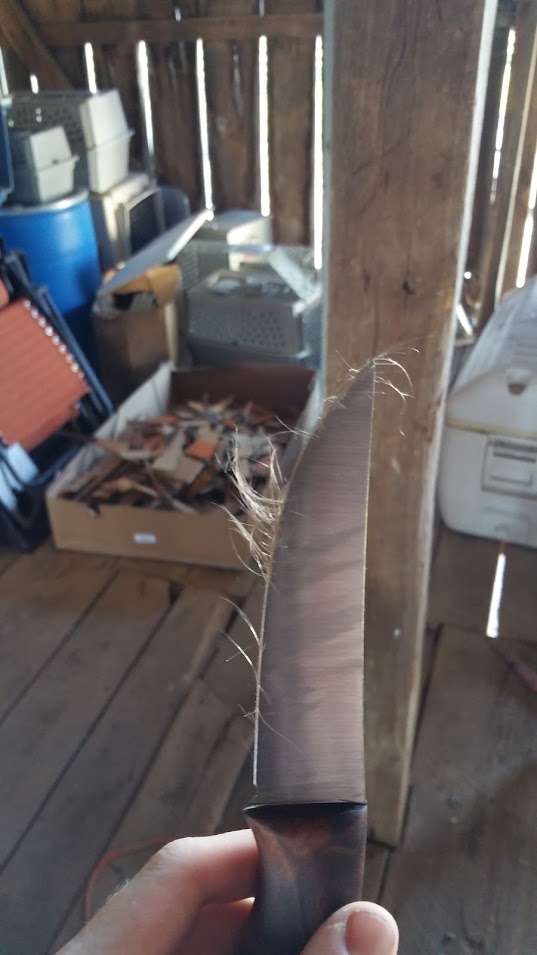

It push cut phone book paper quite cleanly and also easily and cleanly shaved, although it was a bit grabby.
