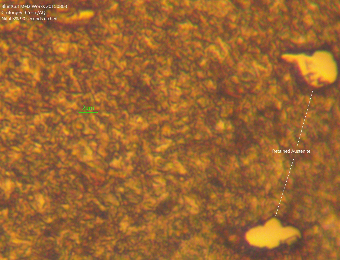

As whether this blade micro-cracked during ht? Well, I can't tell for sure because I only looked at it using light-micrograph. Actual light-micrograph of this blade:
Nano-cracks are quite elusive even under SEM & BSED. Results of my suspended ht-track suffered nano-cracks but it took me over 50hrs to correlated what I am seeing at 60nm to crescent chip on high hardness blades.
I don't see any crack at this resolution (smallest details are at 250 nano meter). Obviously there are 2 big visible RA as-quenched. This test blade tempered at 350F, so hardness probably at least 62rc. Also no cryo involve (my dewar is empty and won't fill it for for quench purpose but might do it for extended soak). At this low temper temperature, I expect RA mostly the same amt AQ. This blade designed as a slicer, so if RA end up convert the Mart when impacted, that has been accounted for, treating un-tempered mart as matrix at maximum hardness. It would be great if someone test Phil Wilson Southfork as done in this thread. Nah, my wishful thinking :p
The twin of this test blade got tempered around 425F ~61-62rc. It's also a slicer except with lower strength and higher toughness.

Instead of using Lye solution, SQ (super quench) uses Brine+Dish-Detergent+Surfactant. SQ rates as a 3 seconds quenchant (brine ~5s, p50 ~7s). Quenching crack you mentioned are macro with size from 1mm to the whole blade width. My current SQ ht doesn't suffer any macro nor nano quench cracks.
I almost use the same SQ ht params for most low Cr carbon steels (5160, 1095, 52100, Cfv, Hitachi White & Blue#2, ...). I also selectively SQ mid-Cr (semi stainless) with carbon from 0.6% to 2.5%. If a person just aust/heat and sq dunk, failure rate (due to macro crack) will be over 99%. SQ any steels with carbon in solution > 0.4% is at risk of macro cracks. Discuss for why doing SQ is a long discussion, thus too OT in this thread.
Cfv specifically - I've a whole 0.114" thick sheet (23" x 36") and quite a few 1/4" thick bars. I plan to SQ all my Cfv knives. At this point in time & market space, I think, I am the only one capable of producing SQ knives using steels with carbon over 0.6%. I wish there are more than just me doing SQ, so I can exchange notes :thumbup:

I've tried many different ht params for Cfv. When SQ cfv, even with carbon in solution is between 0.45% and 0.6% (lower aust temp & short soak); if grain is large, it will cracks probably right around M(80%). To SQ successfully, aust grain boundaries must mostly free of large conglomerated & agglomerated particles, of course fine aust grain implies more gb interfaces. Grain pinning take precedence from particle/carbide first before going down to fine ceramic then to atomic. Take a hard look at Zener Pinning concept and visualize how ocean waves would break up when introduce large & small objects on+near surface.
