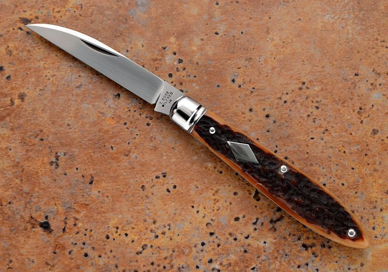

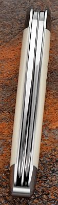

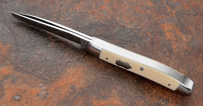

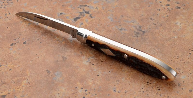

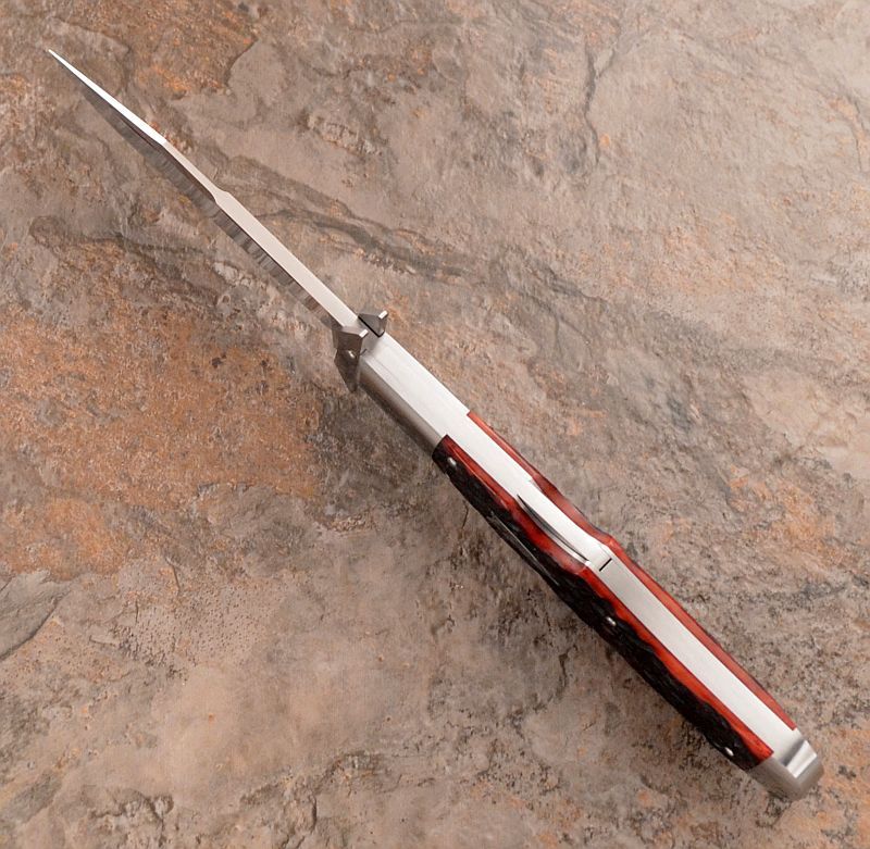

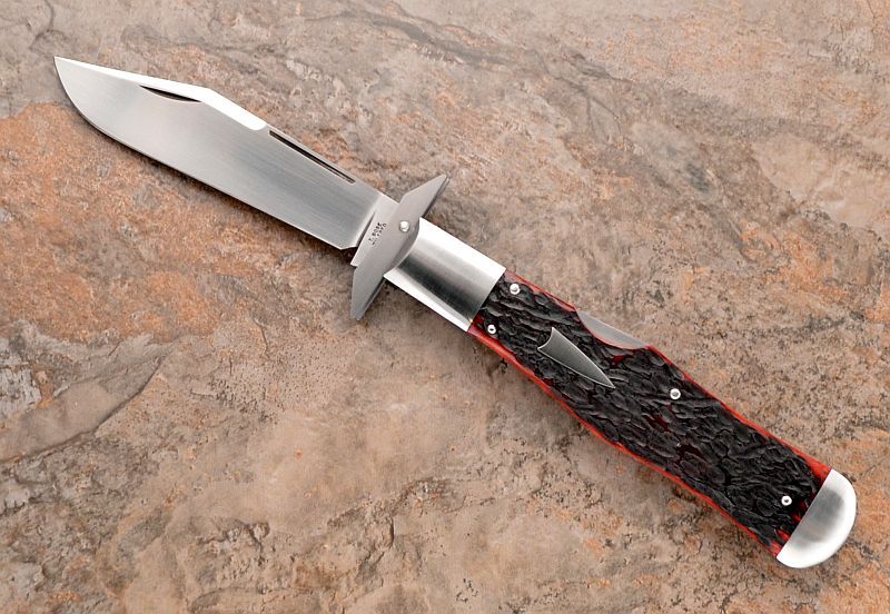

Some Saturday entertainment with great photos by Kerry Hampton and knives by T. Bose. This one has some great looking bone!
Amazing knives - thank you, Mike and Tony and Kerry!!

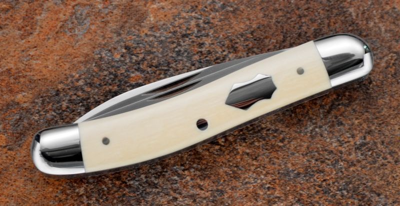

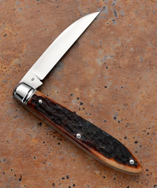

So they are all very nice (huge understatement there) but if I could pick one to drop into my pocket right now it would be this regular jack. Look at those bold swedges, long pull (would look great with a matchstrike!) and that ivory! To quote Randy Whiteman "Get in my pocket!"
3 5/8s closed. Shooter: Hampton, Kerry.

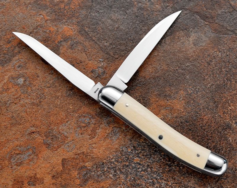

The shields on the Bose knives always look so crisp. Which brings up a question, how do they approach the shields? Are they hand cut and filed? Or are they stamped and then finished out? Do some makers have a little box of shields ready to go or do they hand make each one?
Really nice examples btw, everyone should aspire to own a knife like that regardless if you're a die hard slip joint fan or not. The essence of fine handmade knife collecting.
Something about all those blades jammed in there is just too cool
Here's the long answer about WilfredWorks shields: Most of the shields are precisely machine cut examples that fit a precisely cut parser plate (template). That's the only way to CONSISTENTLY get a seamless fit between shield and handle material. That said, many of the knives that Tony has made over the years have hand-cut shields inlaid into hand-cut pockets that also have seamless finishes. The smooth handle materials are the most complex and are "almost always" inlaid using a parser plate. The jigged bone and stag knives are more forgiving and can be hand cut but it does take longer and more care. Some shields that have acute angled internal points can best be done by hand because the radius of end mills doesn't allow for the cutter to enter those areas. Reese still does a lot of his shield work by hand but as the eyes get older I think he occasionally gives in to the dark side like us older farts.![]()
