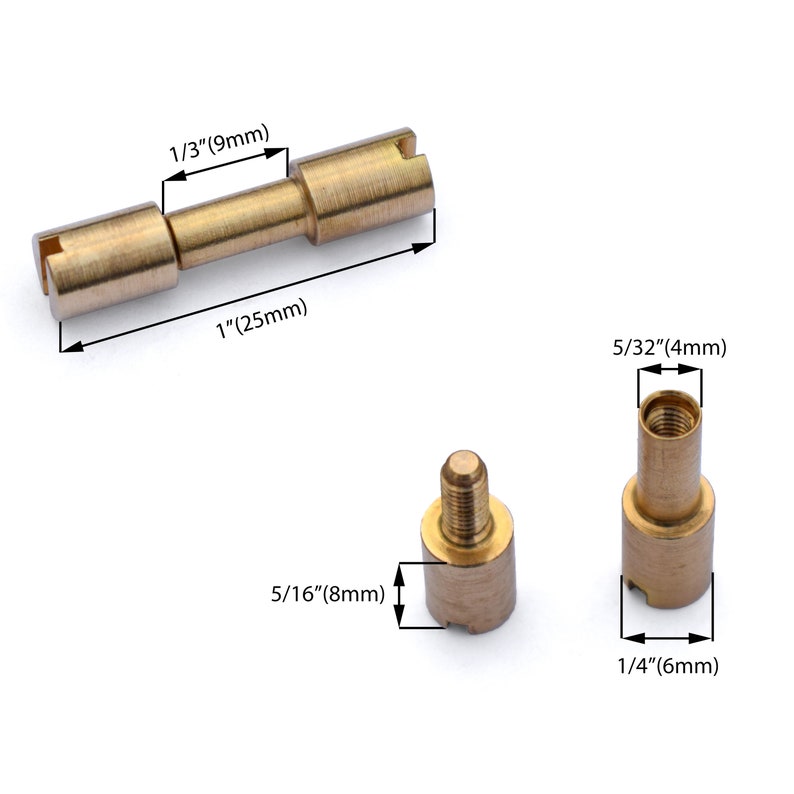

One question -- on the BPS website (and through their Etsy site), they show brass Corby bolts. Not sure if linking is okay or not, so I won't... But here are photos from the site...
Here are the bolts ... I'm curious if these can just be swapped in for the stock bolts:

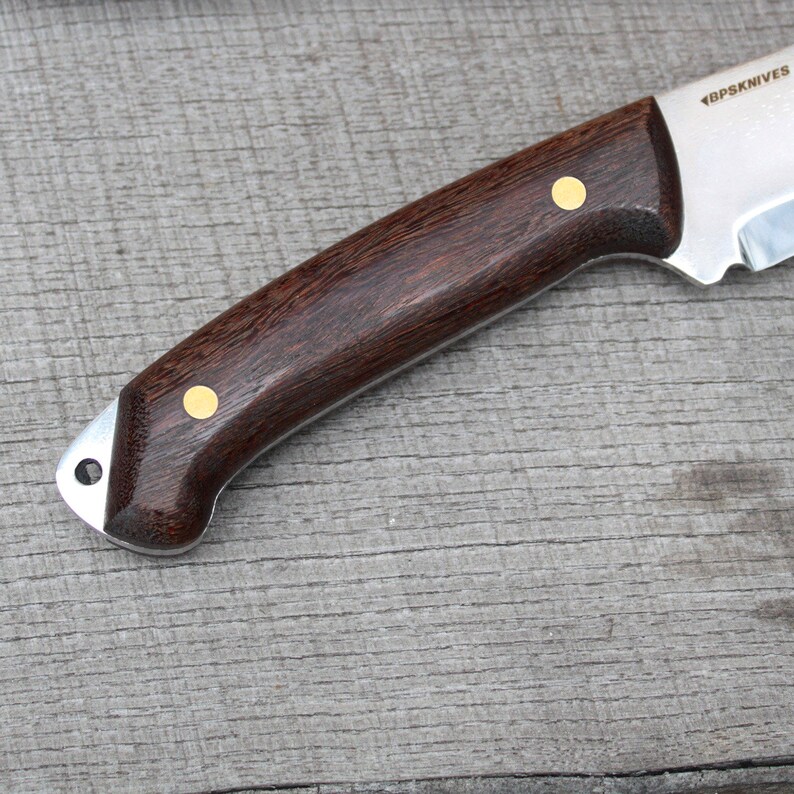

But they also show this photo, which confuses me because don't their bolts have huge screw slot in them?
Whatever these handles are, they are way cleaned up and look great, and who wouldn't like this look... But why no screw slot? Are these supposed to install sticking out last the handle, and get cut/ground down to be flush with the handle? (I think I just answered my own question... What tool would you use to do that though?)
I think that Savage in shown in BPS's Corby bolt listings, as an example of how they might be used JerMy savage has allen bolts into a central threaded tube.
Are you going to have a go Rick, they look pretty good?I have used Corby bolts before. Takes a special drill bit. Once assembled they are ground down, as Jack says during handle finishing.
Not the thing for quick change capability, then.I have used Corby bolts before. Takes a special drill bit. Once assembled they are ground down, as Jack says during handle finishing.
