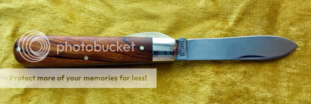

Here is a nicely modded TL-29 in desert ironwood.
You really brought out the grain in that Ironwood. Looks great!

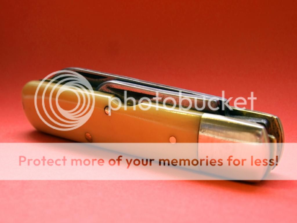

Per your request, Phil, I have made my first attempt at a TL-29 based locking Barlow.
This began life as a Colonial TL-29 with hollow handles. The knife was riveted together under the handles. Despite some brass coloration, everything on this knife is steel, as I discovered when sanding the parts.
I had to drill out the rivets and make some real bolsters from nickel silver bar stock. I soldered them on, and then spent forever grinding them to shape. I did not have the right diameter pivot pin for the blade, so I had to sand one down by chucking it in a drill and then using my belt sander and drill together to grind it down.
The scales are padauk wood cut with the grain running perpendicular to the centerline of the knife handle.
I could not get the pivot pin to hide completely on this. My reaming and peening were a bit off. I tried to fix it, and ended up knocking off one bolster, but got it back on with some 2 ton epoxy, which works quite well in this case, because the bolster was already ground to shape. I do not know if the epoxy could take the pressure of prolonged grinding.
Overall, it turned out ok for my first attempt at making bolsters. All I have to say for knife makers who do this for a living and produce flawless knives is that I tip my hat to you. This is an arduous and time consuming task, and, as the great Tony Bose says "The first thing you need is a case of the want toos."
Thanks again to Esnyx for his great tutorials, and for both Esnyx and Glennbad for inspiring me to go for it. I have 10 more TL-29s to play with, and some brass sheet to start cutting liners out.

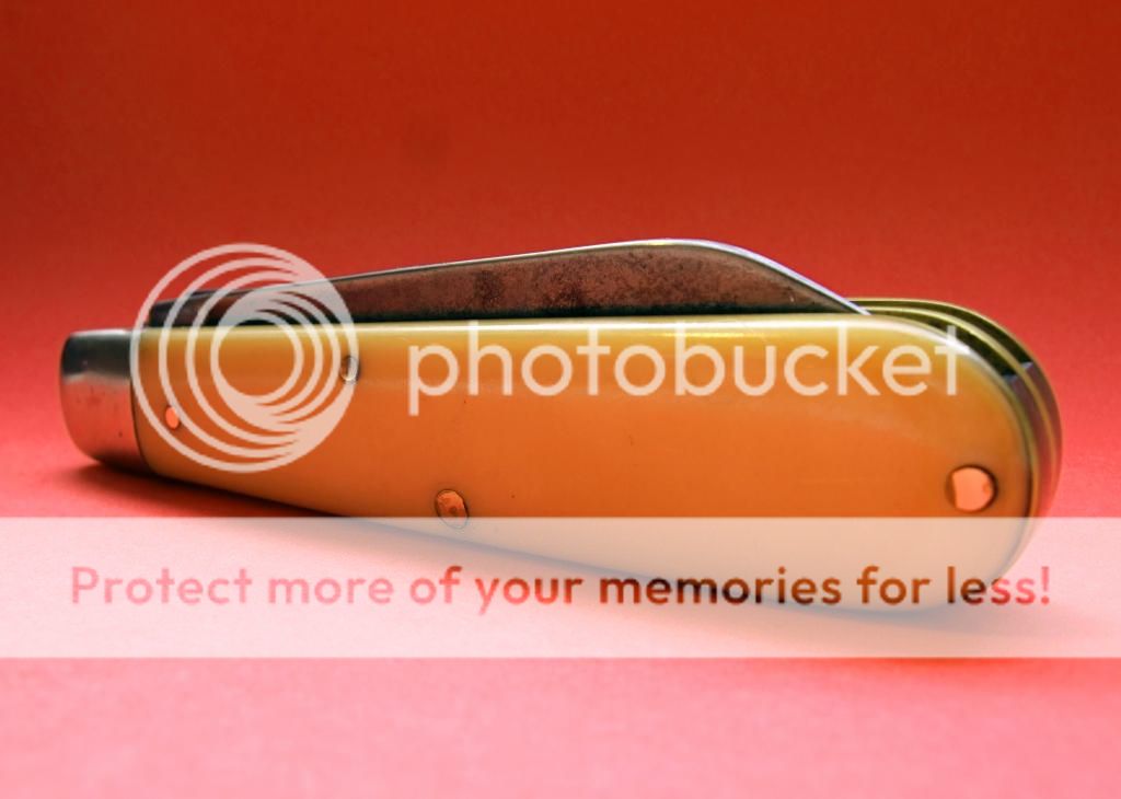

Awesome work DMA! Here's a TL-29 I just finished all by hand. Rehafted in Butterscotch Paper Micarta with Screwdriver converted to sheepsfoot.
