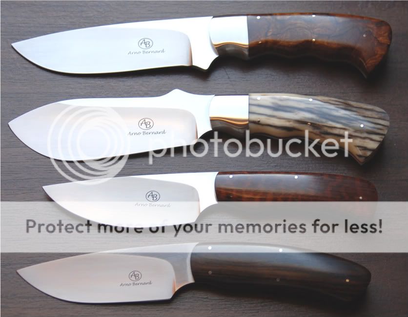

Jerker,
Honestly, I haven't used my Arno Bernard knives. Just to pretty. But they are very sharp with great blade geometry. I have no doubt that they will perform superbly if called upon.
If I ever get to go on a Texas hog hunt, I'll break in the large skinner though.
Hope this picture doesn't piss off the Buck Brotherhood
So Top the Bottom: Med. Bowie/Ironwood; Large Skinner/Giraffe; Skinner/Snakewood; & Drop Point/Ebony

sweet knives!!! i like the top one best.. that should stay a safe queen..;)
