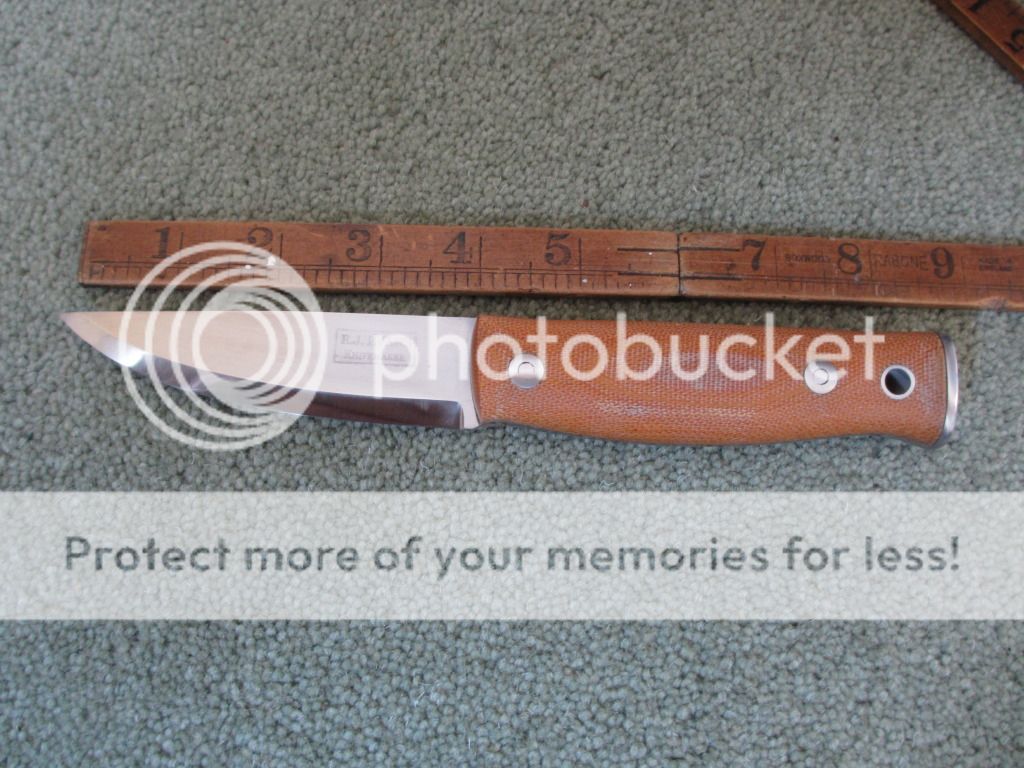

I have not got on with all curved blades though. A friend of mine has one of these, inspired by the Skookum, and while the handle is somewhat more comfortable, everything I tried to cut skated away down the blade and off the tip. Spot the difference ;)
The blade starts parallel to the handle and curves upward to the tip, vs. having a belly that curves down very slightly from the handle and back up to the tip?
