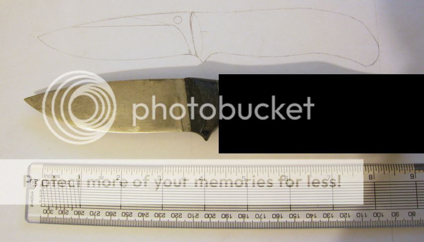

I have thought a lot about what, if any, changes would be good on the Bushcraft. Apart from the steel and the grind, the easiest would be a slight blade shape change to incorporate a continuous curve. Something like this: (although the sketch could benefit from a little more point)
It is important that the curve not just sweep up to the tip all the way from the ricasso, it needs to sweep down to a max belly depth first so that it doesn't slide out of a cut, but the curve slices well and when done right makes a good wood cutter too.
This is hardly a new idea, particularly for Spyderco!
As already mentioned, even if this version is not a dedicated bushcraft tool, it would be a shame to make the edge, and particularly the tip, very thin. It doesn't seem likely to happen on a fixed blade, but I have seen quite a few S30V folders, Spyderco and Benchmade, with tips that snapped when used for wood carving and boring.
