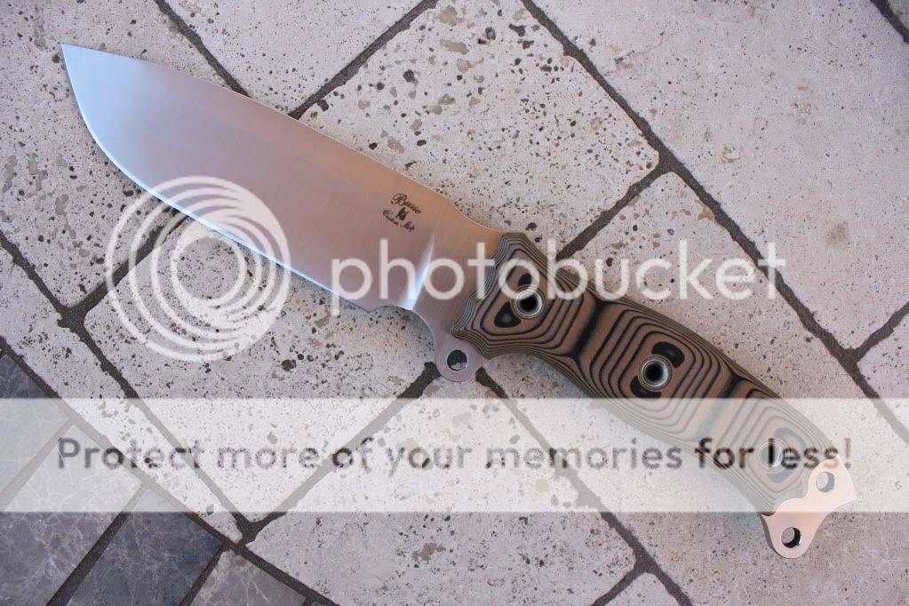

I’ve owned both brands.
Although they have very similar performance characteristics, the biggest difference between INFI and 3V is edge holding ability.
3V is better in that regard.
I also feel that the skeletonized handles and rubber inserts make Fehrman knives more vibration resistant when chopping.
After several years of use with both types of steel, I would rate the corrosion resistance of both brands as equal.
Are the handles on the final judgment skeletonized? Or just the Hood series?
