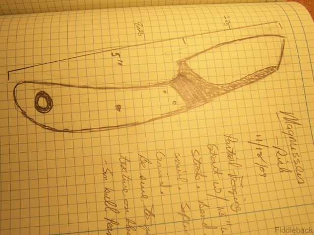

Also, this thread I'm going to mention that Rick and I are collaborating on a design! I've drawn something up. Now its his turn to make changes and post the changes.

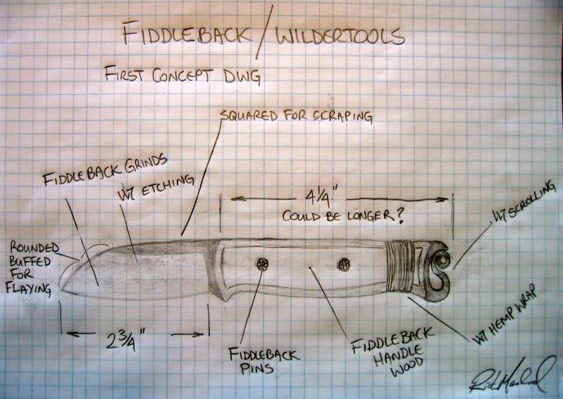

That's funny, Andy...... I think we have the same blade shape in mind... UNCANNY!
Here's my first dwg I did last night......
The dark stuff in the bolster area was for your wrapping, which I like a lot, and I'd love to put that scrolling on the end of mine too!!!
The double line on the handle area of that first dwg was my interpretation of your combo-wood handle scales...... lol... definately too much going on there

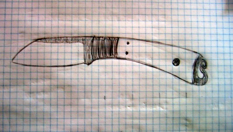

Howbout this?
DWG 2...
Drawing #2 looks real good Rick. :thumbup:
Can't wait to see how this one turns out.
Ooo. I like that. Profile it and send it to me.
Check the dimensions, Andy... the graph paper is 1/4" scale.
Thickness - 5/32"?
If you like it, I'll forge it out and send you the annealed profile

5/32" thick is my favorite steel thickness. It'll be a helluva knife at that thickness.
How are you with tapered tangs?
I'm passable. But, How does that work with your scrollwork?
