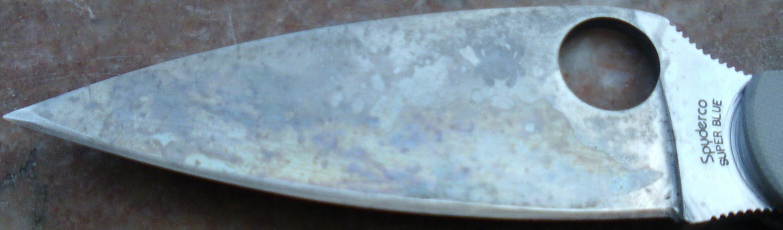

Well I decided to try forcing a patina on mine and here is how it came out:
I figured I could easily polish it off if I didn't like the way it came out but I was pretty happy with it. All I did was immerse the blade in a glass of white vinegar for about 30 minutes. Then stropped the edge to polish off the patina from the bevels and put some Tuff-Glide on the pivot area to restore smooth opening/closing. I think it will continue to patina more as it is used.
Just dipped the knife or rather the blade while it was still attached to the handle. I just immersed the blade right up to the edge of the handle.
Now that I've resharpened it, it looks better with the bevels more highly polished.

I'm sure that would probably be even better. I have some liquid ferric chloride but so far I've never worked with it and am a little afraid of it. I was going to try it if I couldn't get acceptable results with vinegar.
I like the idea of steel wooling some of the patina off and repeating the process. I think that would probably improve the results also.
But mainly, I just wanted to get a jump start on getting a patina going and get a little rust protection as well. I may eventually steel wool some of the patina I have now off to lighten it up just a touch, so more of a natural patina can develop. For now I just want to see how it goes for a while.

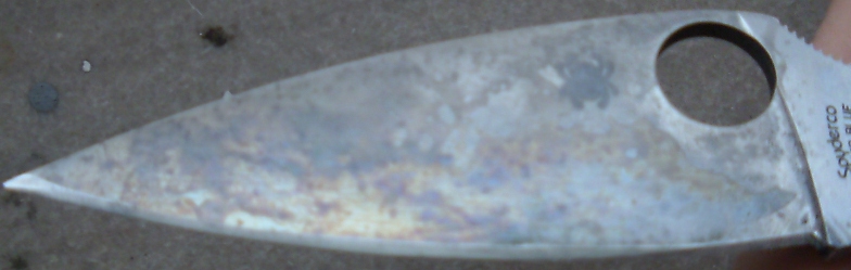

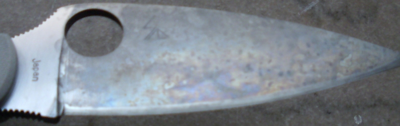

On mine, I took some steel wool to the forced patina (photos posted above) and lightened it up just a bit, but already more natural patina is developing over it. Just using it for cutting food causes it to patina more. Eventually, I think it will reach a point where it's more or less stabilized. The nice thing is that no rust is cropping up so far.
kreole, that rainbow patina looks sweet. Now I'm torn between that and mongatu's. I'll probably go the lazy route and just let a natural patina grow on mine. :p
