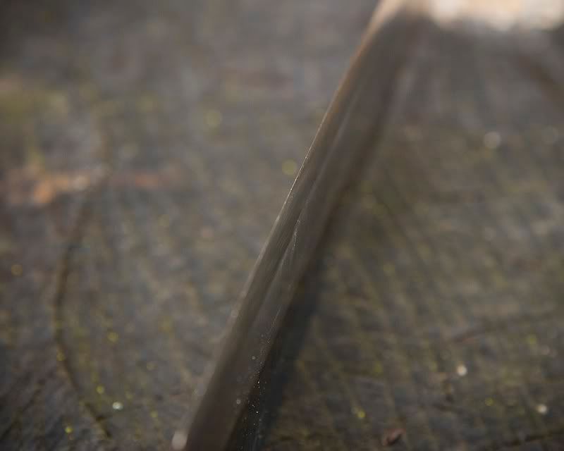

One thing I did notice is a bit of edge dulling in several places on Koyote’s knife.
Easily worked out in a minute or so.
