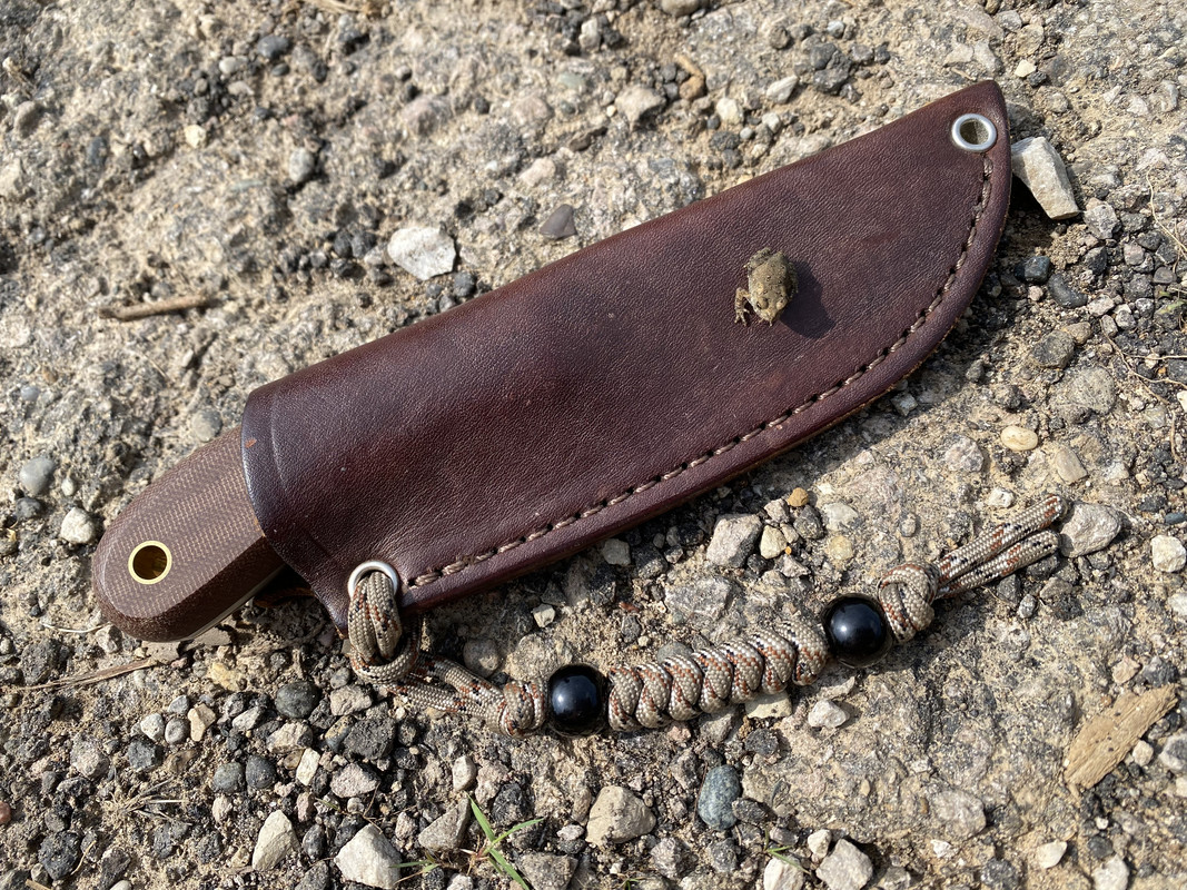

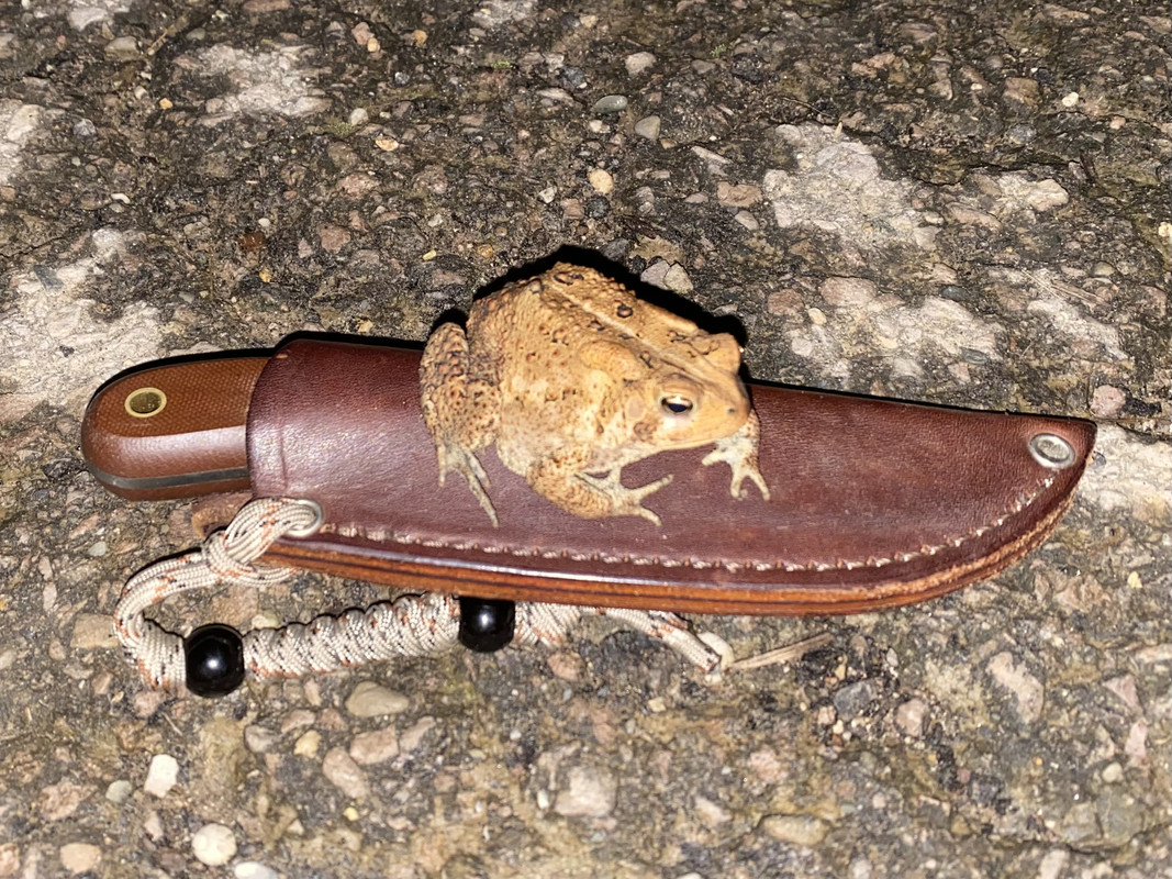

A couple days later we found this little guy.

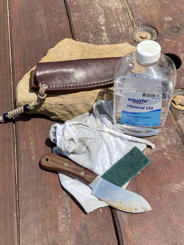

A little mineral oil and a he feels refreshed.
These scratches that are parallel must have come from one of the times we used Camper in the kitchen. They show up in pictures much more so than in person.

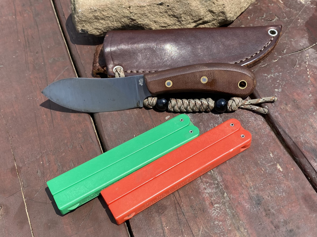

One final sharpening.

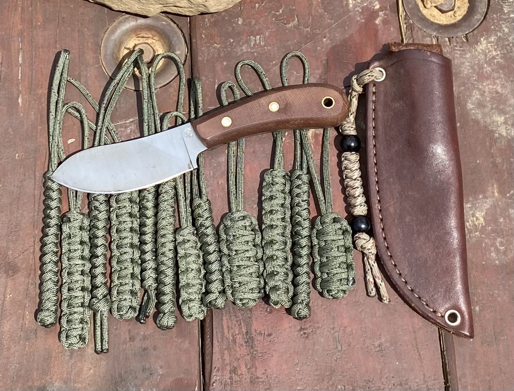

Surprise! I made lanyards for everyone to take.

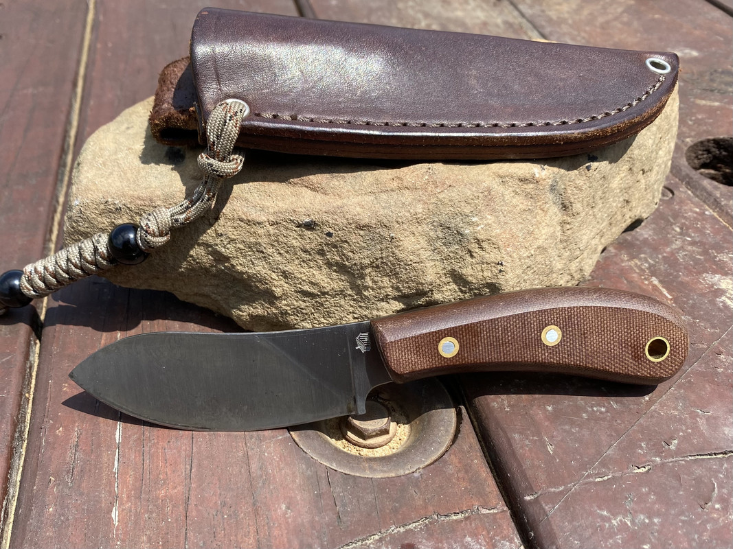

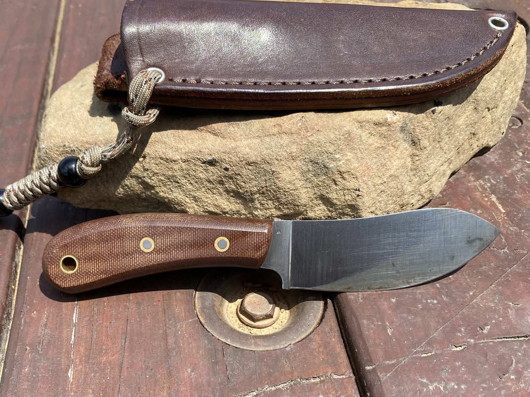

Camper got here yesterday. He's been hanging in the shop and we were discussing which of my sheaths I should make for him. I'm leaning towards the Slotted.
Glad to know he arrived safe.
Whichever sheath you think best suits him is just fine by me.

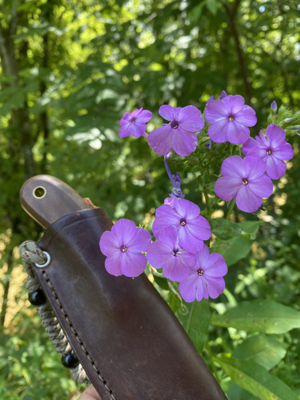

Camper found himself a nice perch to hang out in while watching the shop activities. That his coffee in the background, black no cream or sugar.
So he helped me dig through my pile of sheath patterns till we found one that was suitable. We laid it out on some heavy Wicket and Craig saddle leather (10-12 oz) and did our tracing:
While cutting out the sheath required some precise work Camper got to play with scraps and had a good time. I used my roundknife top to cut out the sheath. They are real specific tools and work well for that because they are designed too. I make my roudknives out of .040 stock so they are lasers on leather. Ol Camper he's a very robust type, lil muscular to cut leather for a living. But he had fun anyways:
Here we're prepping the sheath prior to it being allowed to day over night. The sheath has been dampened to fold it in half. This dampening also allows me to transfer the welt line through to the other side so that I know where to make the stitching grooves. Here it has been folded, stamped with my maker's mark and if ya look close ya can see where the inside stitching groove will be. I've also creased the top edge and rounded it, (bevelled or edged).
Here's the inside with the welt marked. This is the tailoring of the sheath specifically to Camper. He's getting some bespoke pants!
Now we're gonna to burnish the top edge or the throat of the sheath. Ya cans how rough the leather is after edging.
I use some water and some paraffin and it smooths right out with some burnishing:
I use a machine to burnish this but it can be done by hand too. So now we let the sheath dry overnight so that we don't mark it up sewing it.
