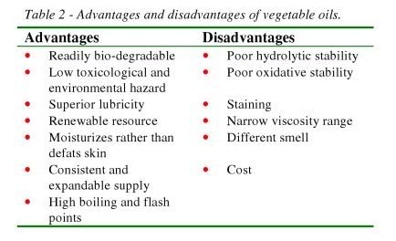

Canola oil advantages
#1. Low price
#2. Great availability
Can you think of any others?

Tai's quote is from a Houghton paper by Scott McKenzie (I think he occasionally posts here?):
http://books.google.com/books?id=io9laaRnoswC&pg=PA228
"The most widely used quenchant for ferrous alloys are petroleum-based quenchants due to its favorable heat extraction characteristics.
The dependence upon imported oil, price vulnerability, and contamination potential has caused suppliers to investigate alternative source
of quench oil base stock. There are many reasons why vegetable-based oils have seen increased interest. The primary reasons are:
* Increased environmental regulation
* Need to reduce the reliance on imported petroleum
* Increased environmental awareness."
