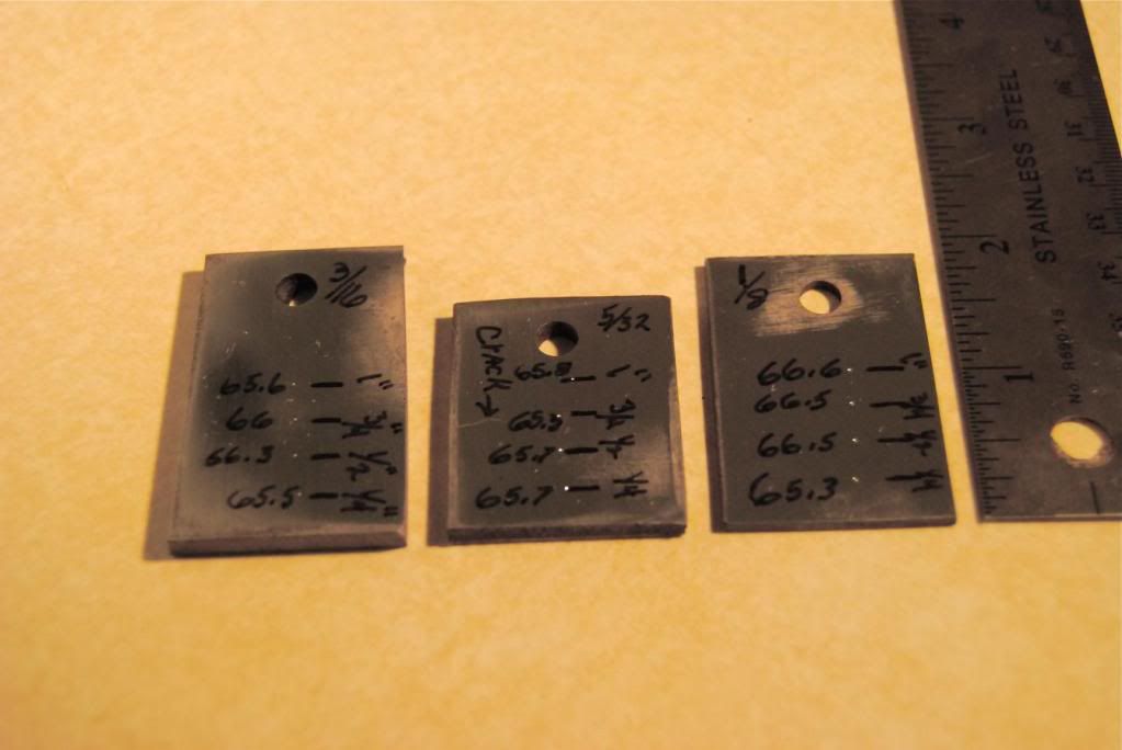

Does anyone have any micrographs of 1095, W1, W2, or other low hardenability steel quenched in canola oil?
Or even simpler, quench some 1095 coupons and test the as-quenched hardness. That will tell you the percentage of Martensite you converted.

That would be quite useful as well. For a complete idea of what's going on, both would be nice. Does anyone have any tests like that in canola oil, or micrographs either one?
People using quenching oil should have done this already, right guys? Anybody have data they can show, preferably with pictures?
p.s. I do use canola oil for quenching O-1, but have never been able to hit the target quenched hardness for O1 (and don't sell anything made that way!)
I only have word of mouth info., about quench hardnesses of 1095 with canola. Although, some did use controlled furnaces and Rockwell testers, I couldn't say that any of the information is conclusive one way or the other, due to possible variables like exact carbon content, temps., times, geometry etc. However, there are an awful lot of testimonies from smiths and (knife users) saying that they got very good results in terms of overall performance on knives quenched in canola. Many users and smiths have done field testing, long term and short term and have compared the results with blades quench in commercial fluids. Word of mouth is that the canola quenched blades are very competitive and sometimes out perform blades quenched in commercial fluids. It goes back to what some have been saying about the quenching fluid just being one small factor in the overall performance of a knife.
