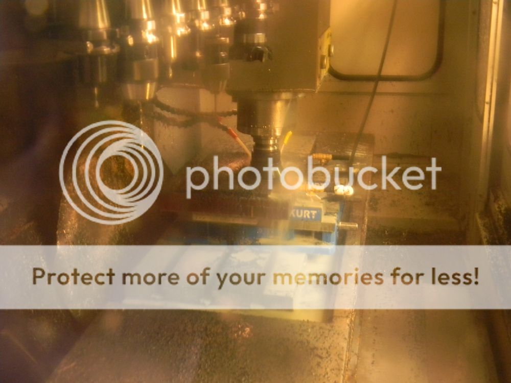

Our shop is doing a change over today and the jobs that were finishing up yesterday left us with a nice opening for me to squeeze in the scales for our prototype, so I stayed up late last night and got it done.
I only produce a couple hundred knives a year, but we make thousands of scales for other makers, so scales production is something we have dialed in pretty well.

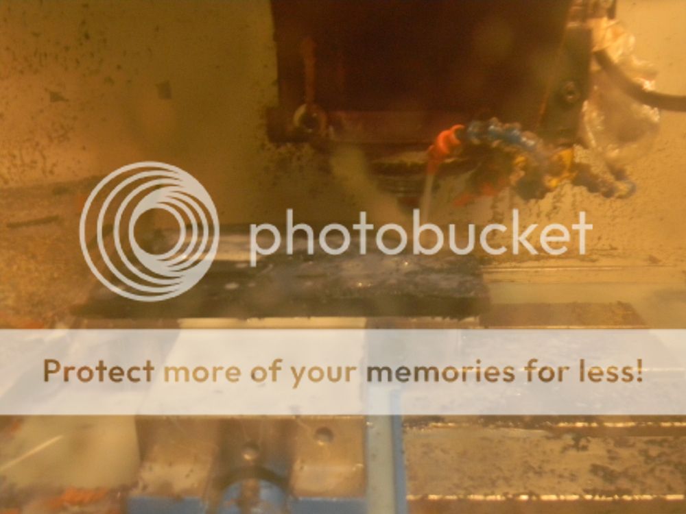

The first thing I do is suck a sheet of micarta down to a vacuum fixture. The sheet looks like it's just sitting there, but we use a pretty big multi stage system that pulls a hard vacuum, so there are a couple thousand pounds of force holding that sheet down because of its surface area. First I deck it, then I drill my holes, countersink them, ream them and finish mill the countersinks for a good finish.
1.jpg~original

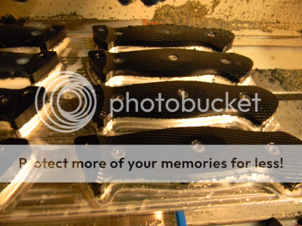

while I was setting that up and running it, Jo The Machinist made the 2nd ops fixture on her little mill
3.jpg~original

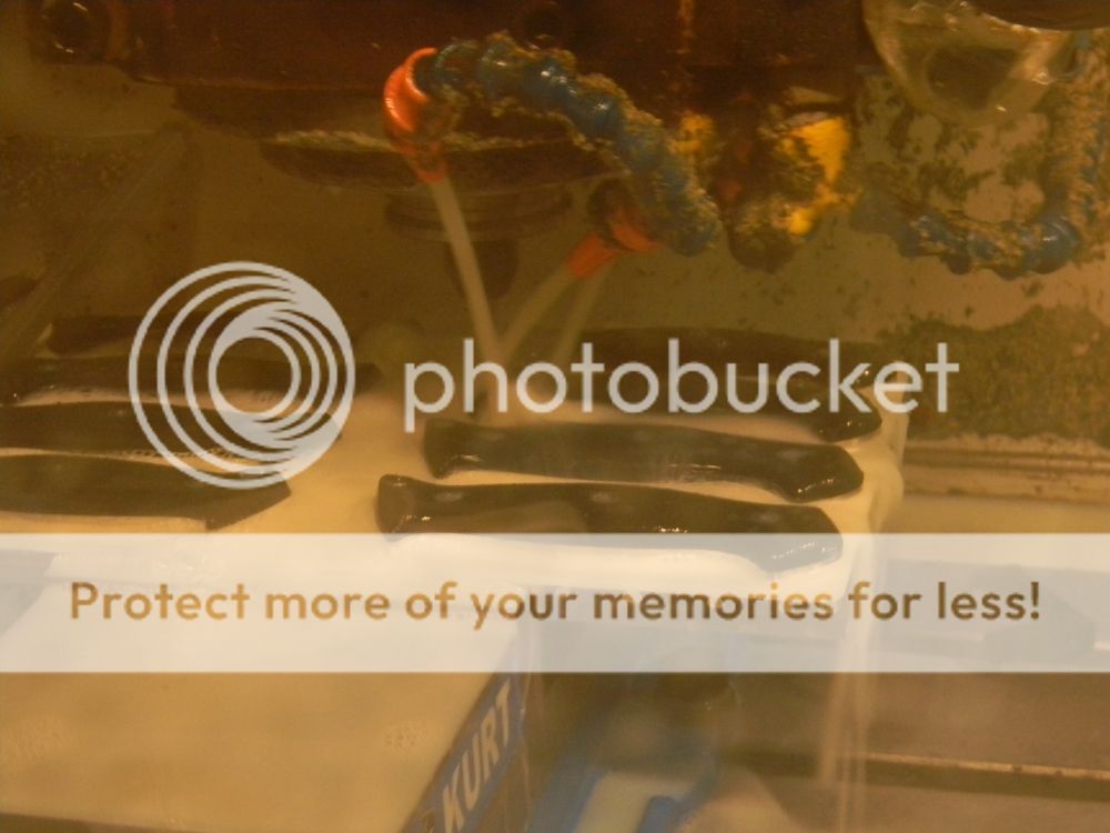

I got everything setup on our scales mill and roughed them out.
4.jpg~original
That mill stays looking filthy because all the mud from scales production. It's an unusual mill that built in a way that abrasive mud can't work its way into important bits.

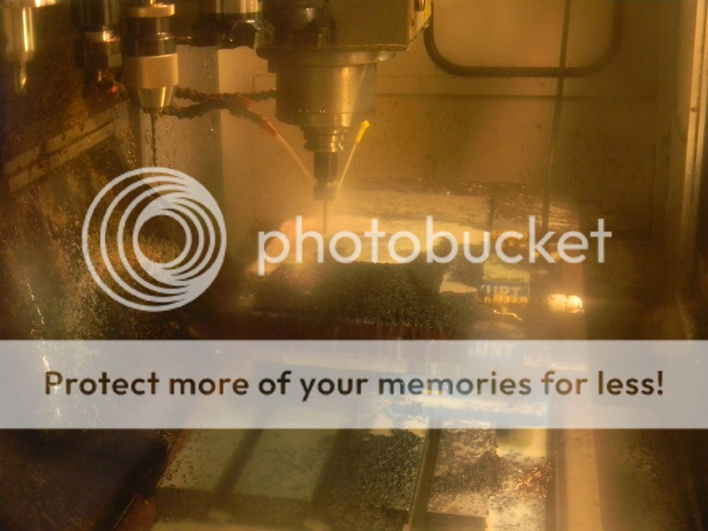

This is the scales after the roughing cutters
5.jpg~original

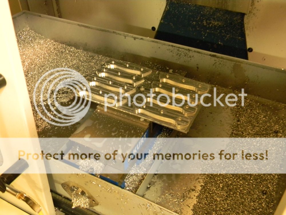

then I go in and finish machine all the visible surfaces with a special ball endmill designed for aluminum that gives the micarta a relatively clean smooth finish
6.jpg~original

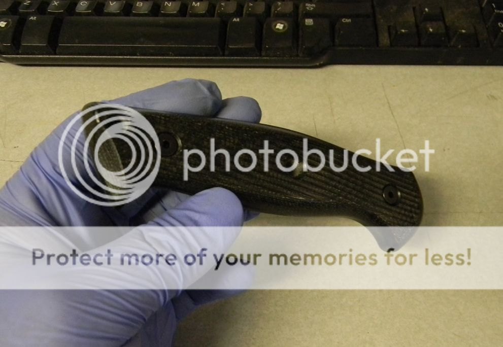

And here's the scale after a quick buff
7.jpg~original
I like milling my scales this way because, once I have the geometry tweaked in how I want it, I can duplicate it exactly.
These are probably going to need a few tweaks after testing, but once it's finalized I'll experiment with different machined textures. But these will be fine for testing.
