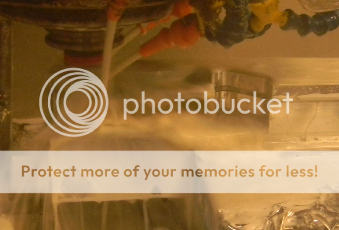

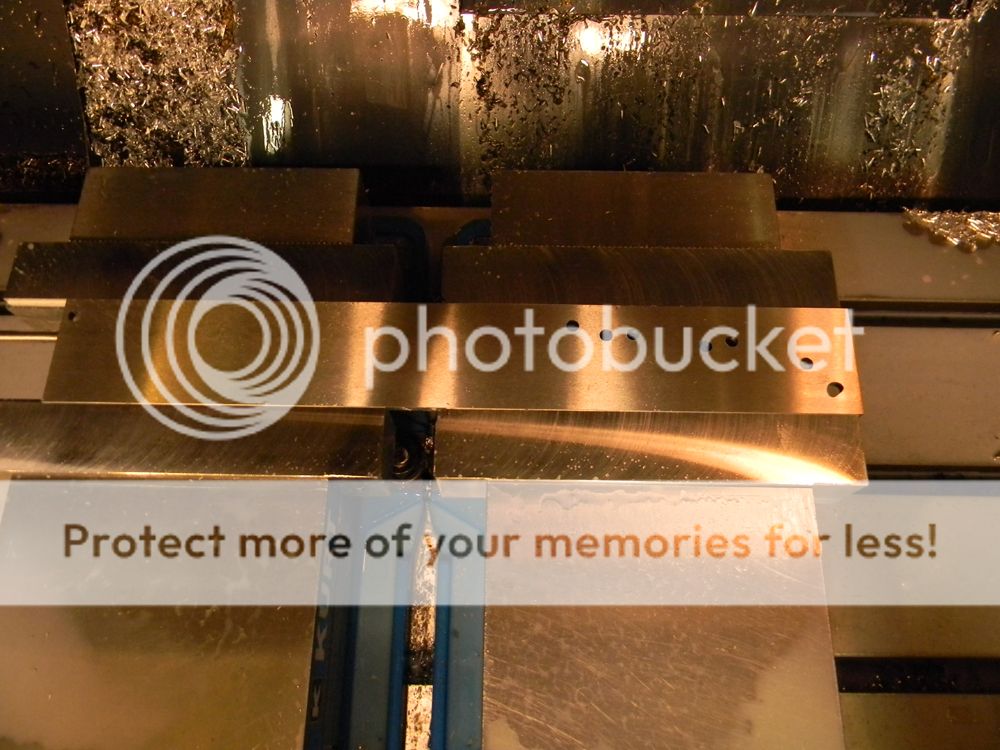

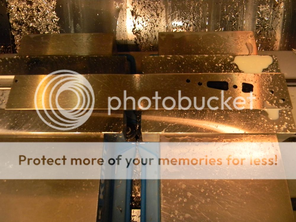

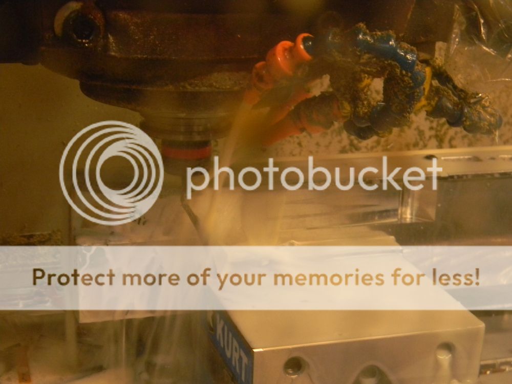

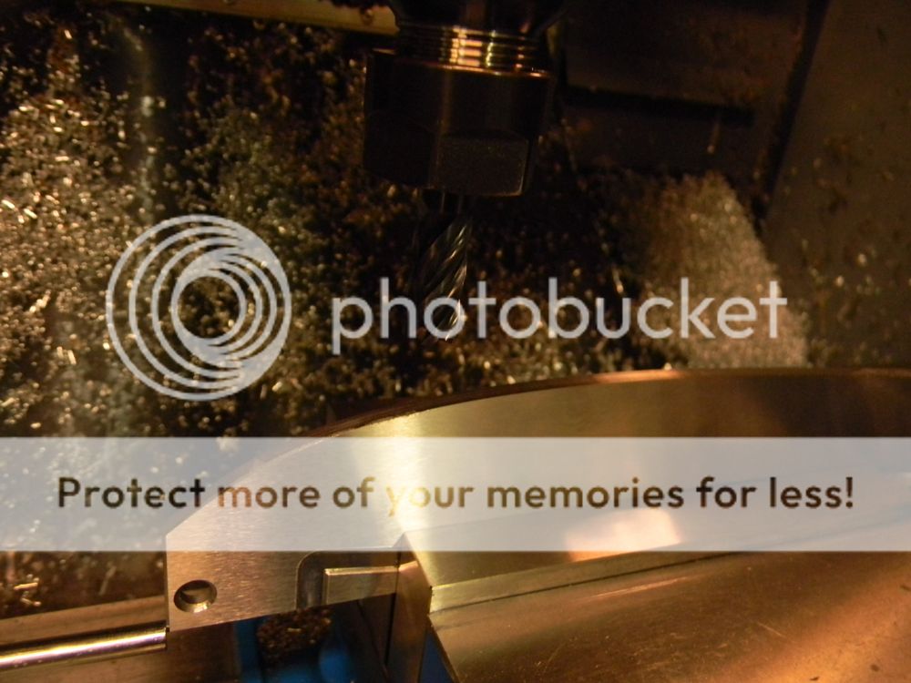

I'm starting with precision ground stock for the prototype so I skipped decking it and started with the holes. The pin holes are spotted, drilled, milled with circular interpolation and finish reamed to size. A little extra work making high precision holes now makes the rest of the process go smoother down the road. There are also holes to allow a cutter to plunge areas being skeletonized. The D shaped lanyard hole is drilled with a special D shaped drill bit ;)
1.jpg~original

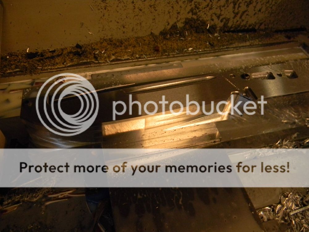

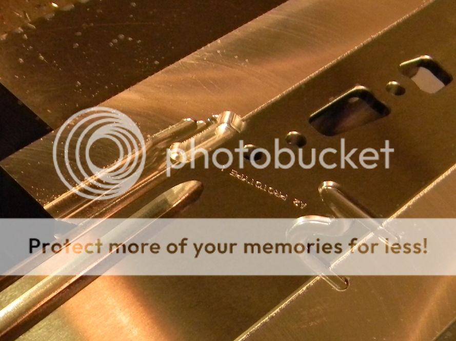

I cut unnecessary weight out of the tang. I leave it solid near the end. It's a mistake to remove too much weight from the very end.
2.jpg~original

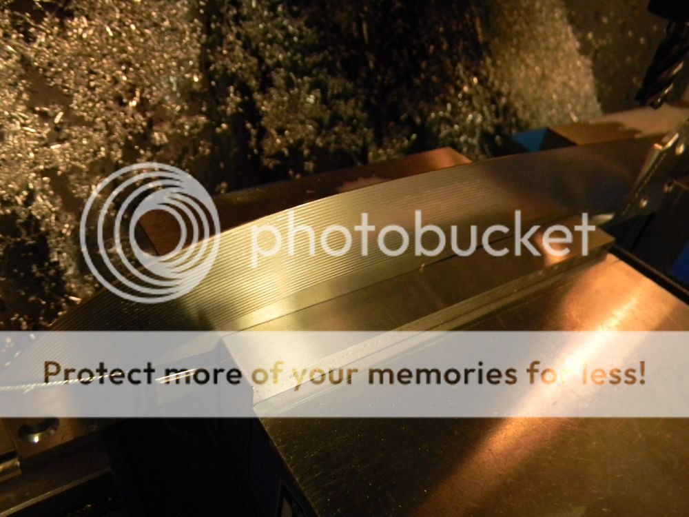

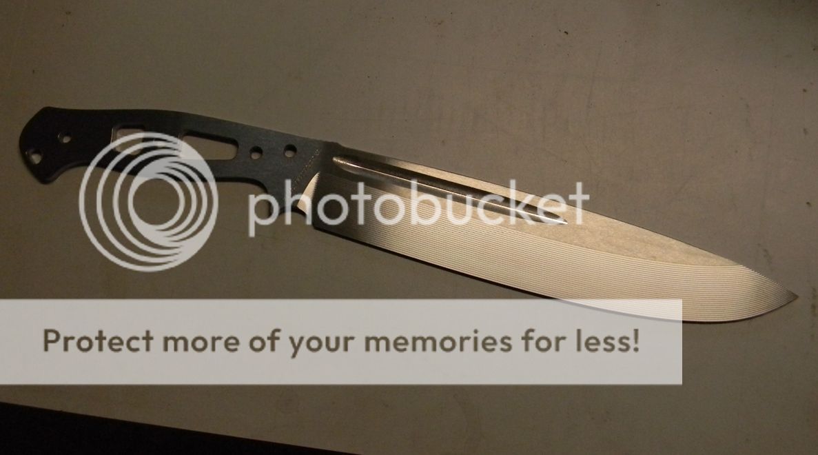

I cut the fuller in several steps. This is a pretty big ball cutter to plow with, so even with 9,000 pounds of box way grunt behind the cut I can't just cut it in one pass. So it's roughed with a 3/8" ball in several passes using a surface milling routine, prefinished with a 1/2" ball and finished with a fresh 1/2" ball. I use an endmill with a helical gash through the center to prevent a dead zone flat in the middle of the cut.
3.jpg~original
a clean fuller
4.jpg~original

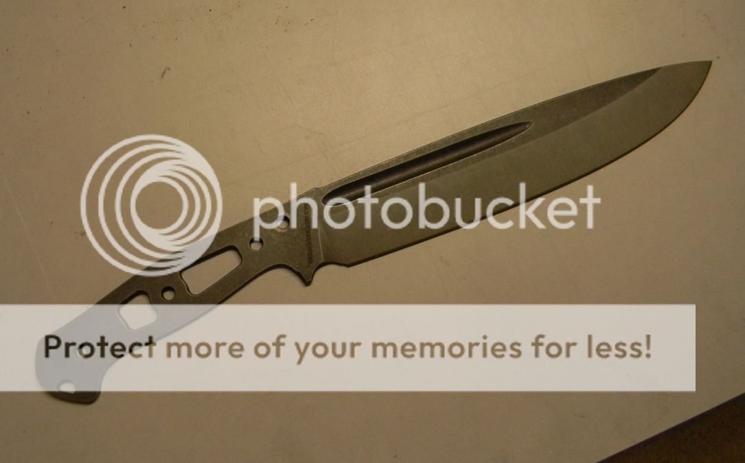

Then I go in and chamfer everything and mark it as a prototype with a tiny little ball endmill that I write with.
5.jpg~original
There's a knife in there somewhere

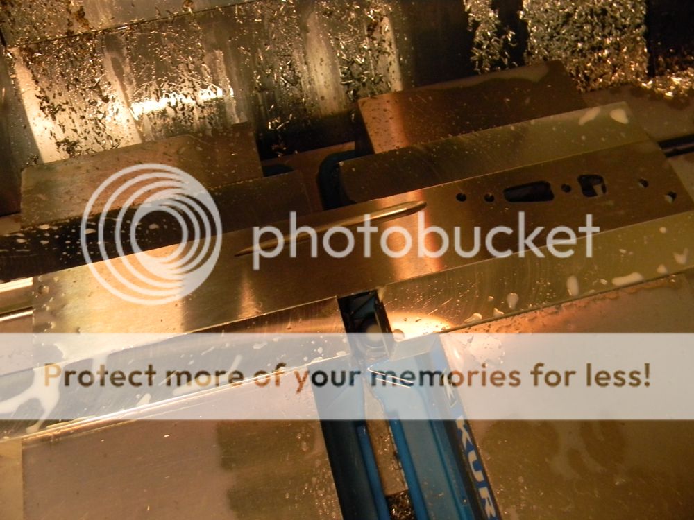

Side two was cut the same way as side one. While I was doing all this, Jo the Machinist was making fixtures. This one fixtures the blade by the accurate holes (remember those?) to cut the belly.
1.jpg~original
2.jpg~original

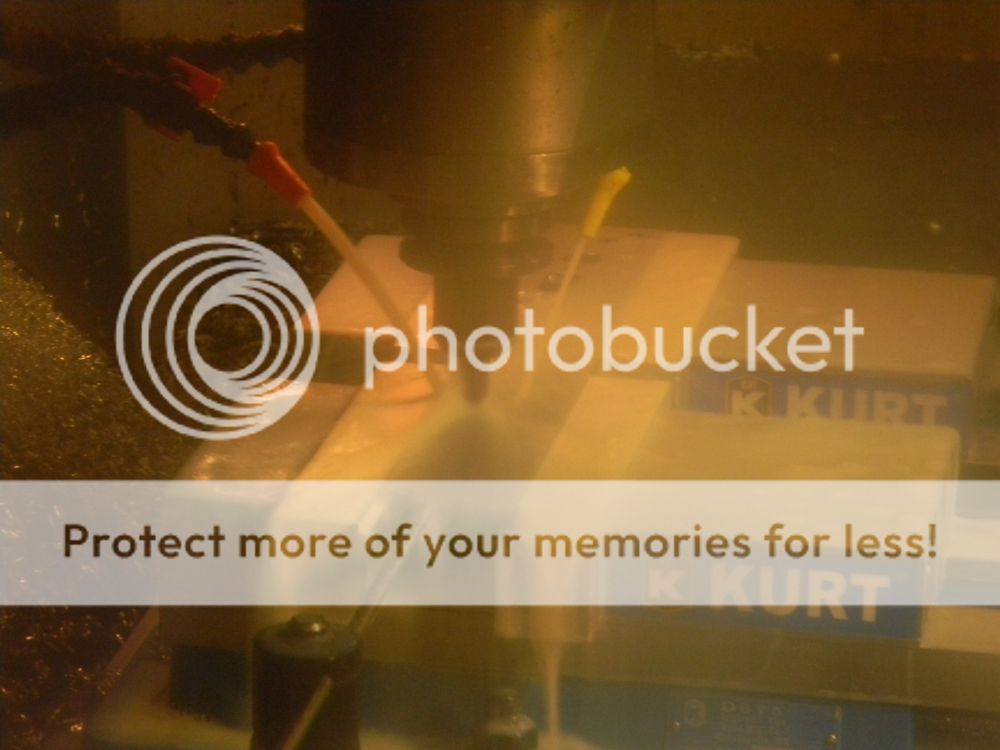

Then it goes back in edge-up, held by the spine to mill the bevels. This is just a prototype so I'm simply holding it straight up and will cut it in a series of fine steps. In production I'll make an angled fixture to hold it where the cut can be made directly with the side of an endmill, but I'm not making those fixtures until the optional angle is confirmed through prototyping. Something of note is the problem of chatter when making a cut on a tall thin unsupported workpiece. I addressed this with a special 5 flute cutter with uneven flute spacing that reduces harmonics. It has small radii on the corners to reduce the notching left behind in the work when machining this way.
3.jpg~original
4.jpg~original
This is a slow approach and it leaves a stripe texture that is both weaker and drags more in the cut than a smooth side, so I don't normally cut bevels this way, but for the prototype I'll just grind it smooth later.
5.jpg~original
There is definitely a knife in there somewhere now
6.jpg~original

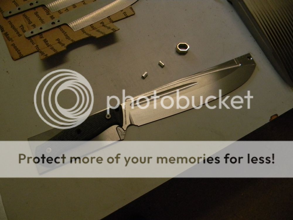

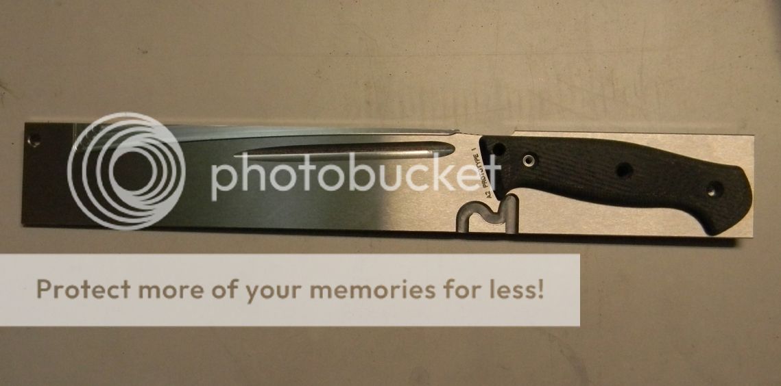

And the finished prototype
14.jpg~original
15.jpg~original
18.jpg~original
The goal with this knife was a practical large woods knife and light chopper that hits above its weight. This is me trying it out on a 2X4. I'll send one up to you for some involved testing clearing trails.
