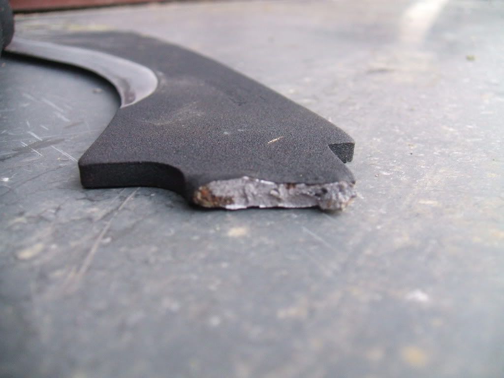

Indeed, one must wonder what great efforts it took to break the CS kukri-machete presented. I rarely see broken hidden-tang Bucks or even Kabars despite their enormous prevalence (the odd Kabar here or there vs. the millions about), broken SRKs or Randalls, etc. much less broken Bussekin. What i present to you is that whatever force is required to bend/break that steel tang is MORE than enough to bend/break the aluminum handle trying to support it unless that section of handle is ~2X thicker than the piece of steel being bent. If the fracture in the tang is due to impact-shock at an inclusion in the steel, again the aluminum doesn't help. While i have no doubt that the cast-in-place design will sell (those Gerbers sure did) I am not convinced it will lend any noticeable superiority in handle strength over a more comfortable material like plastic/micarta/wood where the tang provides the necessary strength, not the handle around it.

Again, how much effort did it take to break that CS Kukri? From the image, it looks like it was bent back and forth multiple times - NOT easy to do by hand. BUT if there was an inclusion in the steel, it could have been fractured loose without any measurable bending, i.e. even a steel handle around it wouldn't have helped.
How about the Mora plastic handle cracking? The shorter tangs require a lot of strength but can be leveraged out of the plastic handle when it fails... try that with a longer tang (any of the lower 3 in the x-ray image) and the outcome is not so certain, it takes much more force to accomplish because the handle relies more on the strength of the tang. The tang of even a Mora is that strong, and I've never seen one crack out of a wood-handle unless the handle was being smashed with a hammer.
It is NOT easy to bend/crack a good tang despite very weak handle materials that provide excellent insulation against temperature and impact. Tangs can and do break regardless of the handle material, regardless of the presence/absence of pin-holes, because multiple factors are at play. Tang stock-thickness/width is primary, that's what Busses rely on (and good steel) - as you noted, they aren't easy to break. In the case of a Mora, like Busse their steel supplies the strength, not the handle material. And while a thinner mora will bend quite a bit before it cracks, it will start bending under MUCH less stress and probably take a permanent bend before the thicker busse even begins to bend elastically much less crack.
Most blades of any tang do not "simply crack" unless there is an inclusion (like the kitchen knife on the first page which fractured without any evidence of deformation of the stiff handle scales and nowhere near the first pin-hole). If the tang is 1/4" thick, and the handle supports each side with only 1/4" of aluminum (assuming the 3/4" handle you suggested), then the force required to bend that tang is more than enough to bend the aluminum on either side which requires 2X that thickness to be as strong as the steel it is supporting. If the tang is only 5/32" thick with 9.5/16" aluminum on either side, each side is as resistant to bending as the tang itself, but tang and aluminum-siding are still ~3x weaker than a 1/4" tang and not much lighter, so what was the point? A handle that can handle a lot of hammer-whacks and be lighter than steel?

Again, how much effort did it take to break that CS Kukri? From the image, it looks like it was bent back and forth multiple times - NOT easy to do by hand. BUT if there was an inclusion in the steel, it could have been fractured loose without any measurable bending, i.e. even a steel handle around it wouldn't have helped...
I know for a fact that some guys that replaced CS's handle with wooden-one had problems with vibrations when the Kukri was used, the handle wouldn't stay intact, actually if I remember right, in some forums they specifically warn new guys not to remove the pin in this particular model in order to prevent breakage of the handle.
The case with this particular CS Kukri is described here, in BF: http://www.bladeforums.com/forums/showthread.php/668281-broken-when-chopping!!/page2
Look at posts 6 (OP) and 7, here is a better picture from the same thread courtesy of scrumpy jack:

A better picture of that kukri break: http://www.bladeforums.com/forums/showthread.php/668281-broken-when-chopping!!
The steel was already fractured and rusting prior to the impacts which propagated that fracture to failure, nothing that a cast aluminum handle could have prevented (except by being too uncomfortable for the wielder to use).
You're making my point:
How could it have cracked inside a cast on handle? How would rust get into a cast on handle? The handle would have been fused to the tang a half inch higher - where the tang is considerably thicker.

Fracture was already present, hiding it beneath aluminum doesn't fix it, and that makes me wonder how the cast aluminum "bond" to the tang would have held up to repeated chopping impacts... not well, I'd guess. Sorry, failure still would occur.

Are you seriously suggesting that the knife was built with a fracture? It is clearly an impact fracture that cracked it the first time, and finished it off later.
And yes, an aluminum handle would have prevented even a flaw in the steel from breaking.

It is a fracture already present in the tang - how and when it occurred is not evident, microfractures often pass QC tests before departing the factory, which is what warranties are for. HOW would an aluminum handle have prevented fracture propagation? What is the bond-strength supposed to be to resist impact shock that welds are known to fail at? Do you have any evidence to back up the claim?
