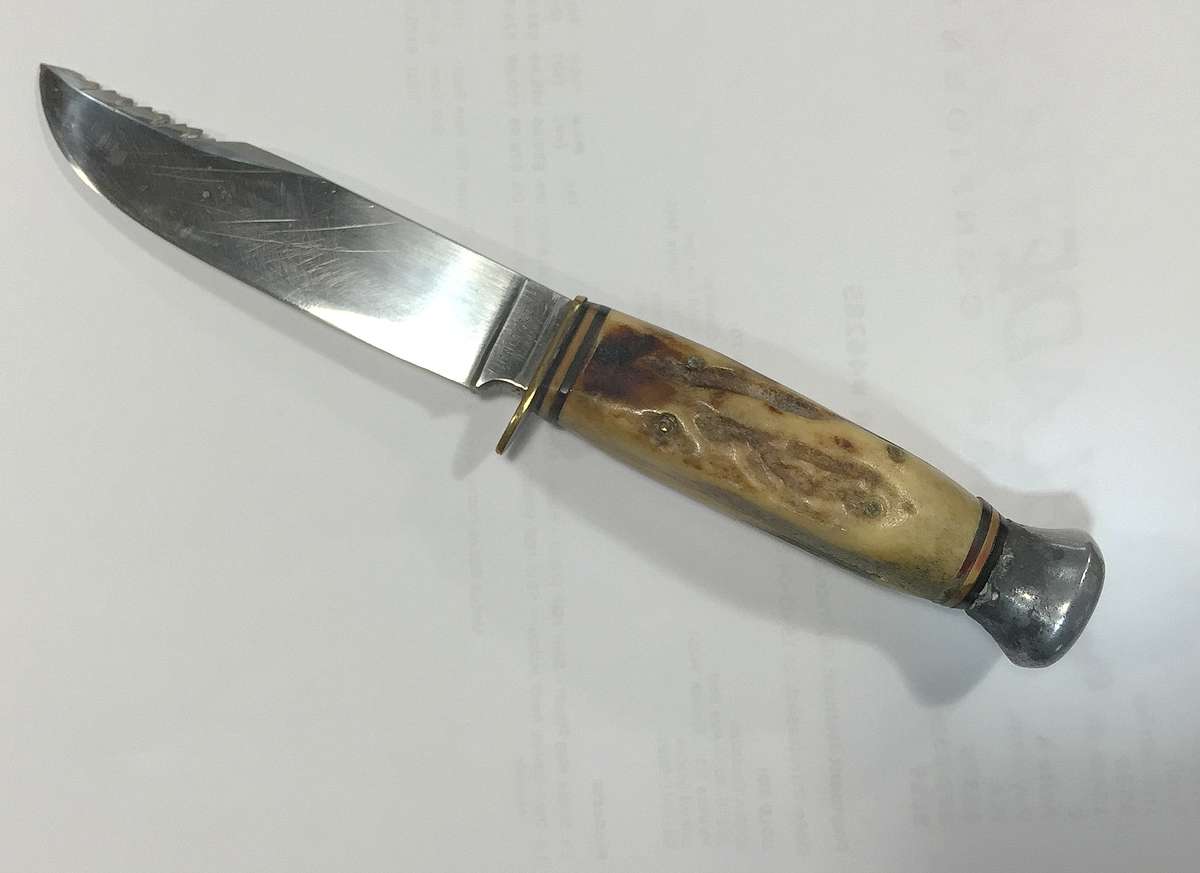

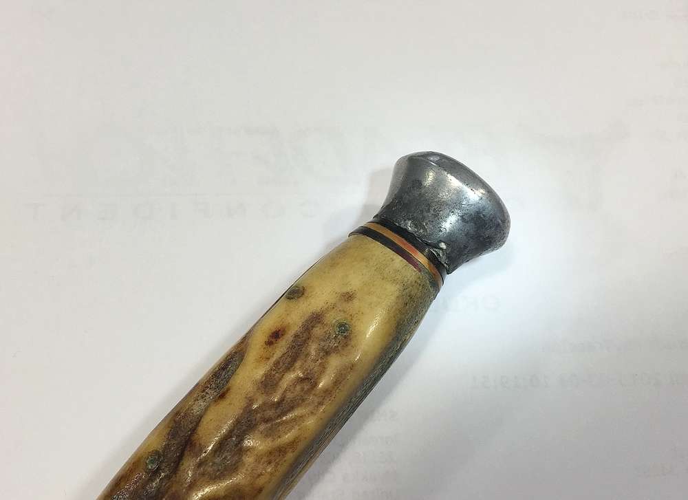

@abbydaddy ---> Thank you for bringing up the K.Tragbar knife, I was looking for more info on those because I have one very similar, made in Germany. On an off-topic note: I don't know anything about those and will greatly appreciate if you, or someone else gives me e search quote so I can learn more about those, TIA.
The reason I'm mentioning my specimen is that this knife saw heavy use outdoor from the unknown to me day it was purchased, all the way to 1995, when my son broke the tip of it. After this it was laying around basically as a paperweight, on my desk, currently "looking" at the computer :D
So while was in use, the aluminum (or whatever this material is) pommel rotten so much from sweat and whatever gets there, so the flat surface facing the horn scales was completely gone and the handle rattles around the tang.
Obviously, in your case it didn't have such problem, I'm only bringing it up because it's an example what happens with the aluminum in hot and sweaty environment, and because I was happy to see another knife similar to mine.
