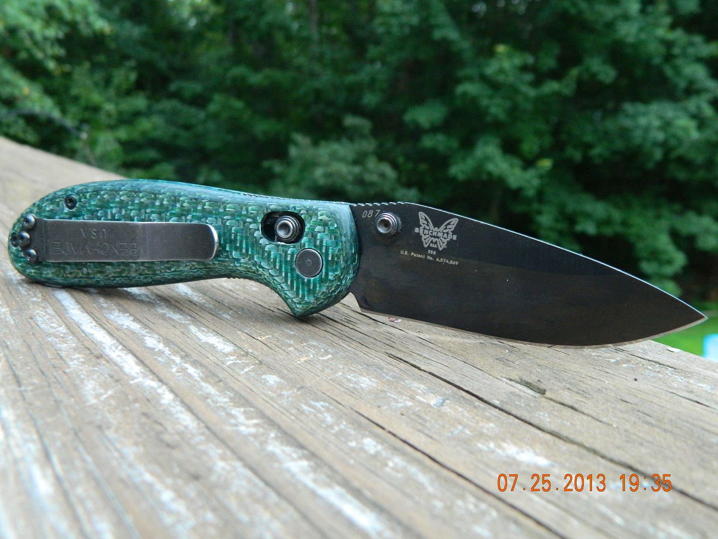

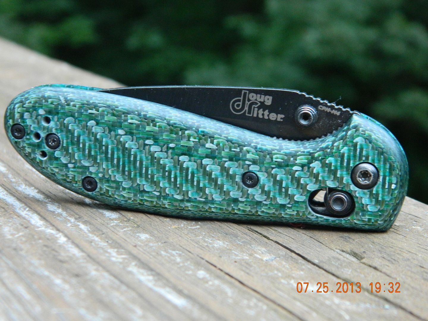

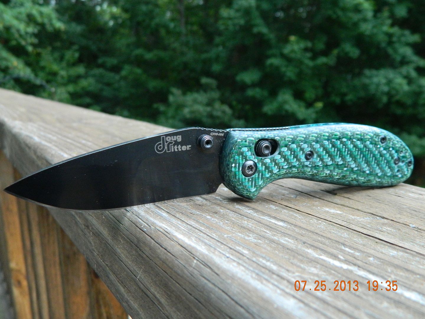

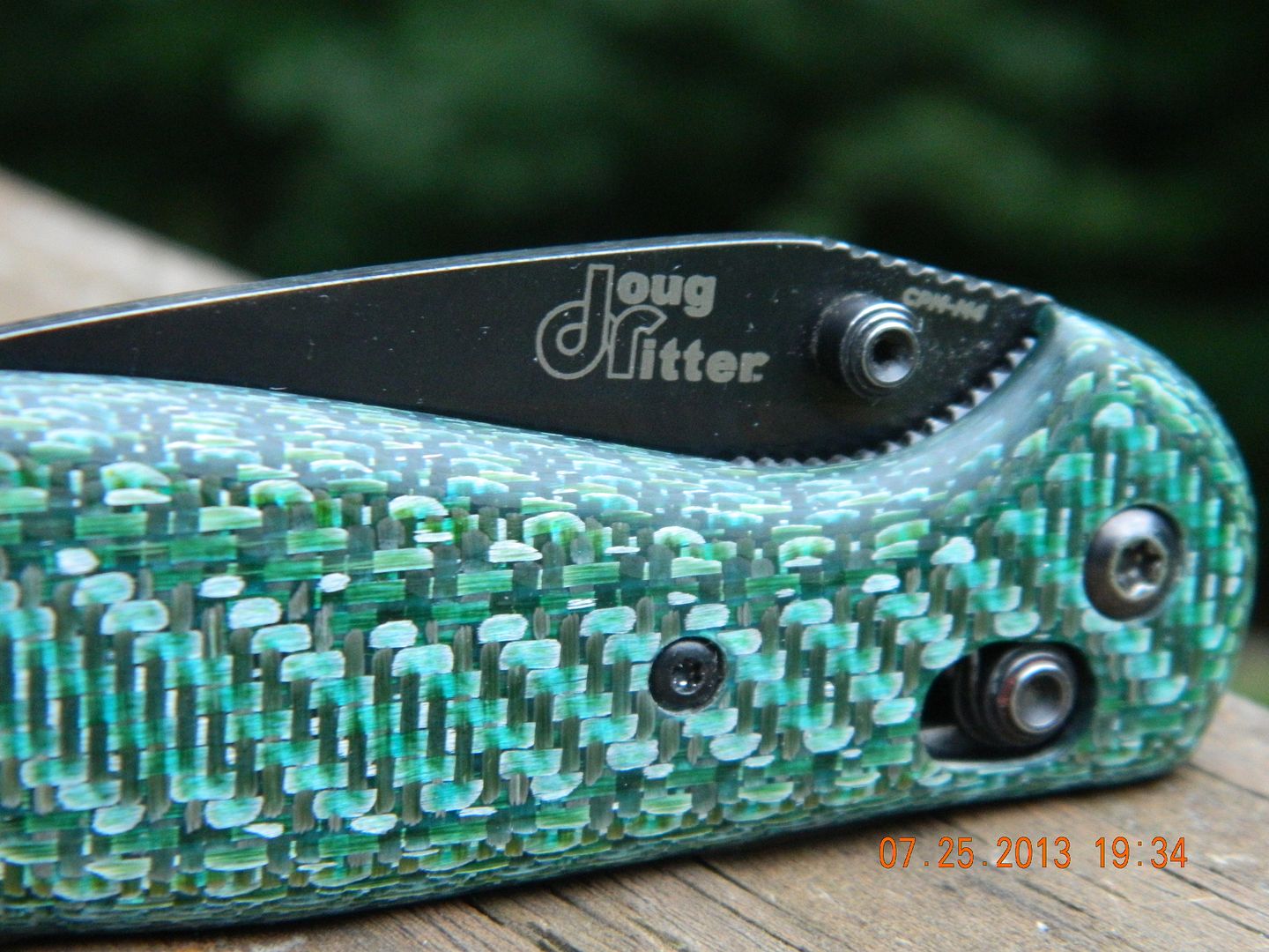

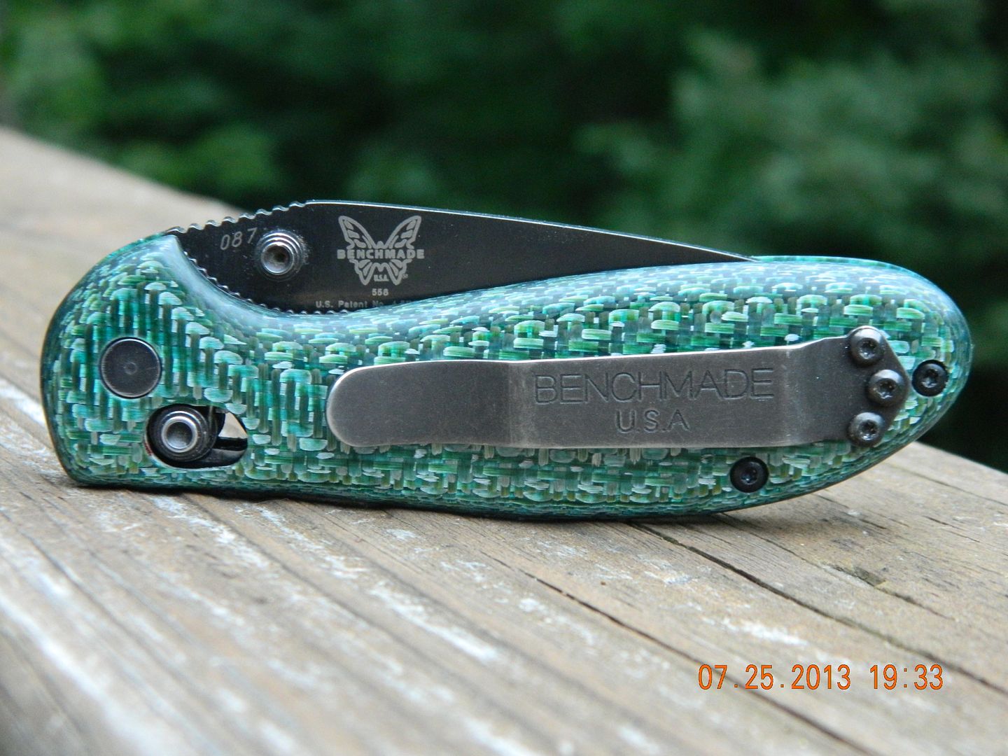

I have my mini Grip here with custom scales from Cuscadi with aero carbon fiber with an aramid layer on top. The clip is from STRs Backyard knives. I love the knife so much more now that it doesn't have the cheesy plastic body.
Spacers are .140 wide and threaded for 2-56 screws. I made those out of a 1/4 rod of stainless steel. If you don't have a lathe, Knifekits sells spacers that will work, but they are not threaded. They're really hard to thread for some reason though, taps really bind and stick. They must be made out of something weird, just be really careful not to break your tap.
Screws are from knife kits. 2-56 .170 long T6 head.

Hey. Thanks for the info. Really helps a lot. I found some on knife kits that are already threaded. Hopefully the threaded ones are the size I need. I guess I'll have to micrometer the stock spacer to be certain, but from the pictures .140 seems like it might be just what I need. Thanks again.
Okay. I Mic'ed my 523's backspacer and came up with .172. Does that sound about right. I found some stand off kits on knifekits.com that are .175. Anyone willing to offer advice? I'm still going to place an order with Keyman, but am just piddling around till payday. Ha!
