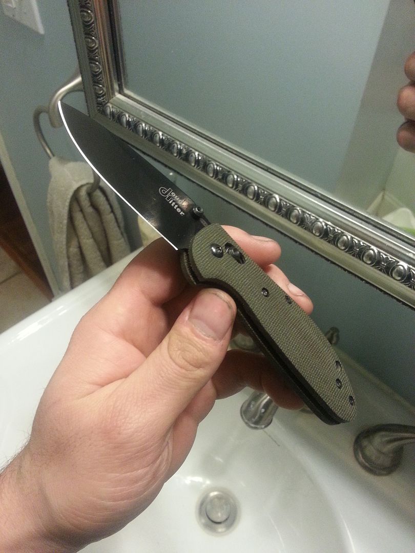

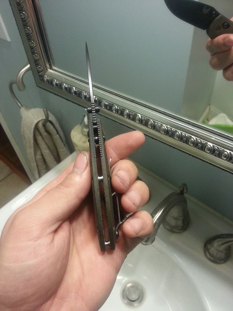

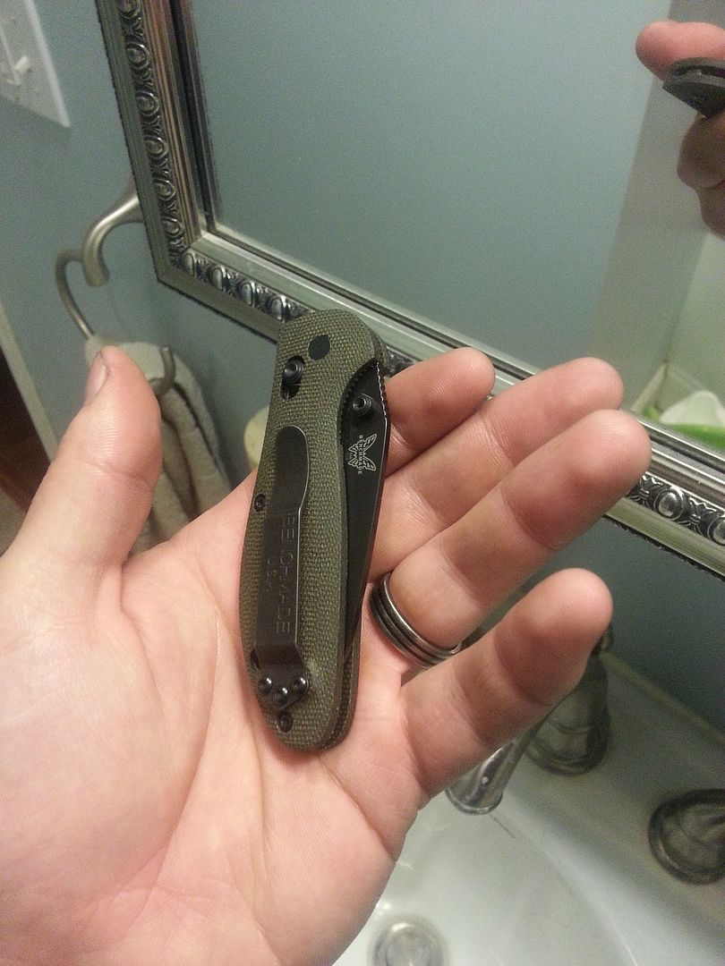

Made a few of these. Full CNC'd OD Canvas Micarta mini Griptilian scales. I like them, definitely keeping a set for myself.
Seeing these just makes me envious that I could be half as talented as some of you guys. Nice work on those micarta handles.
