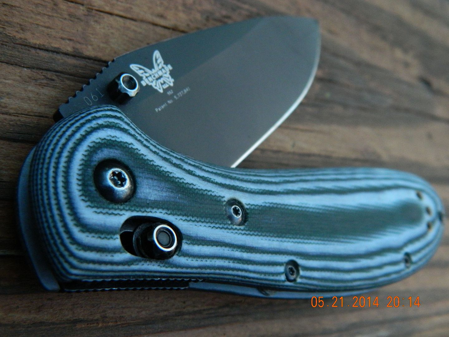

CBM's - Customized Benchmade's

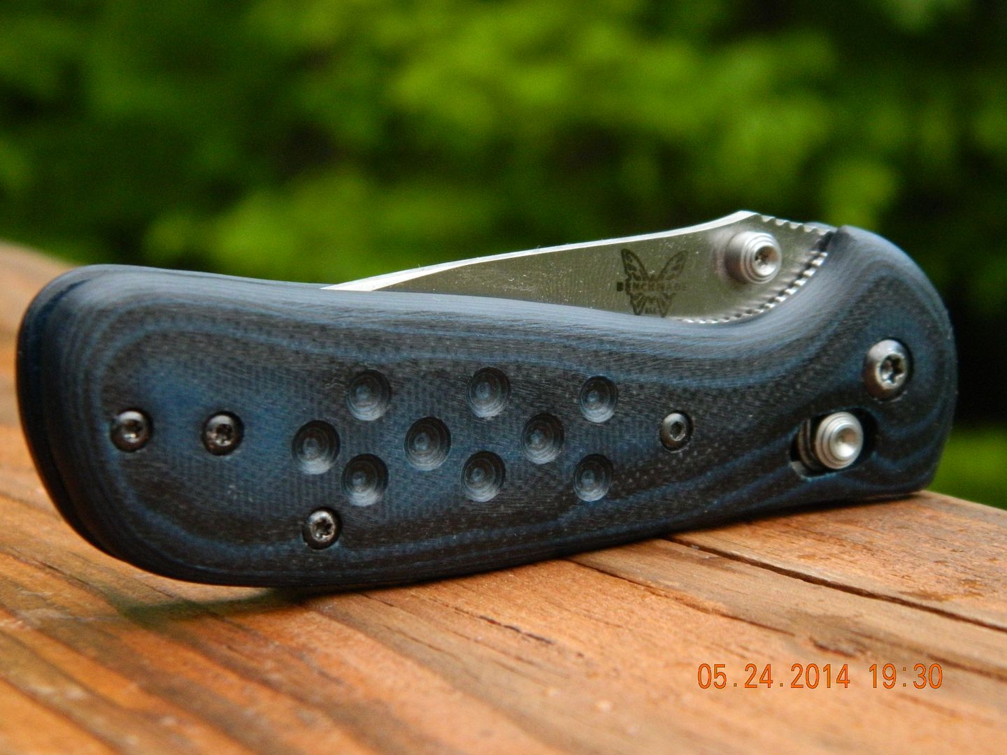

These were recent additions to some other custom acquisitions with Putnam scales. Red aluminum and Blue G10
Now the problem is: What will I do with the rest of the grips / mini grips that still need work?

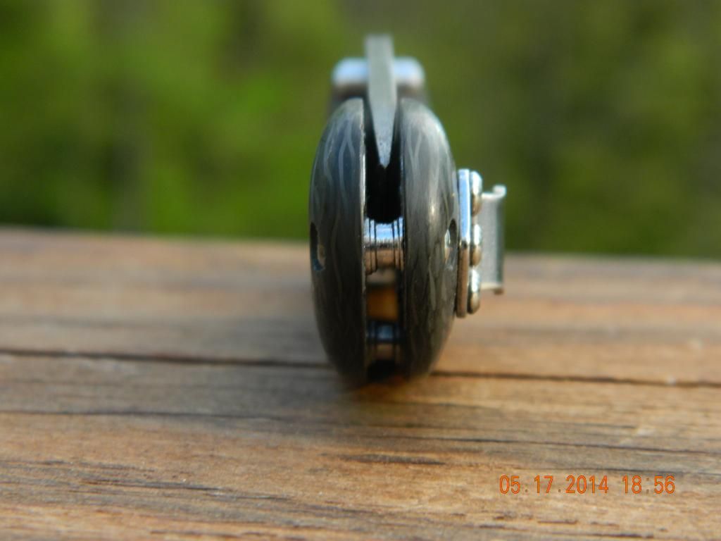

I don't know if any of you guys have already seen this, but it looks pretty cool. It makes a fabric/resin composite like micarta, but it comes out looking like mokume, or damascus. I think that making some of this the way this guy does and puting it on a benchmade would probably be pretty awesome. Its from instructables.com Here's the link: http://www.instructables.com/id/Mokume-Kireji-DIY-Woodgrain-Composites/
IF posting this link isn't kosher just let me know, or take it down. Not looking to step on any toes.

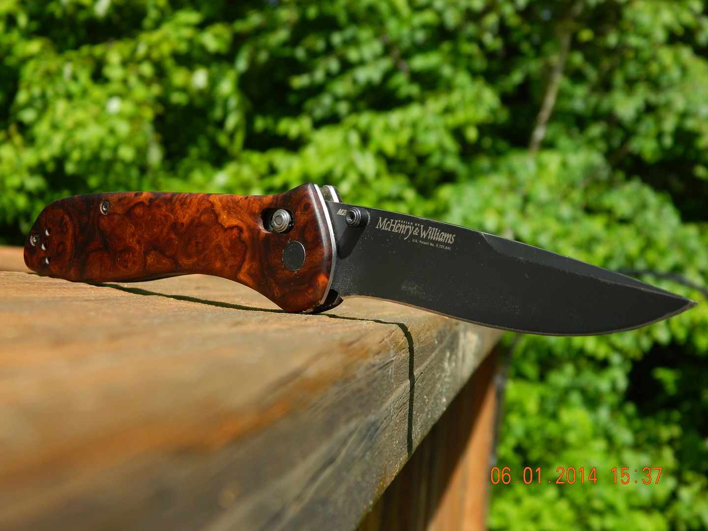

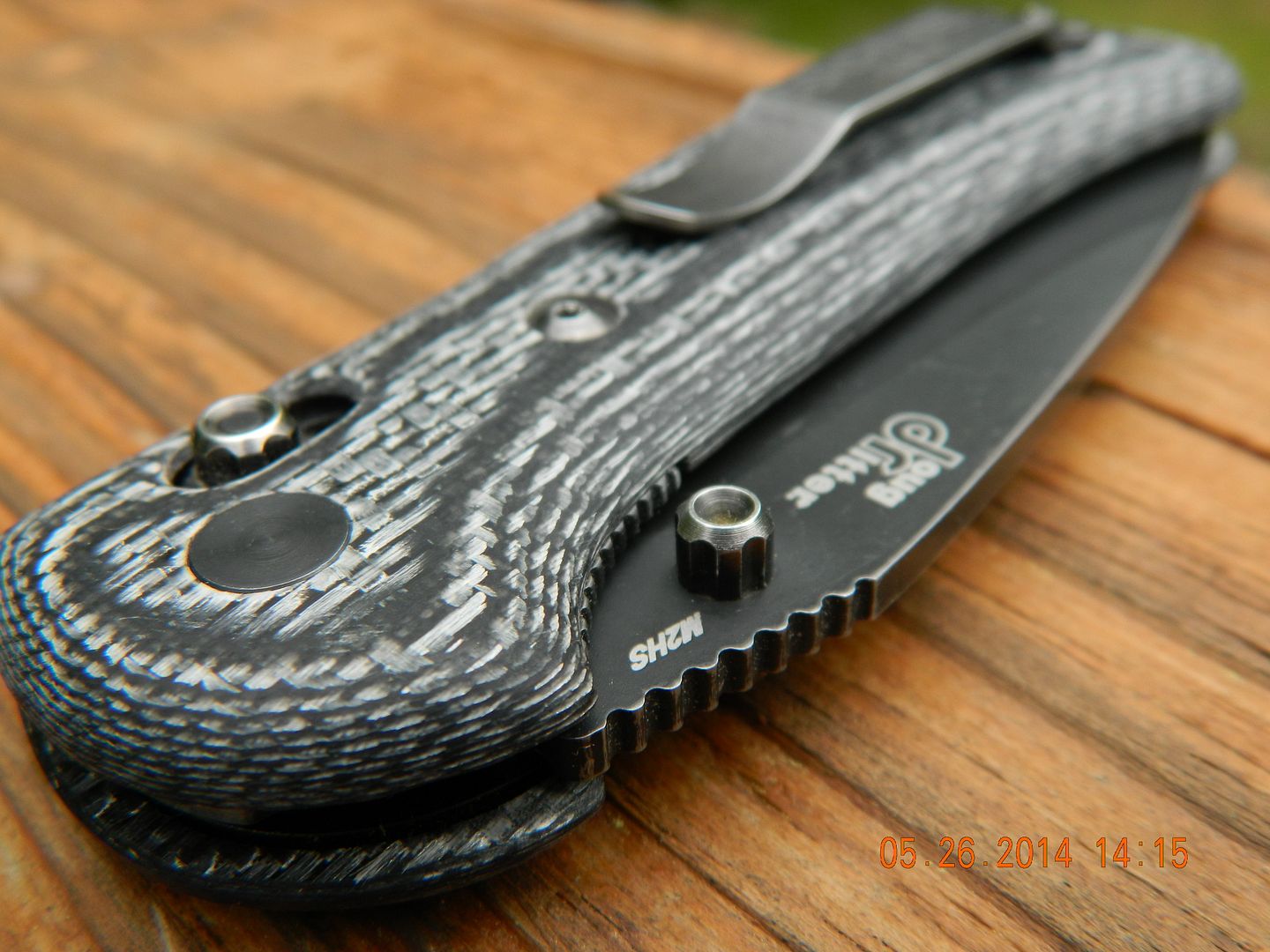

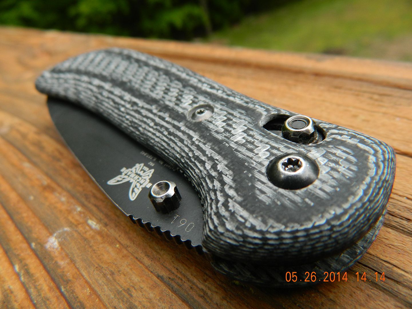

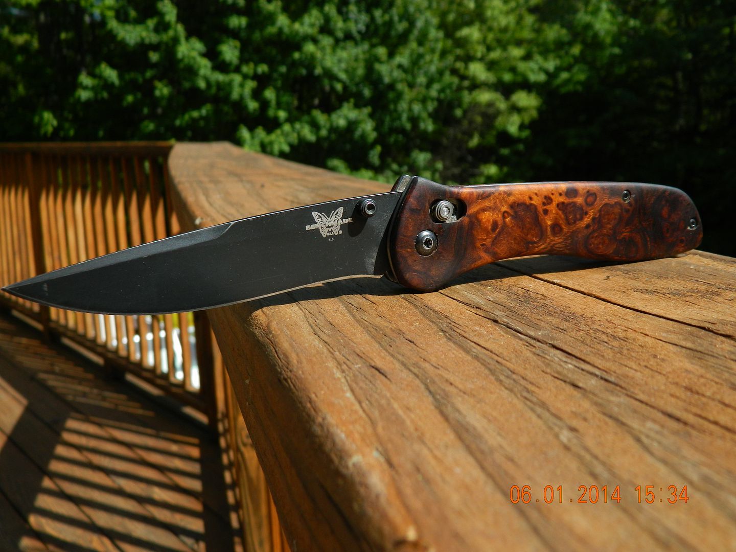

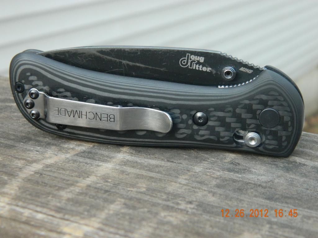

^ Love the new handle profile you've got going there, KM. I also love the worn coating edges on the M2 blade and hardware matched with the black oxide clip. Looks like one meant to be used without kid gloves.
Thanks Professor.
This is my replacement Grail.
It takes the place of the one that I had for years......before losing it last year :(
Pictured below:
and you are spot on.....it is meant to be used.
^ I think you and I may be cut from similar cloth when it comes to a certain worn aesthetic, and no fear of using as intended. I've been known to keep a few spares of knives I really like - I bet you may have an extra as well. :)
D2 and corrosion? Rust schmust. And black oxide clips are like wine with age.
