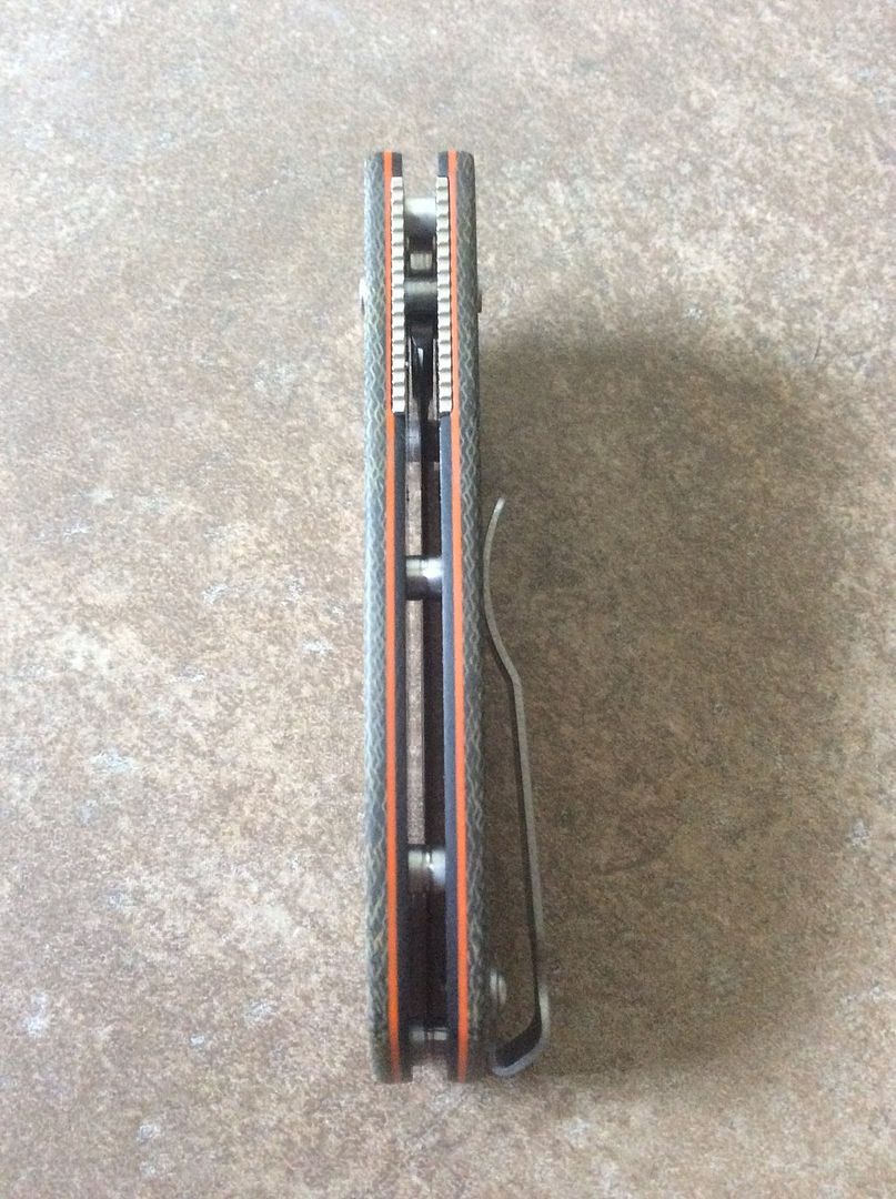

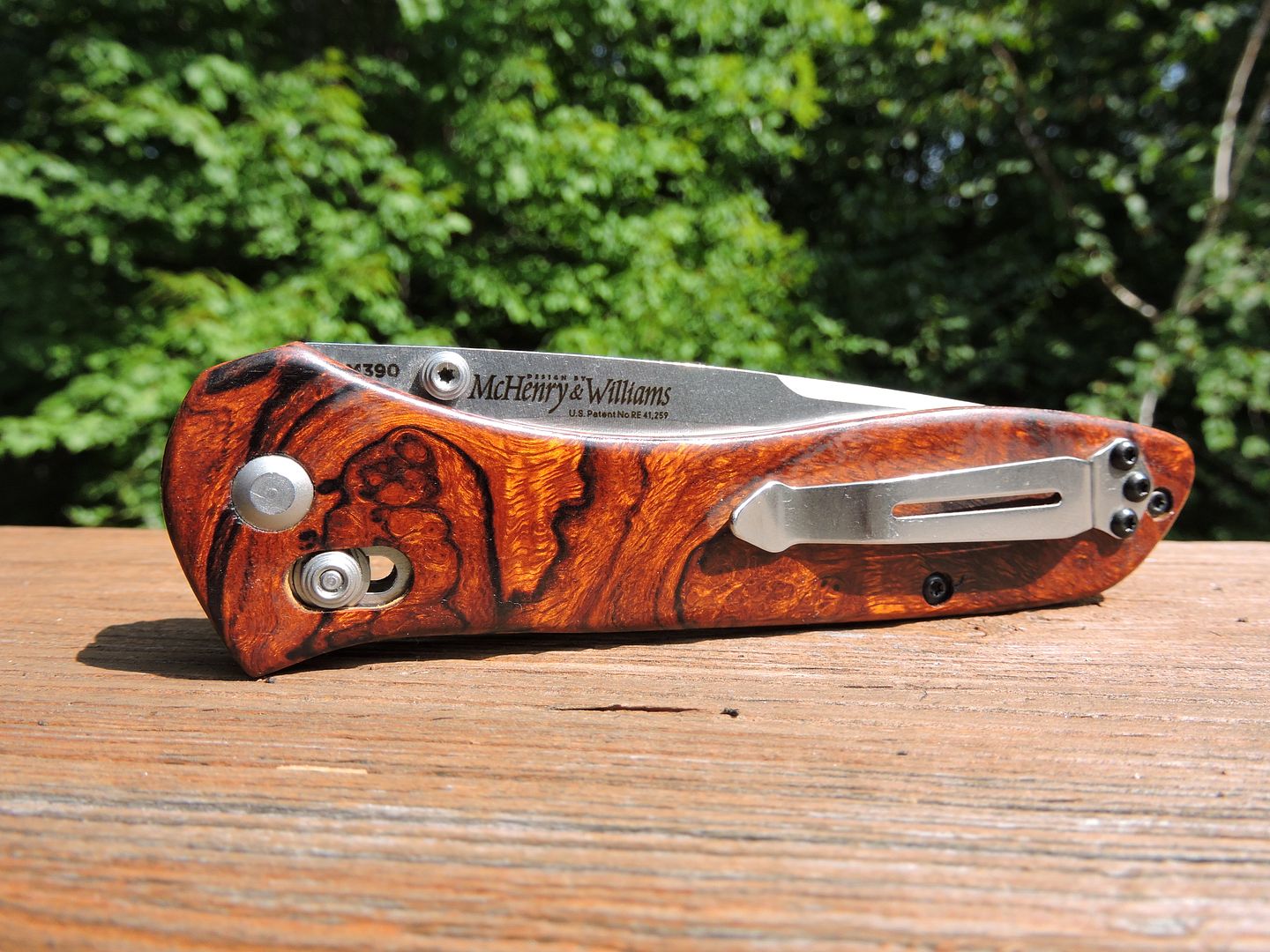

The latest edition to my collection and my most recent modification. Custom layered brass, G-10, and stainless backspacer with added brass pivot washer to match.

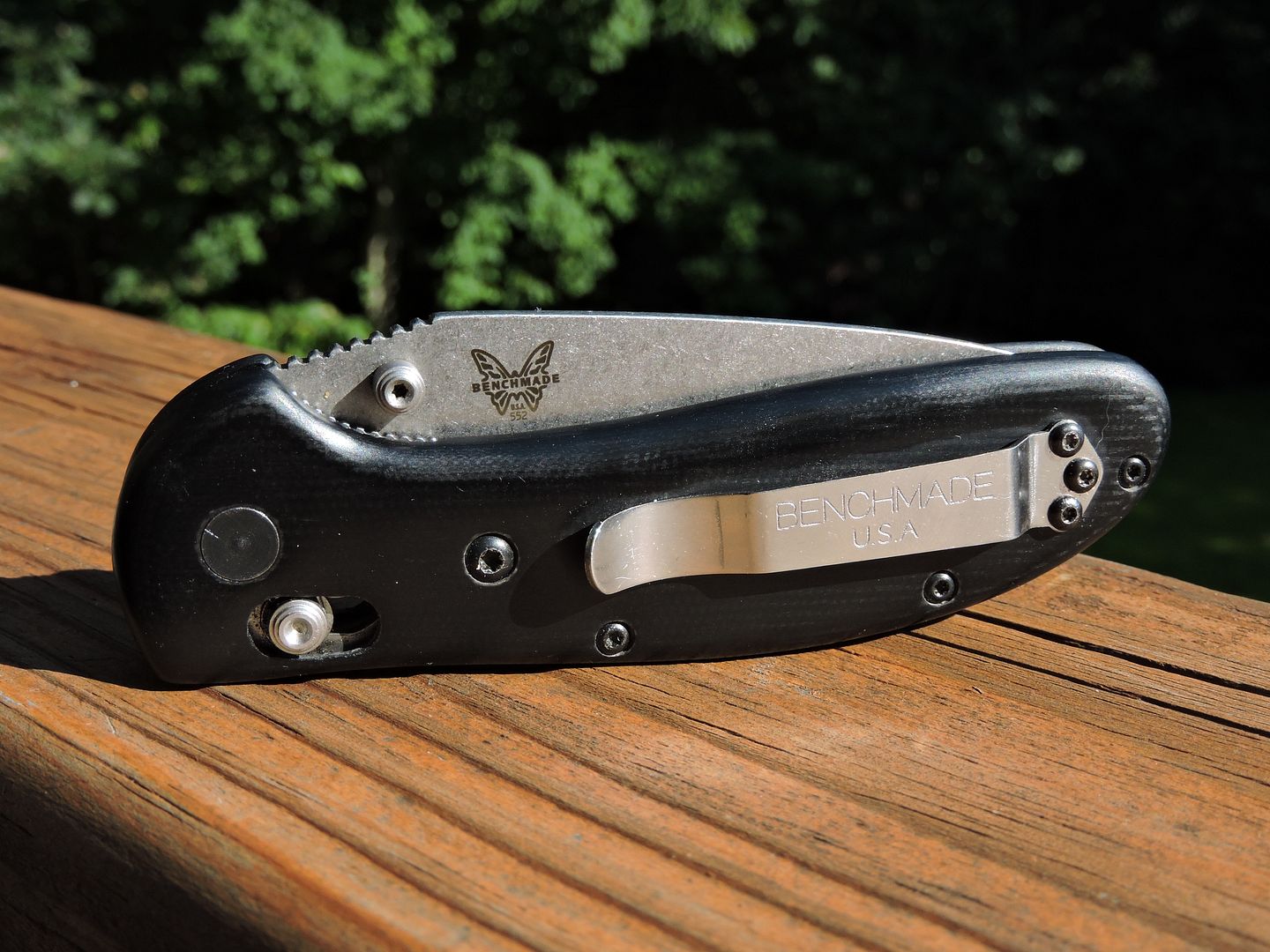

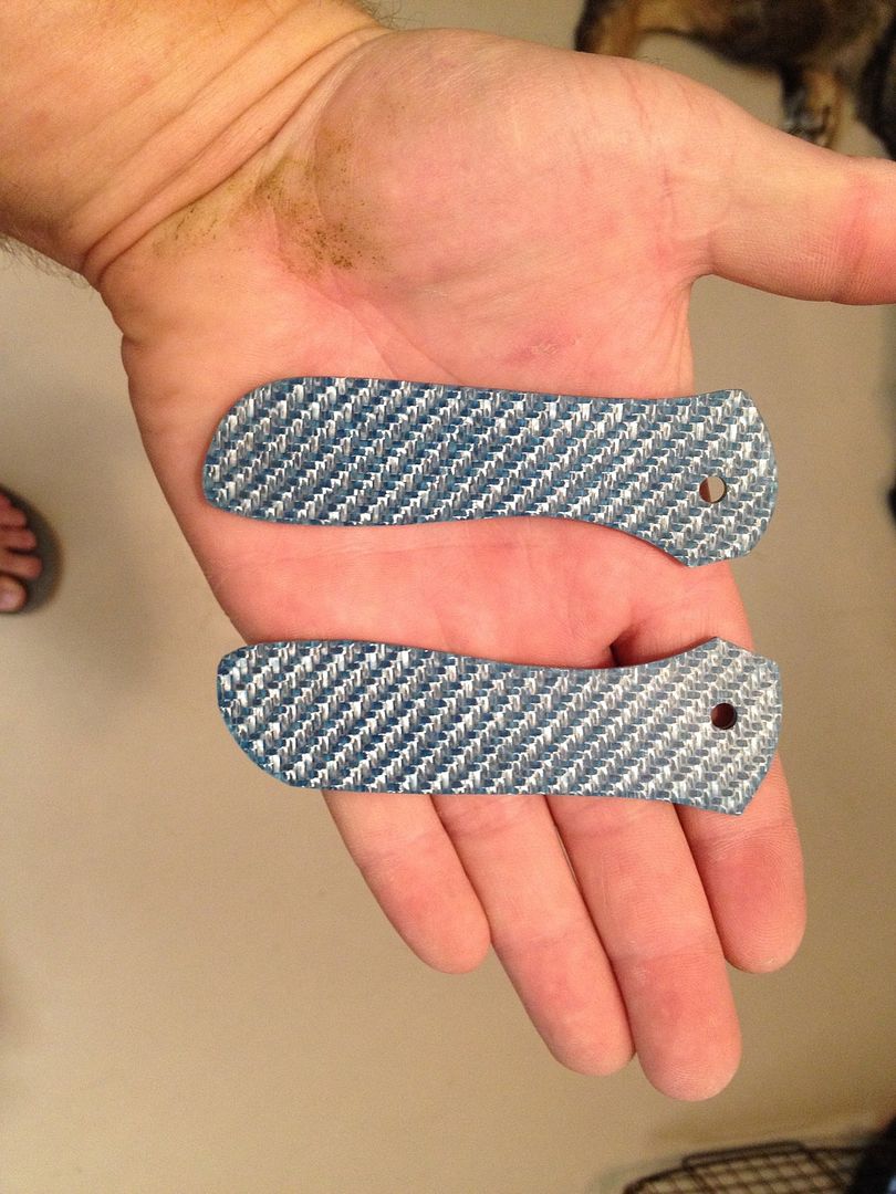

So I bought this junker 943 on an auction intending to flip it or give it away or do a raffle or something after I made some handles for it. However now that I tumbled the blade, resharpened it, made some scales and a backspacer... I might just keep it.
what materials did you use? it looks fantastic!

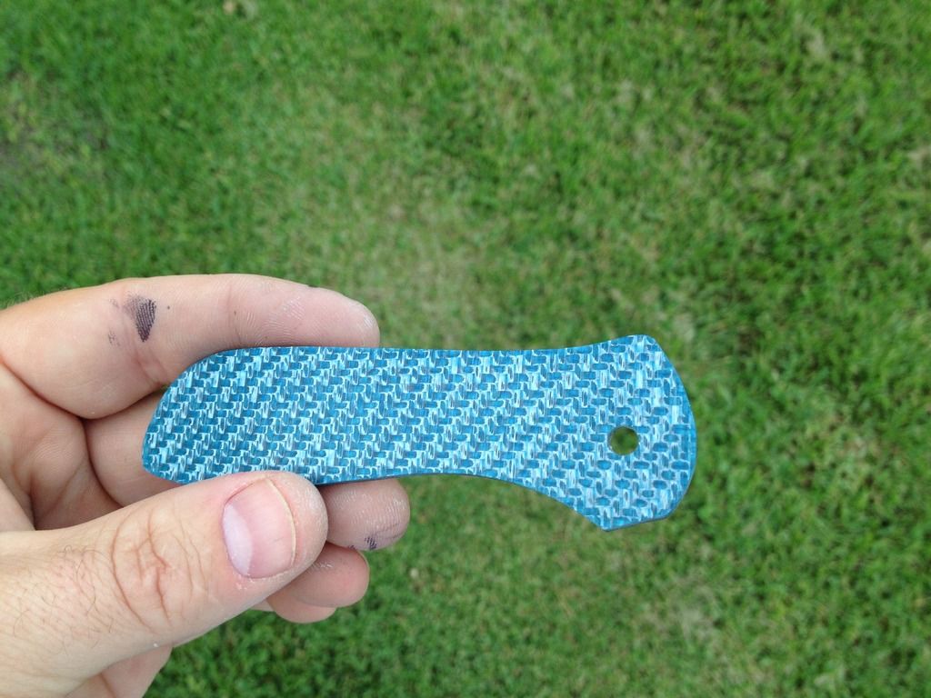

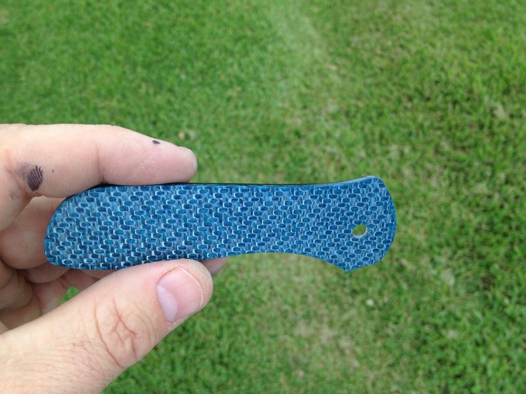

The scales are silver twill. The back spacer is some cheapo CF (not the stuff I use for scales), which is why it has such big wavy lines through it edgewise, then it's sandwiched between two pieces of blue G10. All in all the back spacer was a pain in the butt, but it came out pretty nice.

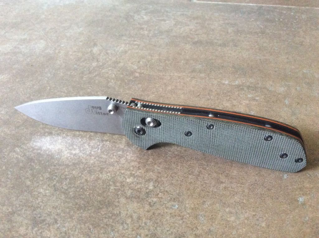

Tightened the dimensions on this one to make it small as possible. Turned the standoffs down to 0.180" and moved in toward the blade. Its pretty compact. Stonewashed the low-ride clip to match the M390 blade. Pretty well rounded EDC.
