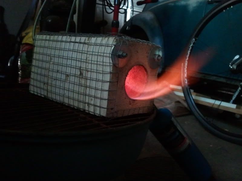

Afternoon fellas! I'm dripping sweat, I fired up the 2BF and made an attempt at Mokume gane again. I made a small jig, it worked ok, but needs to be built heavier.

My little two brick forge running at full heat off a propane bottle, this is what they call dragons breath...

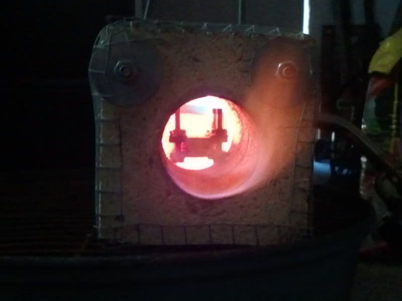

You can see the jig in there, its two mild steel plates with nut/bolts in each corner. I tightened it down as tight as it would go, then a little more.

This is the best result I have had yet! The failures in this $1.00 chunk are due to bing the side closest the burner and got over heated. I prefer to use MAPP gas but was out. With propane I need to leave it in longer and run this risk. When I see it "sweat" I pull it out and put it into a large clamp and squeeze the hell out of it. When it cools to black heat I quench it and take it out. I will grind out the bad spot, work it down with divots and grooves to give it some pattern. I did a quick etch in FC to bring out the copper for the photo.
I'm pretty stoked with how this one came out and know exactly what needs to be addressed for better results.
WOOHOO!!!

Very cool! That is looking great! Nice pics too, that forge is cranking. Nice vortex action, looks like it would work very well.

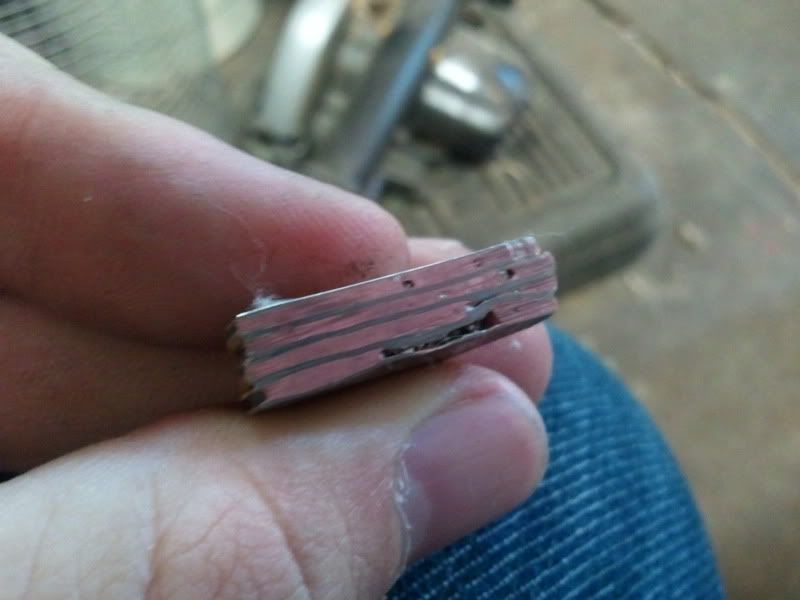

Well my mokume slab was a fail. I errantly worked it too long before annealing again. I got it looking good, but one last hammer blow split all the layers most of the way through.

Ahh... that is rough!
I have always wanted a deeply stamped sterling bracelet (you'd have to see one, I googled them and came up with nothing... local style here on the Res near me) A guy who made them told me they get annealed 40 times for each stamp! stamp, anneal, stamp, anneal... the stamping is so perfect and deep you'd think they were cast but look much cleaner
BTW I did the same thing with my piece, just reminding myself too. :D At least the material is cheap! Keep at it!
