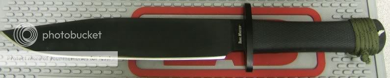

007 when I reprofiled the edge I sacrificed the strength of the factory edge for one that has better slicing. I reground the edge from a 30 degree included angle to about twenty degrees. I have a small belt sander that I used to do this. It made an incredible difference in chopping efficency.
This was my chinese SK-5 close to brand new.
I've done alot of chopping with that blade, so I gave her a well deserved makeover. Not the greatest picture...

Looks like you did some major chopping there Magee. The TM keeps on going.
