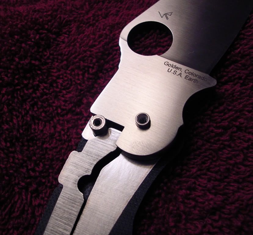

For what its worth for those that have never seen the inside of a compression lock: Para 1:
(Not my picture)
Tri-Ad lock
Unless one would shear out a piece of metal (on the blade or a pin) or accidentally close the lock I cant see anything in normal use or hard cutting chores causing the lock to fail. One thing I would watch out for in any backlock, including the Tri-Ad is excessive blade play (little is ok) but blade play in the Compression lock I dought would affect safety of the lock (one of the few where bladeplay does not necessarily indicate a hazardous lock).

cool thanks for that post, i have a superleaf but i havnt taken it apart,
