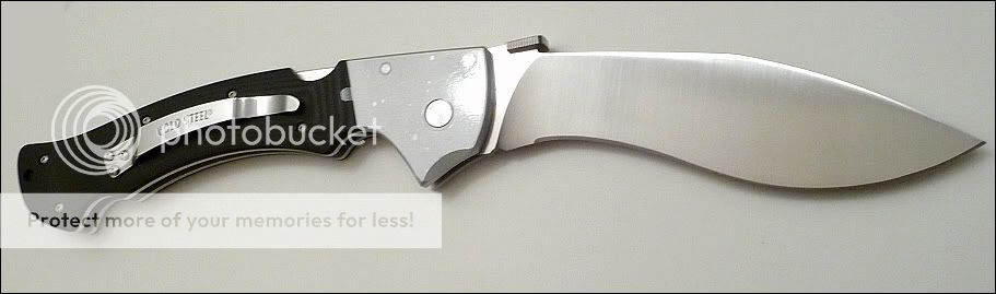

strange just checked out there website can't find a single folder currently for sell with san mai. if you are talking about there aus 8 I got a recon 1 for 30$ so...
That's even worse, they are selling el-crapo AUS-8 as if it was ZDP-189
http://www.coldsteel.com/espadaseries.html
San Mai are in their fixed blade lines:
http://www.coldsteel.com/laredobowie2.html
620 bucks, LOL!
The espada is the most pricey folder on the site.
