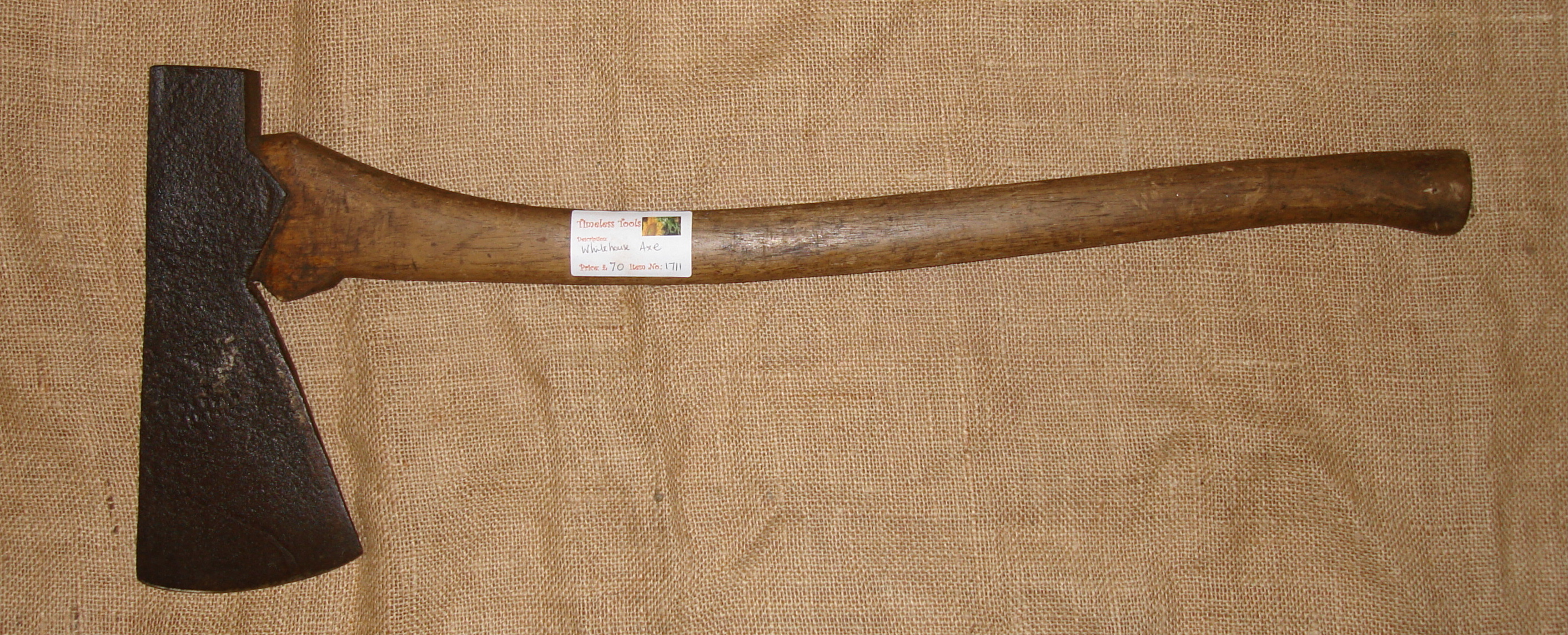

A lot of British axes, such as this mining axe, have very deep bits and despite a fairly sizable poll the center of gravity sits pretty far forward of the eye. You can see that this is accounted for by the offset of their handles, which allow more of their length to still lay along the axle of the tool--so despite the odd shape, axes such as these still are "T" balanced.
Pretty much every style of axe in the world follows the principles in the diagram I posted, they just use different settings to the variables. But you can use those principles to see how the set of the bit, the shape of the handle, the location of the eye, etc. etc. all fall into place based on those concepts.
