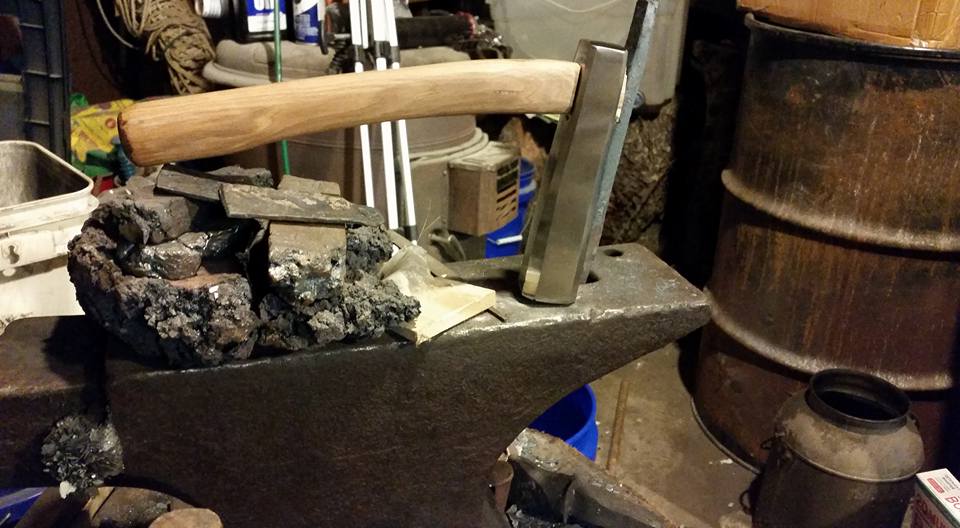

While not an axe, Japanese blacksmith hammers follow similarly asymmetric design and you can see the same principles at work in their execution.
And it is terribly flawed for the same reason as the long bit axe. Study the Hofi Hammer to understand what a blacksmith hammer should be.
Or perhaps it simply operates based on principles you've thoroughly demonstrated that you don't understand...Lots of very accomplished smiths enjoy them.
I have to ask, Square_peg...how much time have you actually spent using poll-less axes and similarly designed striking tools?
It's not an insult. You've demonstrated a lack of understanding of the mechanisms by which they work. By all means elucidate why they're so "terribly flawed"? They follow solid design principles with regard to their angular relationships. They work, and work well enough that many accomplished smiths enjoy using them. What is problematic about them? :confused:
