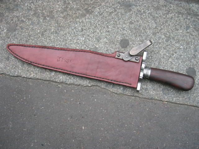

Regarding Shiva's sheath, you mentioned how you made one similar :"I like the look of the 'obviously handstiched' leather and like the design, too. That he hangs the knife at an angle appeals to me. Long ago I used to make sheaths that had a swiveling belt hook on them. I placed the hook at a point on the sheath, so that when the knife was in it, the sheath hung at just about the angle Shiva's is made to do. I like a crossdraw sheath on long and longer blades... so Shiva and I are thinking along the same lines there. The only advantage I see for the system I used to use was that the belt 'hook' on the sheath allowed knife and sheath to simply be lifted off the belt when, say, one was sliding into a truck or sitting in a truck seat. The hook was curved in such a manner that the sheath, or sheathed knife, could in no way be made to come off the belt by accident. You would have gotten a chuckle out of seeing me test those rigs... jumping up and down and up and down and running over uneven ground and jumping up on stuff or down into ditches... all in an effort to get the hook (and knife) to come off the belt. But it didn't. ;-)"
Any chance you have a pic of your version? It sounds like the style I'd love to have made for more than one of mine! :D
If not, mind if I use your description when I do seek to have one made?
Thanks!
Hi, Joeshredd
I think I do have a pic somewhere but am in the process of moving from where I currently live to another house my wife and I own, so have no idea where the photo is at present. IIRC, Flavius started a thread a number of months back in which he posted some pics of knives he'd been able to see and handle at a knife shop in Paris that is run by friends of his. Name of the shop escapes me right now, but Flavius will remember. Among the photos posted was a big Damascus Bowie that I made around 1982-83, and I believe a sheath of the type you mentioned was shown in a photo along with the Bowie. I'm not sure the hook is visible, but may be wrong on that. I'm pretty sure you can see two fileworked 'nuts' on the front of the sheath that are threaded on flathead bolts that run through a metal reinforcing plate on the back of the sheath. The 'belt hook' is attached to the reinforcing plate via a swiveling rivet.
If our lazy, good for naught friend, Flavius can't find that photo for ya, I'll try to scratch one up somewhere.
Feel free to use the description if you're having a sheath made. I always really liked them and hope you will, too.

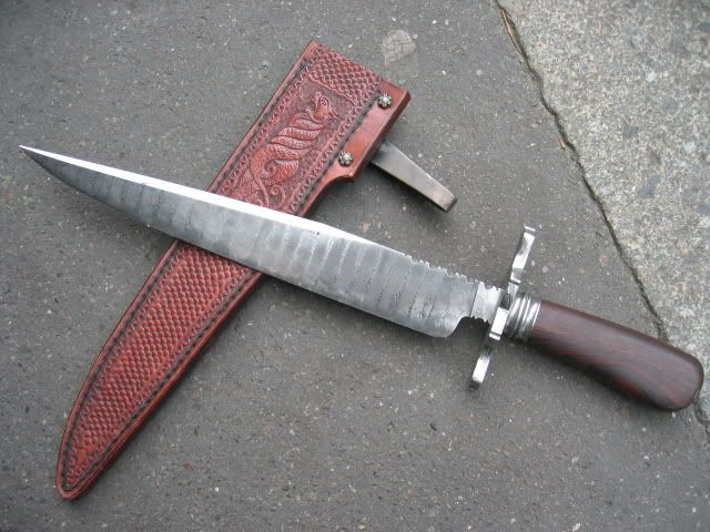

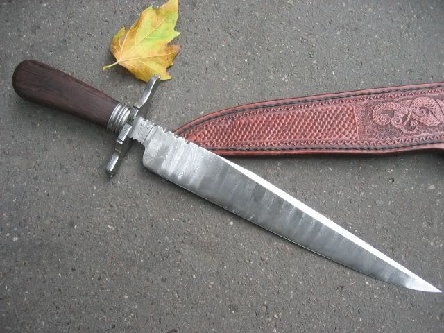

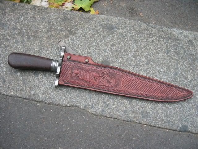

I found a link that should work, too. Look for the sheathed Bowie on this page which shows a few knives of mine made over the years. The 'belt hook' is up behind the Bowie guard at an angle. The hook curves downward far enough so that the bottom is well below the pivot pin (not visible in the photo)... and that's what keeps the sheath in place during movement.
http://www.fototime.com/ftweb/bin/ft.dll/pictures?userid={3F131C61-974D-457D-B1A6-F948F3E15FC6}&AlbumId={B05E2C94-FA0F-444F-ADE9-DB2296FDB32D}&GroupId={1B766819-4B3F-4A18-A886-42F22773F5F8}
If the link doesn't work, I'll try something else.

I have to do all the work :D
Thank you, thank you, thank you for the photos. But you're wrong about YOU having to do all the work,my friend. It's you *and* Maggie who have to do all the work! :D
Oana and I are so very lucky. :thumbup:

Flava and Leatherbird,
Thanks for providing the info on that sheath! It wasn't exactly what I was envisioning, but I really like what you've done with that carry method: Medieval comes to mind, but since I admire the mechanical artistry in a lot of what took place during much of that era, understand I use 'medieval' in a very positive manner! :thumbup:
And coupled with that style blade, I'd imagine that to have been a very functional tool and carry method.
Thanks again for taking the time out from what seems to be a very busy time in your life at the moment to answer my Q's...
