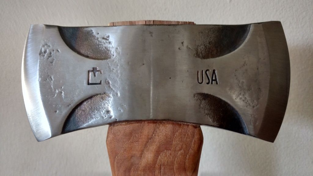

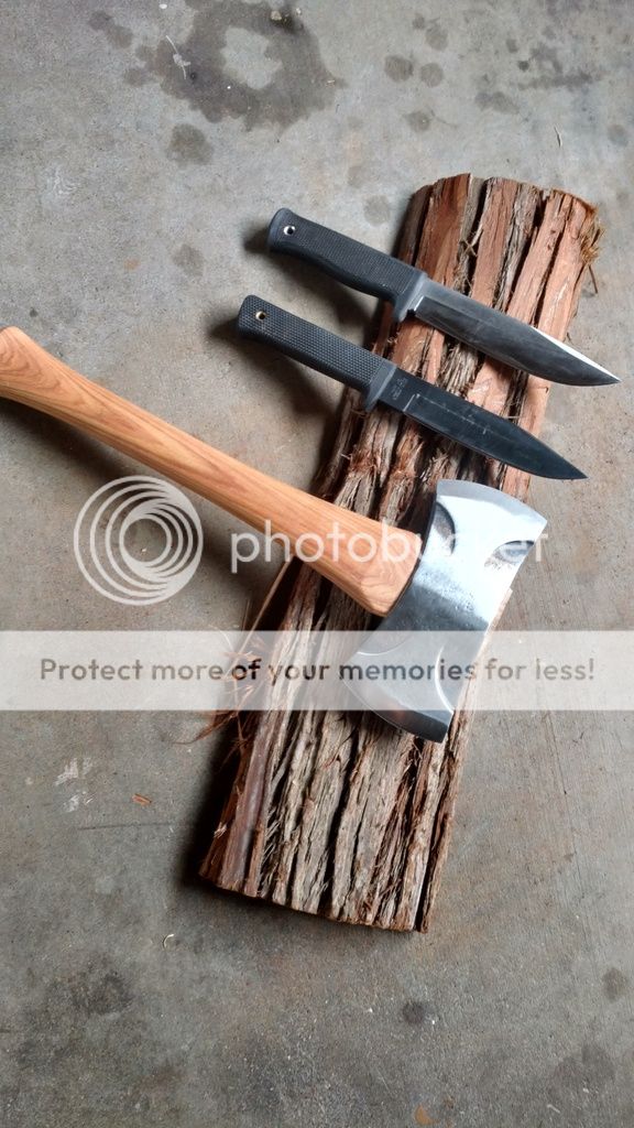

Designed by Craig Roost and made by Council Tool in their premium Velvicut line .
The Council Tool Saddle Axe.
The finish is absolutely gorgeous in person.

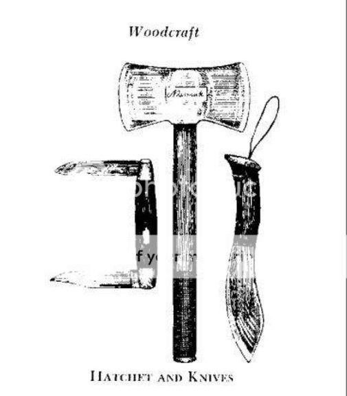

The Saddle Axe is inspired by " Nessmuk" his classic Double bit hatchet from his 1884 book "Woodcraft"
There is plenty of information about Nessmuk so the focus of this review will be about the CT SA
This will be more of a user review.

Here my unboxing lol

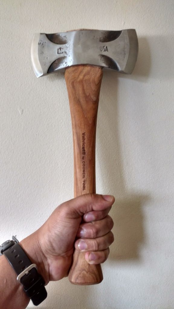

I can tell you that this is in between a house axe and a heavy hatchet.

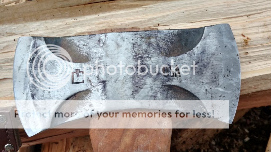

I'm currently checking testing this axe since I just got it today.

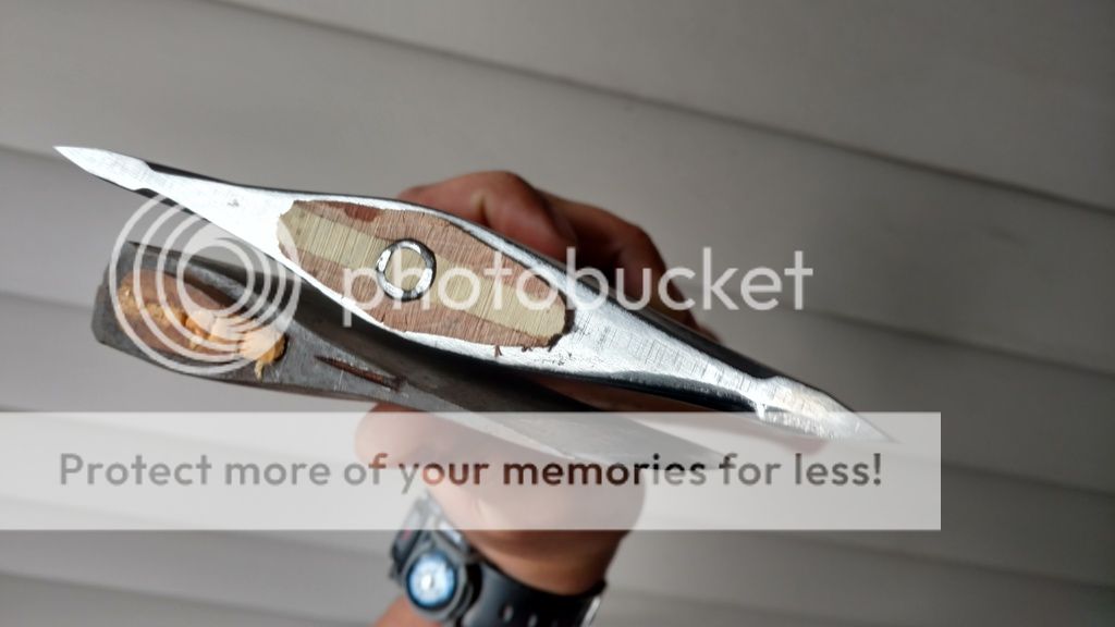

So far it's definitely looking like a winner the flat grinds are a success.

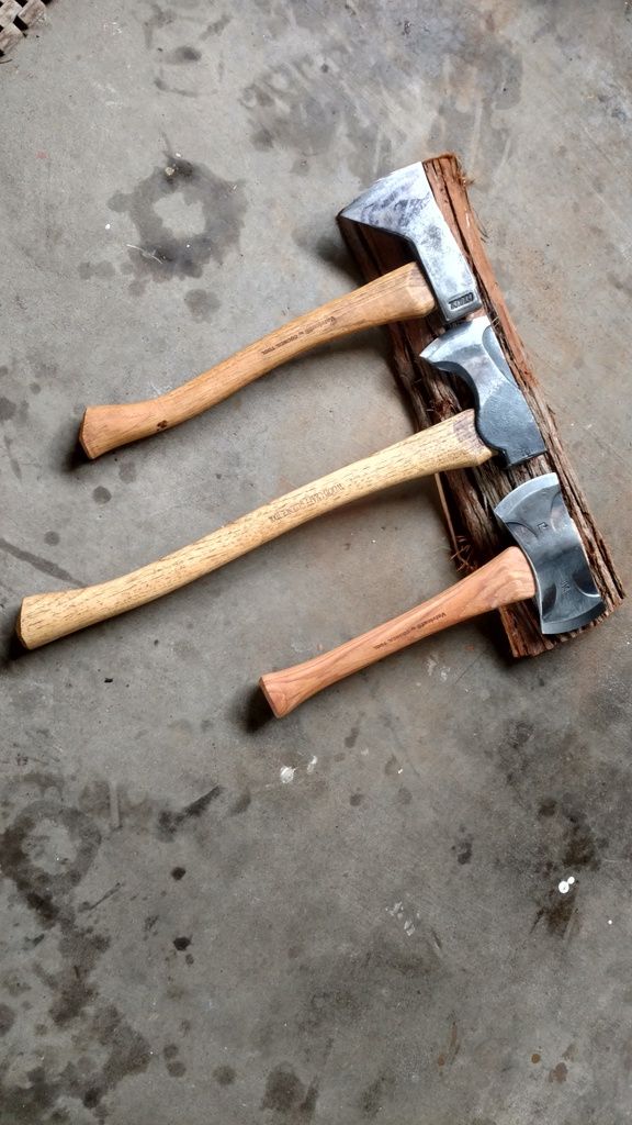

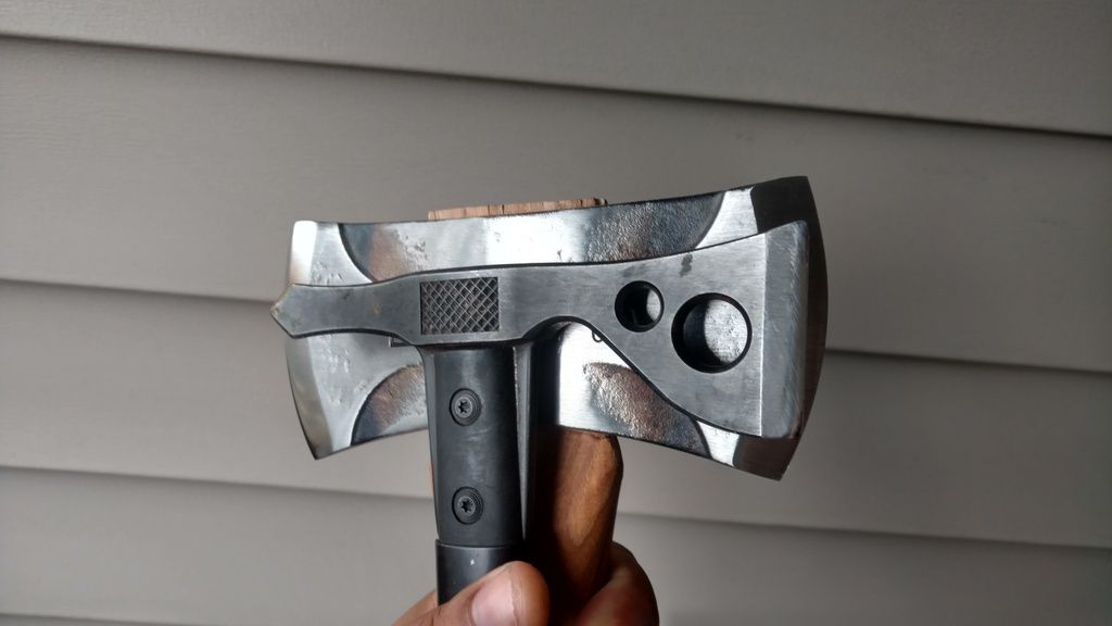

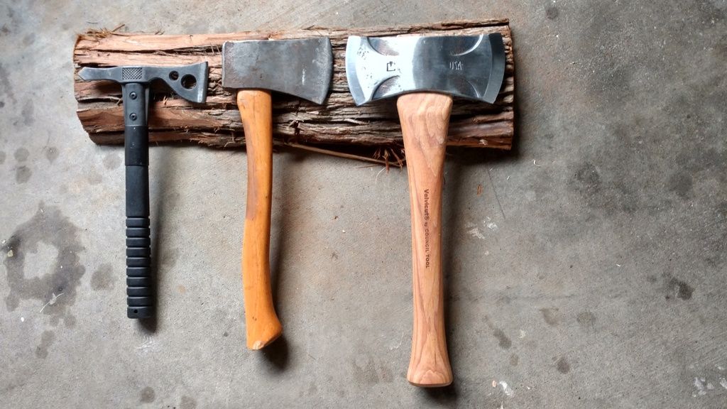

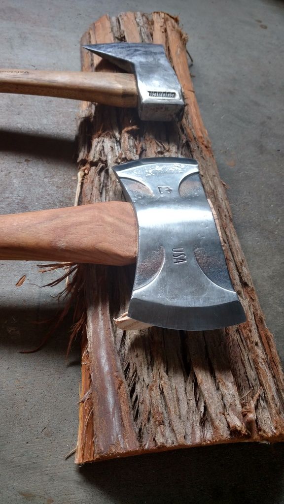

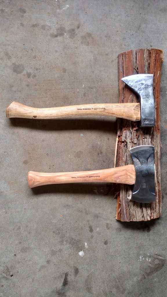

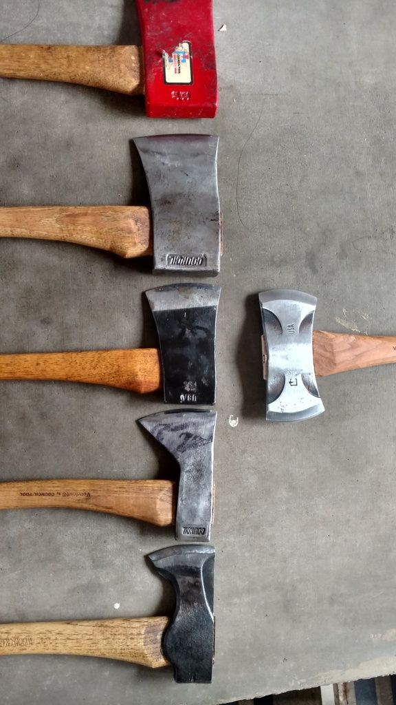

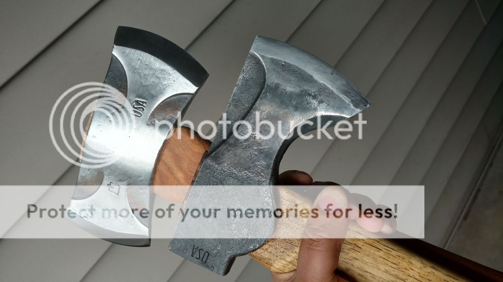

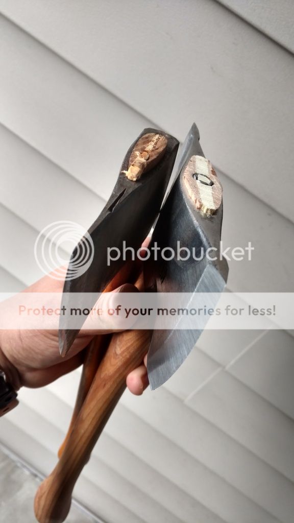

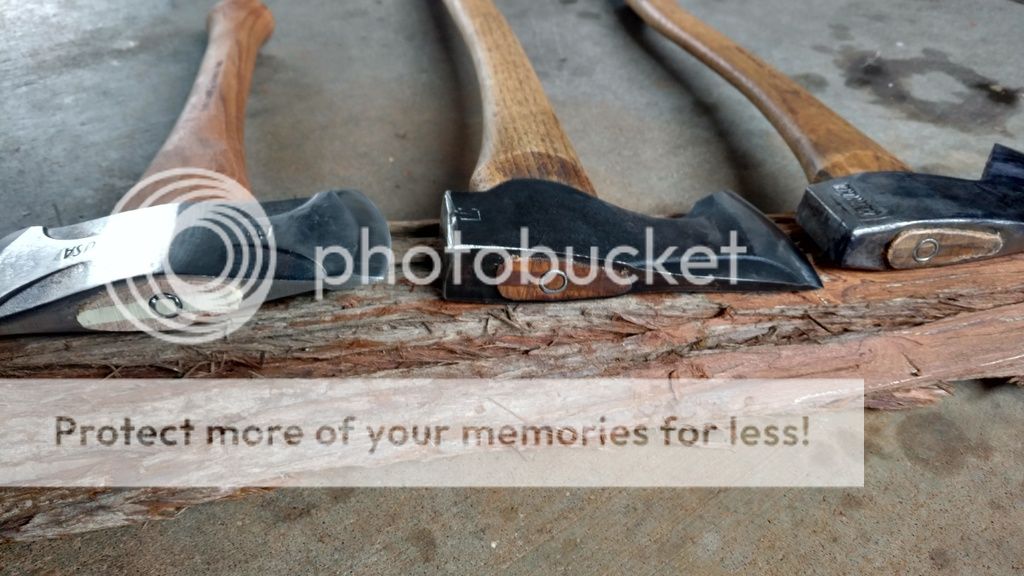

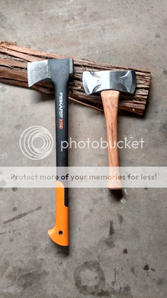

Here are some comparison pictures to other hatchets I own,
I'll get some video footage in here soon and more comparisons to all the different axes I have later
I'll also get some designer input from the "Rooster" himself and pick his brain about the design.
Should be fun, I am very excited about this axe.

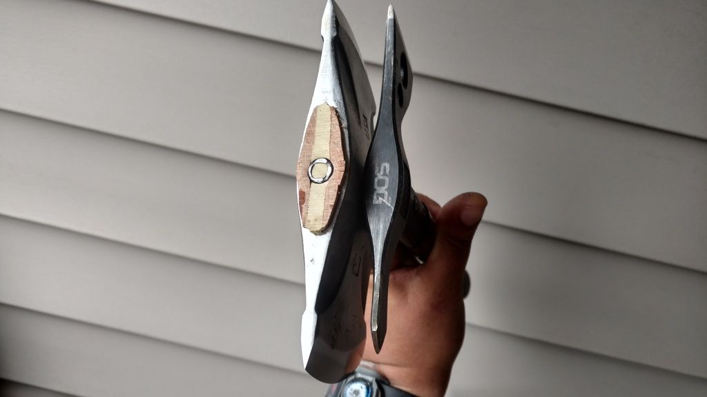

SOG fasthawk, 1.25 lbs swedish hatchet, CT SA
Much more powerful geometry on the SA
I share all the details when I get more time, lots to talk about.

The Saddle axe is about 2lbs

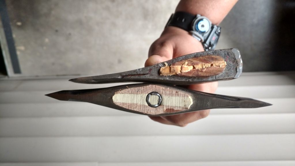

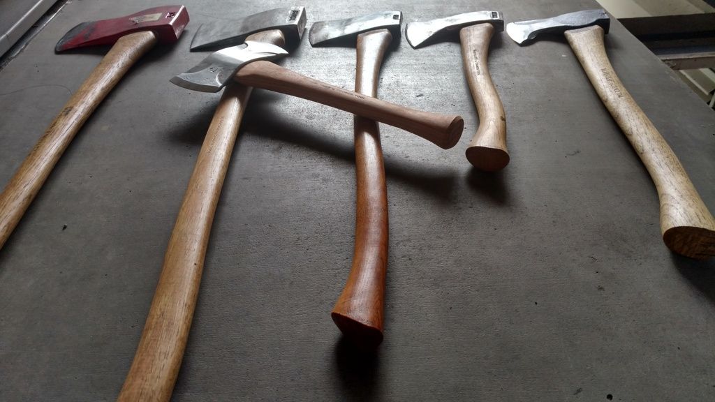

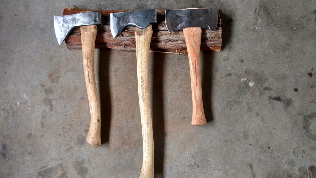

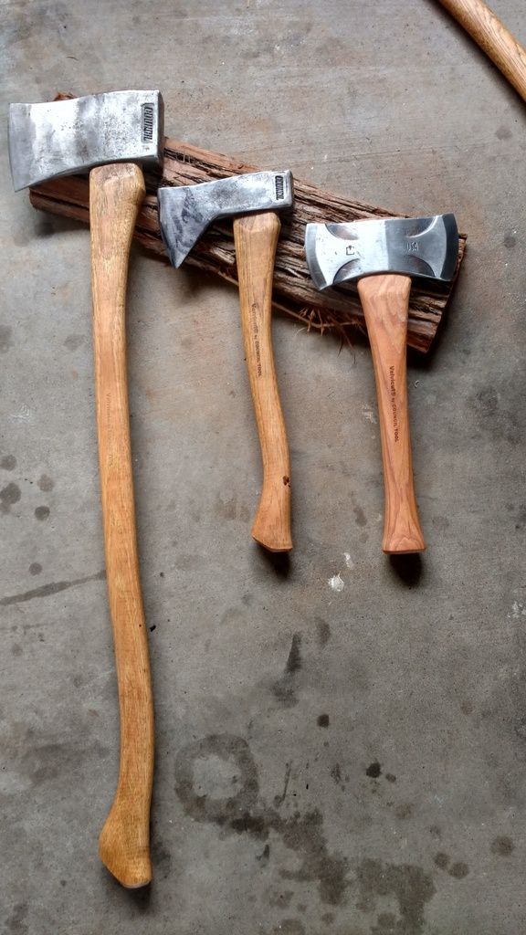

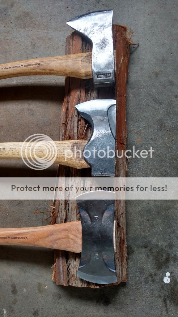

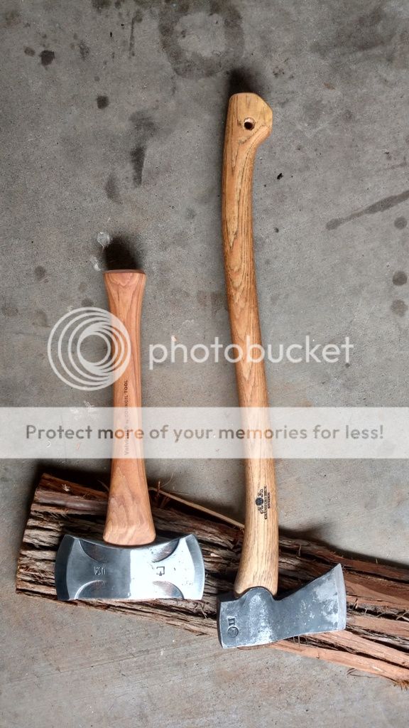

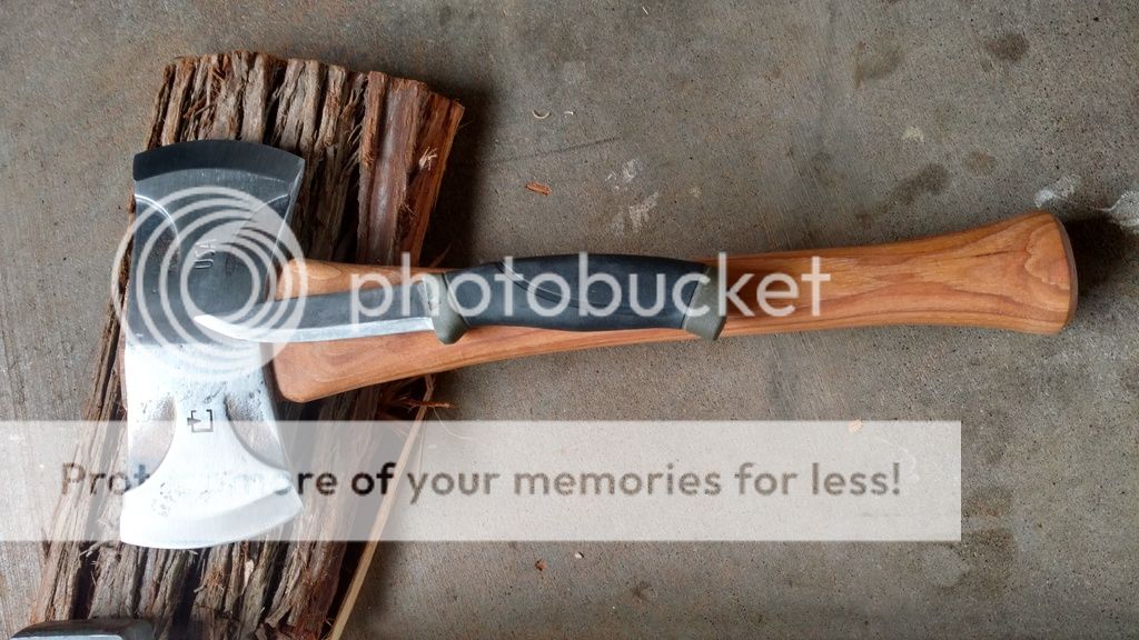

Here is a 19" HB compared to the SA
Here is a Woodcraft with a 24"
I'd be down for a bigger handle but I like the role it fills with the current handle.

I have always referred to axes that were full size(3 and a half pound or more) on handles shorter than a boys axe handle as a house axe. For splitting literally in the house. It is nice to see you splitting with it. I too would like to see this axe hung on a cruser handle with convex grinds.

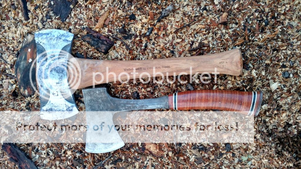

Another next to a Plumb scout axe for scale.

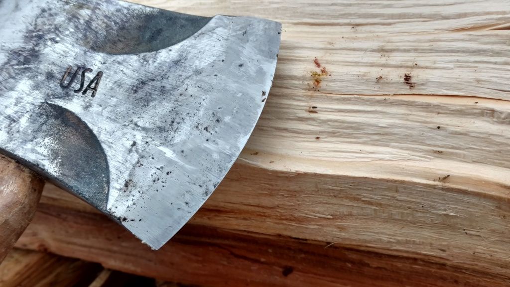

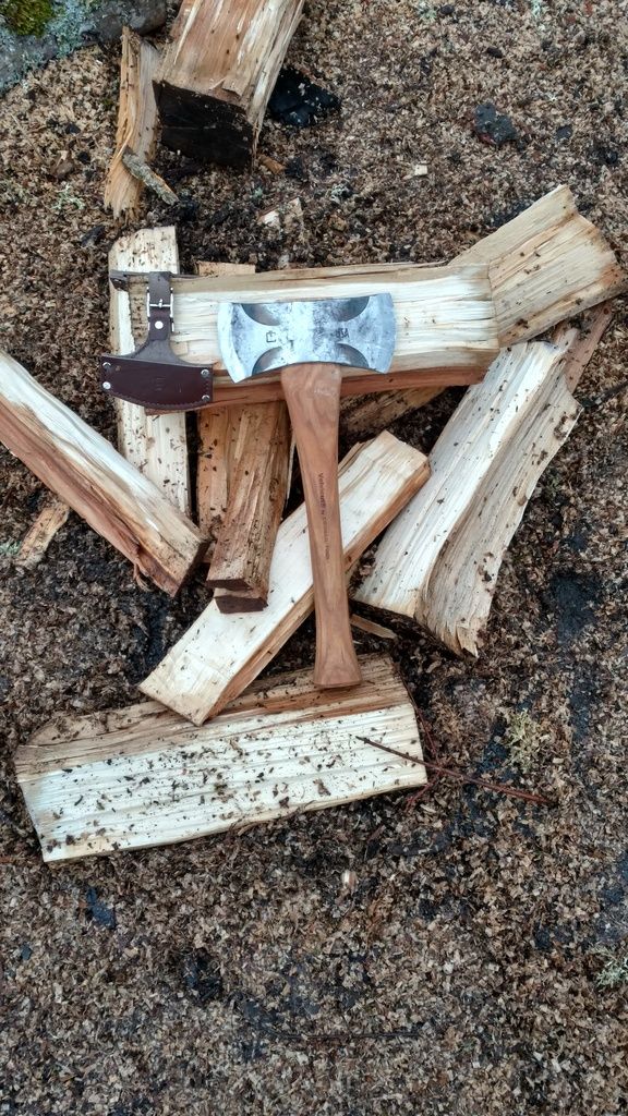

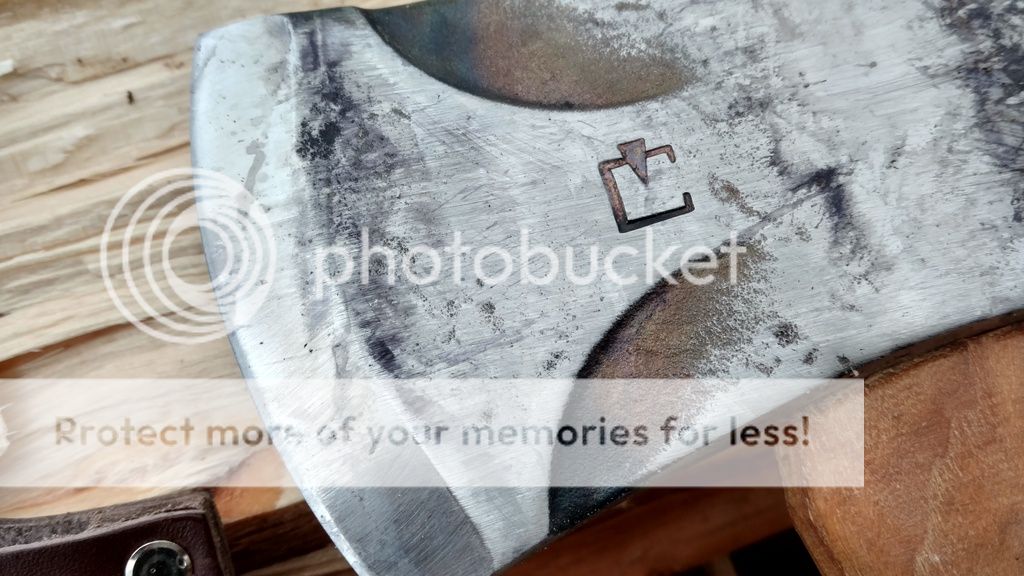

Day one, I really enjoyed the flat grinds. Held up good. Great bite,
I did not go easy on this axe I punished it with some chopping and splitting knots and it did great. I recommend people give it a try before they come to conclusions. Still need more swinging to fully evaluate.
I don't know how it handles smacking the dirt but that's not what I test.

Interesting I suppose that Velvicut Hudson bay would feel more like a house axe. That thing feels really "weightly" on a 19" haft
It would feel at home on a 24" but might be too light for a 28"

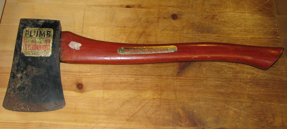

Squarepeg, are you sure about the weight on those Plumbs? The 65 catalog has them going in half pound increments from 1 1/4 to 2 1/4 skipping over two pounds. Handle length longer with each increase in weight and the House axe also listed with the Hunter's model. I thought the earlier Plumb House axe was 2 1/2lbs with a full size eye.
I'm speaking a generality about house axes, 2 pounds +/-. I haven't weighed these axes specifically. The one shown with the other hatchet is very slightly smaller and thinner than a Plumb boy's axe head which weighs 2.36 pounds with a broken haft in the eye. And who knows, maybe this boy's axe head was origiinally sold as a house axe.
1-3/4 or 2-1/4 pounds is in keeping with my statement of 2 pounds +/-.
