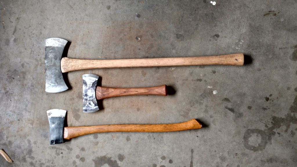

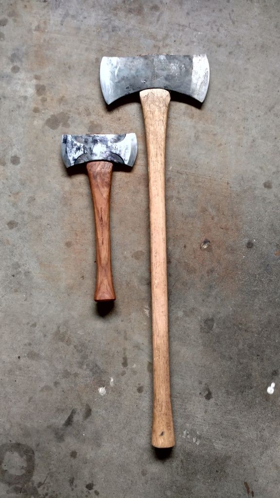

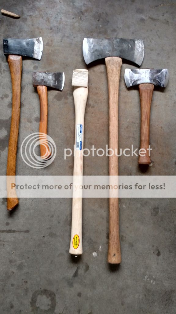

From my experience swinging and holding this axe in my hand a full 28" handle would not be ideal. You would not put a hatchet on a boys axe handle. It would be more powerful but there is a synergy between head weight, handle length and bit design.
a cruiser has more weight and bit length, you need a the bigger head to make up for the slower swinging of the longer haft to maximize efficiency.
It would be clumsy and anemic on a 28" haft.
Like I mentioned, I had an argument with a friend that could not look past the raw physics that longer handle is always better.
I told Him countlessly that a boys axe would not be effective on a 36", he did it anyway but he learned what I said above. Every swing took more time and did not have great effect. I could work circles around him. Even when we switched it was brutally obviously that it was not the right synergy.:D
Pictures can only show so much but they help.;)
A cruiser is a double bit boys axe.
This is not the size or weight of a boys axe.
This particular Saddle axe is unique, it's a heavy hatchet with a big eye but it's still in the realm of hatchets which is why I feel that if I wanted a longer haft a 19" haft would be in that sweet spot if portability was less of a concern.
But I am enjoying the 14" haft.
