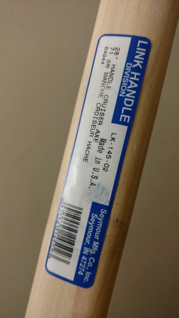

One of my favorite features is that this axe was designed with a larger cruiser eye. Versus a specialized eye that would be more obscure.
I asked Craig Roost about the design, he wanted people to be able to buy handles for these axes 50 years from now without having to find some rare size handle.
I thought that was a really cool notion; the thought of a rusty old saddle axe head and someone in the future scoring a sweet vintage axe from 2017
This is a full size "cruiser" handle. In my area there is an abundance of crusier handles to buy
Keep in mind though, a cruiser handle is too long for the Saddle axe so it will need to be cut down.
I would not go beyond 24",
Even then, The sweet spot would be 19"

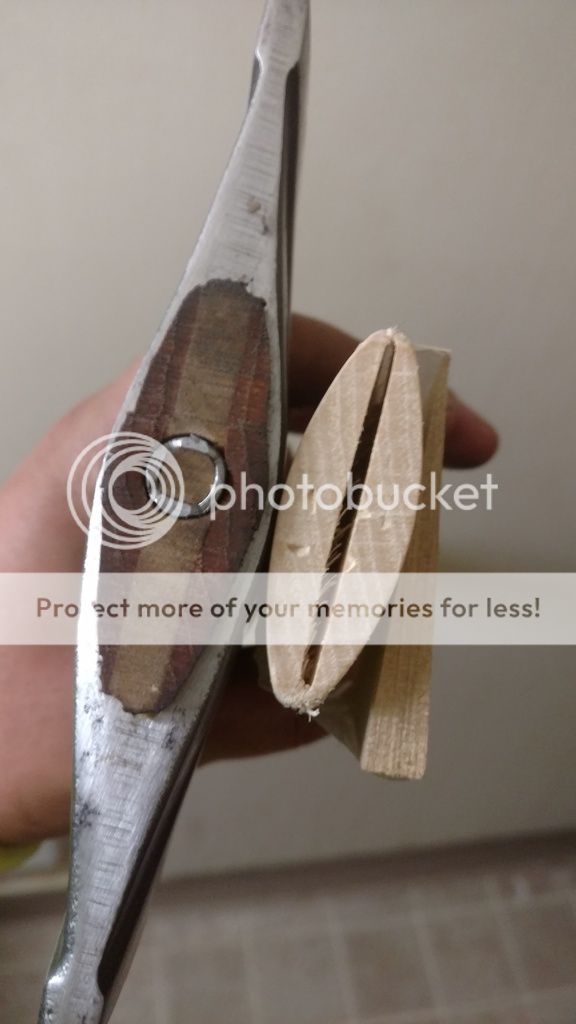

So the choice for ridges was because you think that it prevents bit to poll movement of the head on the handle and gives a longer lasting hang?
I think it does help... heads with short eyes like this or even Hudson Bays are often found to have handle movement... just re-hanging a small axe or hatchet with eye ridges tells you that you best get it started straight or the ridges are going to fight you getting it re-adjusted during the hang.... also by allowing the handle to be proud of the the head allows the mushrooming to help with head retention...
Peace, Rooster

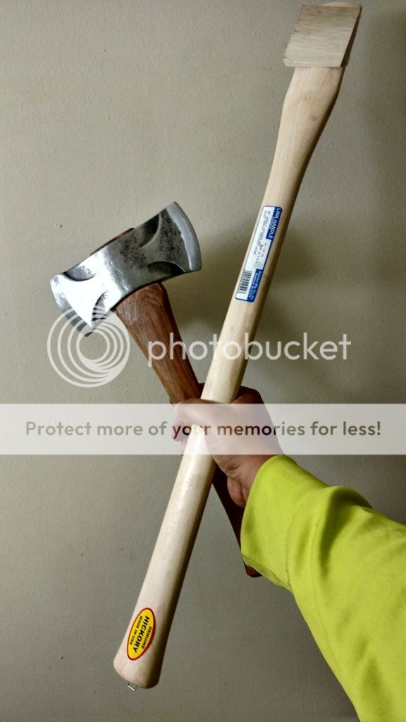

Why do you think a full size cruser handle is too long? Just curious. I am an oddball but I have little use for an axe shorter than a boys axe. That includes strapped to a pack. I am personally looking at that handle and head and screaming DO IT!
Im with you on the proud. I use proud with the wedge recessed as a retention method. Plus it looks cool. I have seen a rather lengthy thread on hudson bay handle movement/loosening. I think using the tool beyond its intended use/abuse may play a role, but if it is happening non the less It would seem ridges may offer a solution. Thank you for the response.
The bits on are not long enough and it's not heavy enough to maximize a 28" handle.
In the past, I tried a boys axe head on a 36" handle. It didn't work well, this would be the same, which is why I recommend 19" for this one. But it's nice to have 14" for the ultra portability.
