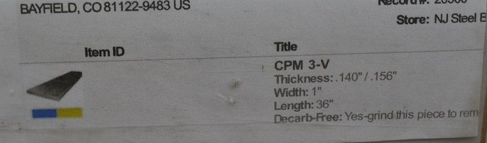

The steel has shipped! It went out Thursday from New Jersey so 12' of CPM3V should be here soon! I had the steel surface ground from the supplier to remove decarb... sometimes it takes them a few days to get to it but is well worth the wait.

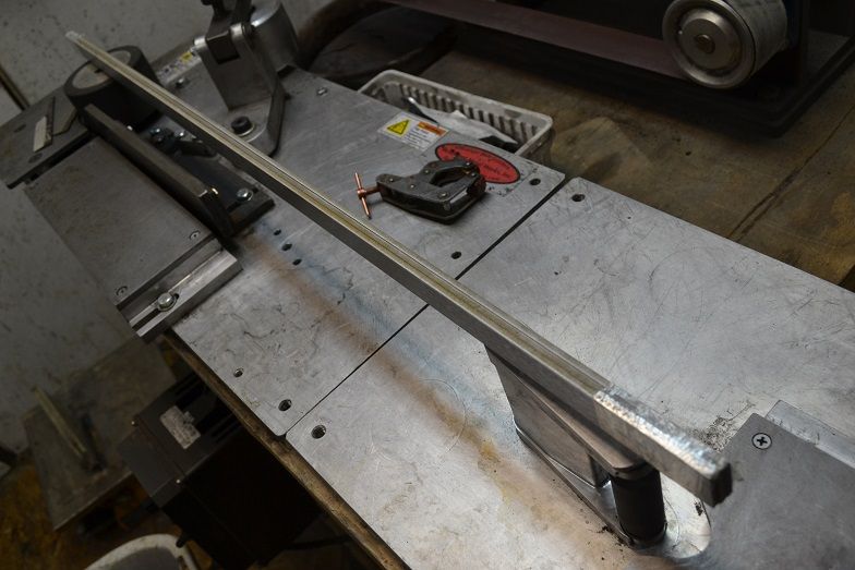

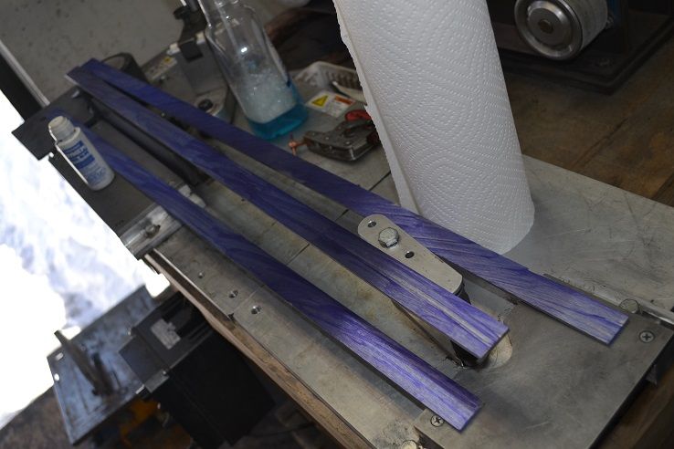

I straightened the bars a bit and now it is time to unwrap them...
I cleaned up the steel and applied some Dykem. The Dykem is the blue stuff and will help me see my scribe lines later.

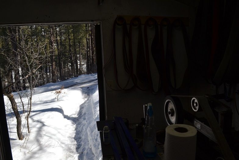

Door open... the Dykem is stinky!

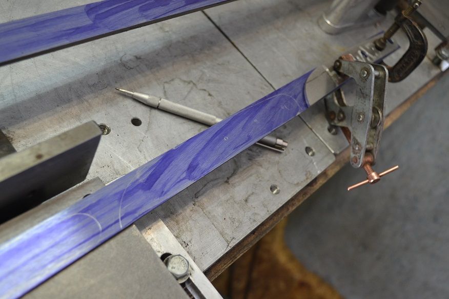

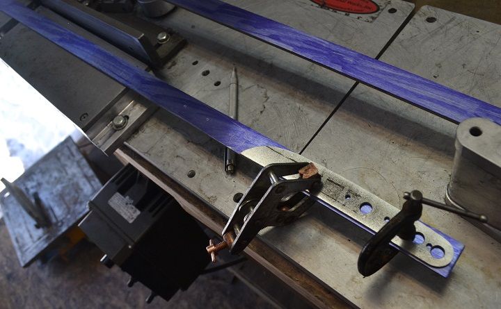

This is why I made the template. Clamp and scribe in lines... I'll use my chop saw next to cut the bars up and start grinding to profile.
It's hard to show the scribe lines in a photo... this will help me keep each knife very accurate in profile.
