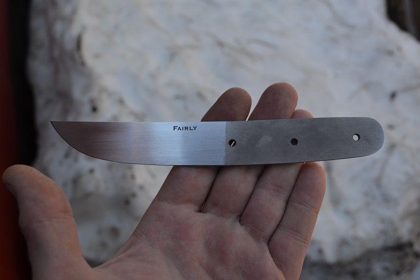

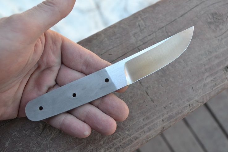

Thanks guys! These came out of quench nice and straight... I'm still working on heat treat but the tough part is over!
I've been grinding like crazy for the last two days and things are looking good!

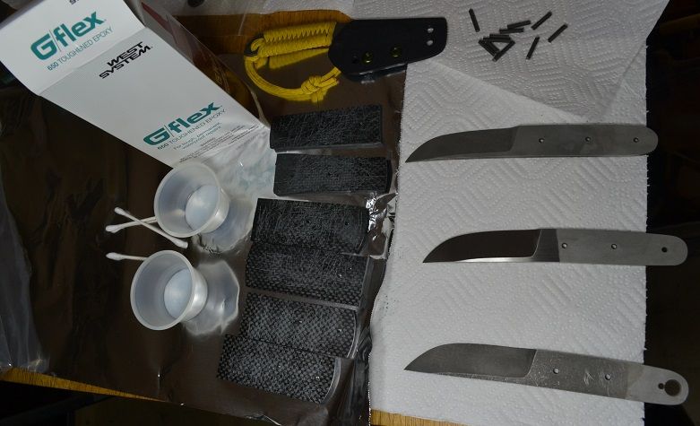

Time for glue up! 2 acid washed and one in satin.

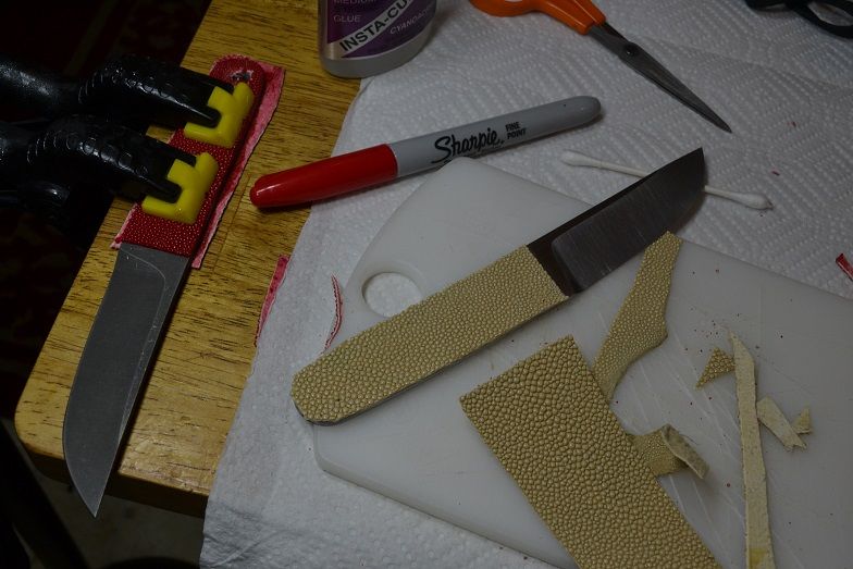

Prepping and glueing up stingray skin... this stuff is hard to cut! These get wraps next.
Just wrapped and almost ready for glue up. I have 9 knives curing now!

Thanks! This is LVA CF and looks very promising. I noticed it has at least twice as many carbon weave layers than most CF and seems incredibly dense for such lightweight material. Looks really nice too!

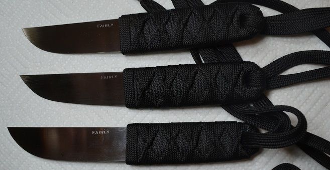

The rayskin is looking stellar and this the first time I have done cord on cord this way... I'm really happy with everything. Sheaths are next!
