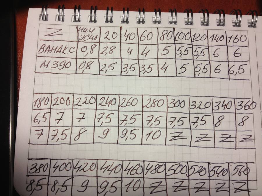

They have done a test of Vanax 75 vs. M390. The results page is in Russian, but the top of the two steels is Vanax, the bottom one in the table is M390. They measured the force (in kilograms) required to do the cut on a manilla rope after a set of cuts. They stopped cutting after the required cutting force reached 10 kilos. Results are below. As you can see, M390 pulled ahead initially (up to 120 cuts), but was outperformed by Vanax 75 in the long run:
Vanax 75, when it was in production, would yield higher wear resistance, but honestly wasn't different enough from Vanax 35 in performance to justify the continued production according to Bohler. Vanax 35 will perform somewhat similar to M390, in much the same way that Vanax 75 would, but it will be easier to sharpen than M390 is, and it will have higher corrosion resistance (though honestly M390 resists corrosion well enough for almost anything already). It will be about the same in terms of toughness and most other properties though, which is why I love Vanax as much as I do. Really want to get my hands on a Shirogorov in Vanax, but have not as of yet. I do have a few smaller custom fixed blades in Vanax though, that all perform insanely well! Always looking for more examples of this steel to try.
