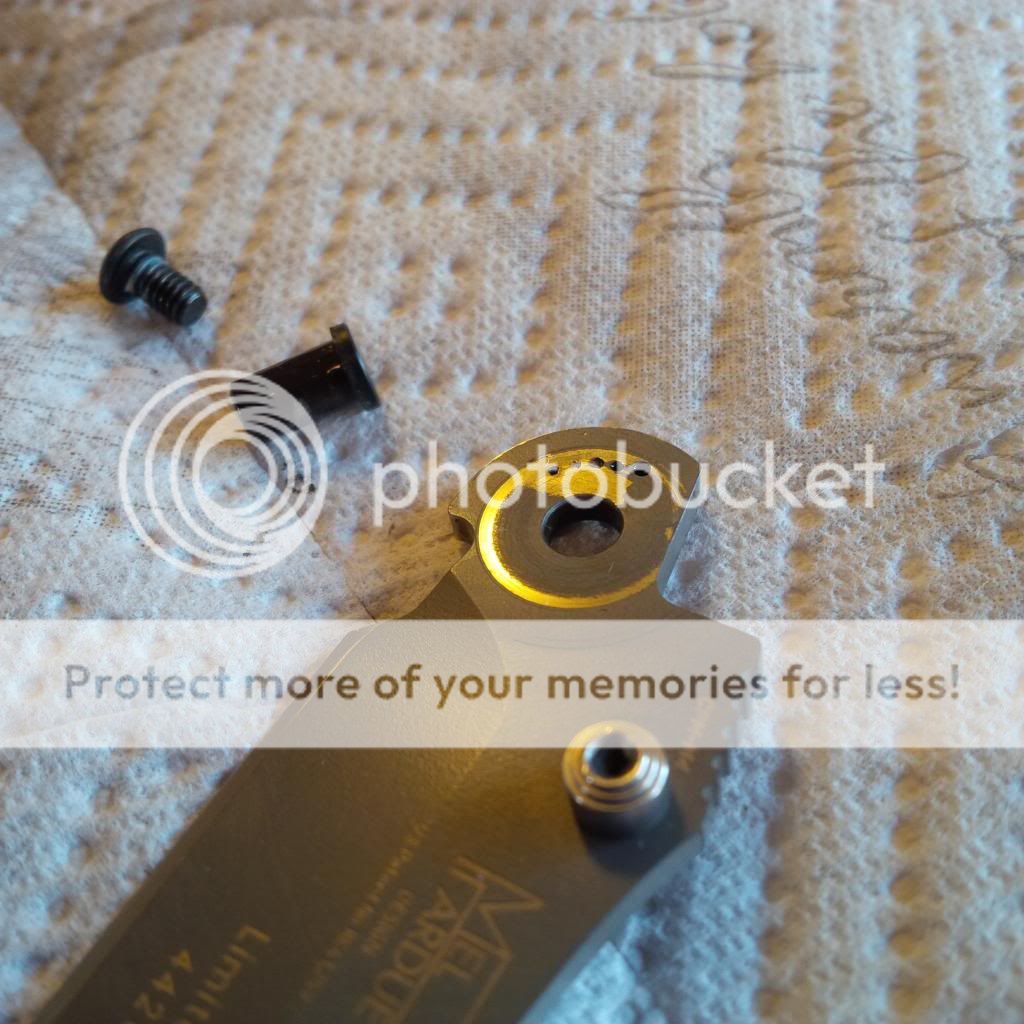

Cpm-m4 556 - Update - Broken Spring.
Yikes, sorry to hear that. Hope the fix isn't too complicated.
how about getting some new scales and change it all together? =)
Finally took it apart:

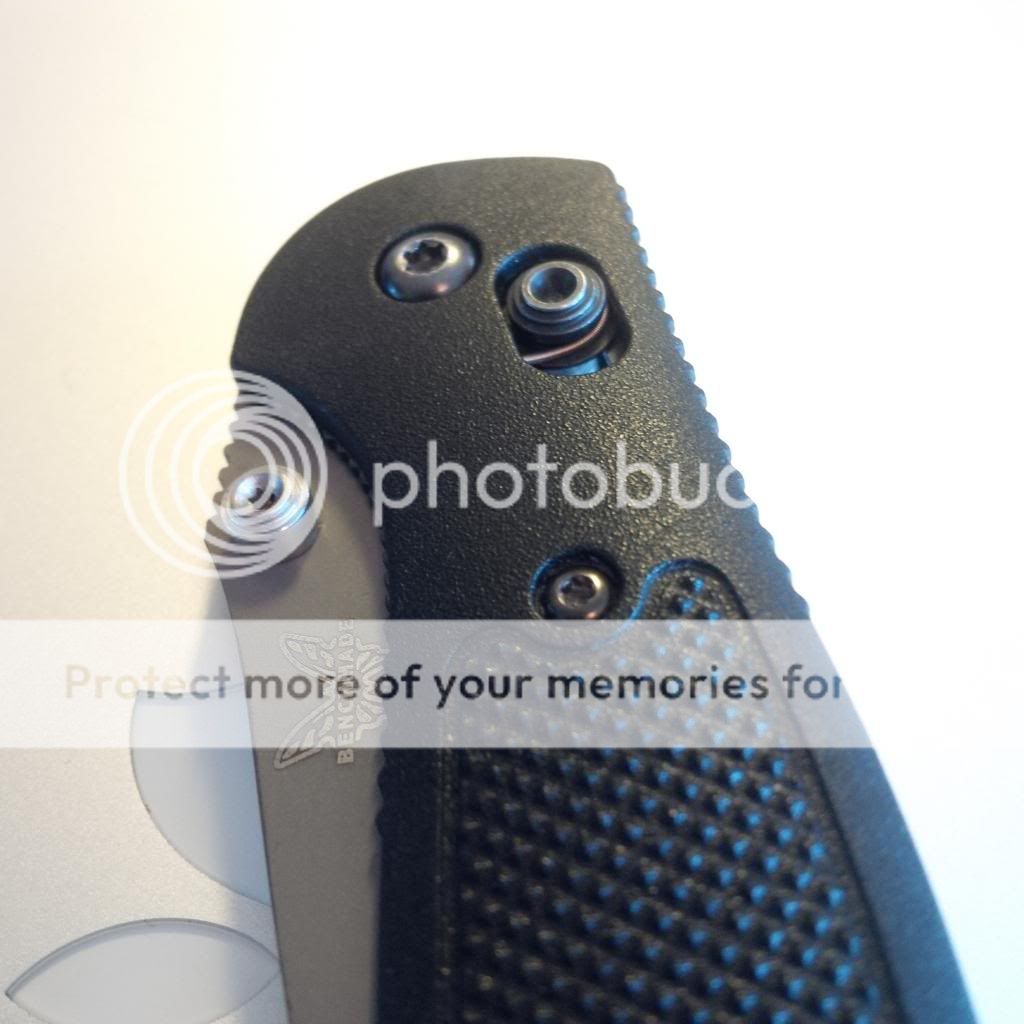

And new spring installed……
So I tried guitar strings. It works but its lame compared to the original springs.
Kevin
I don't know Rev. It's larger than the original spring. It's the biggest that would fit in the slot of the lock bar. Larger fit into the hole of the scale but not the lock bar.
The larger had equal spring but would not fit.
Kevin.
Btw, guitar string just isn't the same spring steel.
