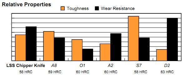

CPM-M4 is $25 - $30/lb from Crucible. 3V is a couple of dollars/lb less (I just bought some of each from Scott in Dallas). The A8 Modified "Chipper Knife Steel" that a lot of folks claim is Infi is from LaTrobe:
http://www.latrobesteel.com/assets/documents/datasheets/LSS_Chipper.pdf
If you get a quote from them, could you let me know? 3V has radically better toughness than A8 or A8 modified, but it would certainly be an interesting comparison:

This is the very first time I see a graph where O1 is tougher than A2 at 60 HRC
sidenote
D2 at 63 HRC should have about 31 joule, S7 at 58 should have about 160 joule, so the bar must be 5 times larger than the one of D2 ?

regarding the above chart... where would steels like M4, 5160 and say 440c stack up (joule wise that is)?
